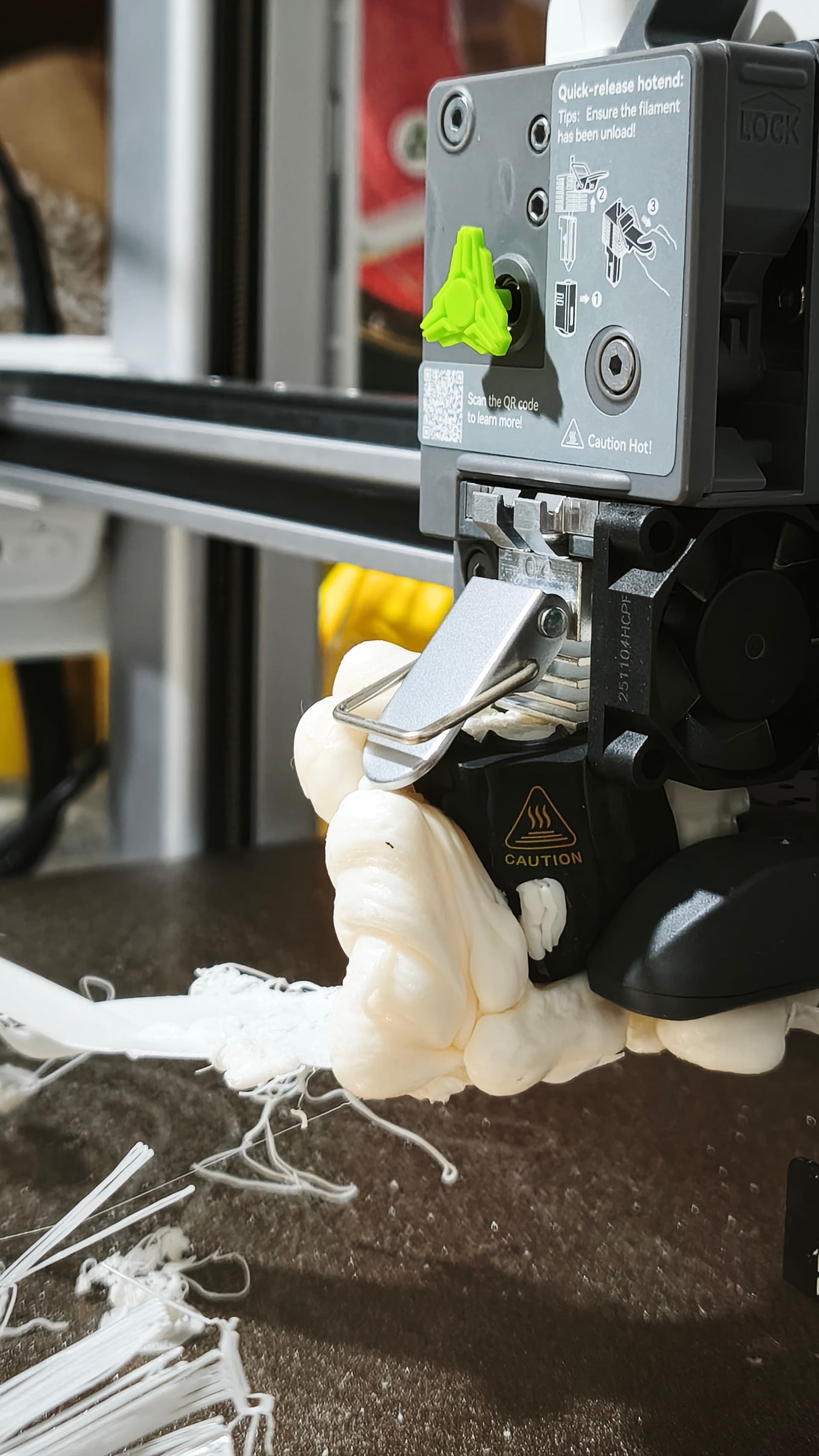

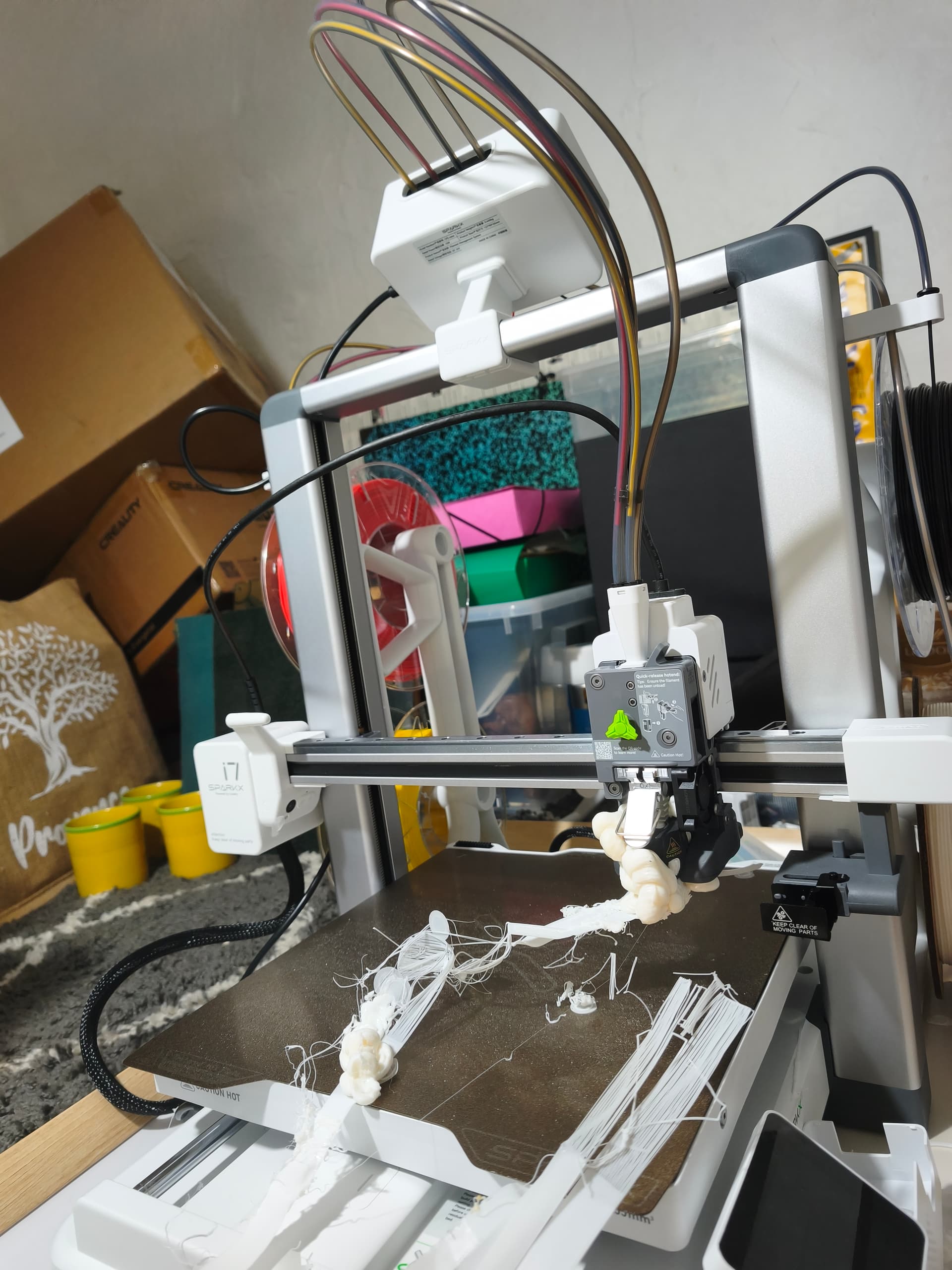

I am a new user from France of the very nice Sparkx I7 and I just had the following BIG problem yesterday.
I launched quite a big print and I had to leave and the following occured and here is what I discovered when I came back home :
The print came away from the build plate and the problem wasn’t detected at all, so the extrusion continued until it completely covered the extruder head.
This is a real disaster – what should I do?
Thanks in advance, kind regards,
Charly
First of all, I am so sorry about what happened to you; it’s a total nightmare. The first thing to do is avoid using brute force. Look for YouTube videos on how to remove a buildup of plastic (a “blob”) from the 3D printer; you’ll see that you need a heat gun, you have to heat the nozzle to around 280°C, and you need to be patient. Once you’ve managed to clean the printer without breaking anything, you’ll need to follow my tutorial, as Pritca mentioned. Your bed leveling map (bed mesh) is very poor; that’s why the printer can’t print onto the build plate. The surface has serious irregularities, and the prints aren’t adhering to the bed because of that unevenness.
Thanks so much for the quick answers.
I’m starting to watch videos about removing a blob, I prepared my heat gun.
When hopefully all is removed, I’ll go through your tutorial.
I’m still asking myself the question did this happen because I didn’t use glue until now? I printed already quite a lot of stuff and it all went perfect.

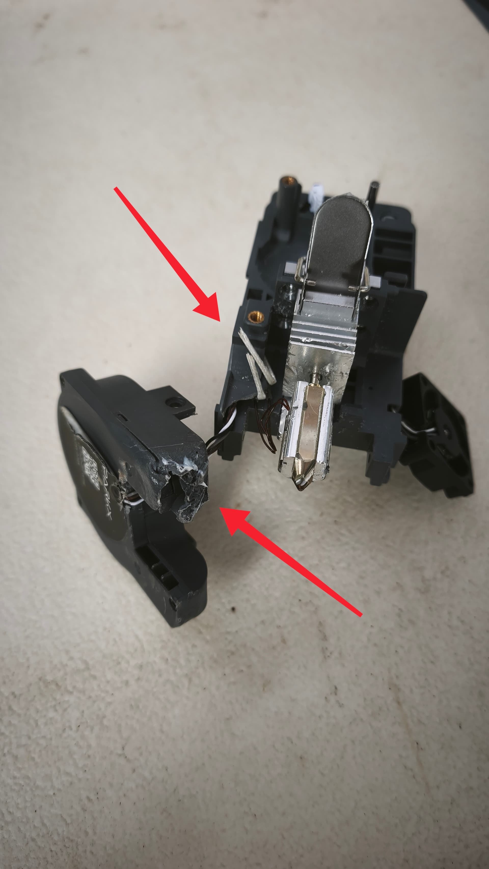

Hello,
After a few days’ holiday, I was finally able to have a go at my ‘blob’.
I used a few different methods. First, the Dremel to trim off small bits, a pair of wire cutters to remove the excess, and of course the heat gun to loosen the bits stuck to the extruder.
Unfortunately, despite all the care I tried to take, I’ve got two wires cut, and part of the fan has melted! (see the red arrows).
As for the fan, I don’t think there’s a problem, as the cavities aren’t affected.
But do you think it’s easy and worth the effort to re-solder the wires?
There’s also the extruder, which I can’t seem to remove. Do I need to heat it with a heat gun?
Thanks in advance, Charly
PS: I’m still wondering why my SparkX I7, which is supposed to detect this sort of problem with its camera and AI, didn’t spot a thing!!! Wouldn’t Creality consider this a fault?
It’s a sorry sight; the fan and heater most likely need replacing. I think you can order spare parts from China—try contacting tech support and explaining that the AI ​​spaghetti-recognition system failed (and that this isn’t the first time it’s happened). Send them links to the relevant forum threads; they might send the parts under warranty—it’s worth a try.
