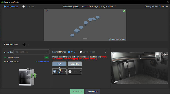

How do I tell the CFS it's holding my Support material?
In the print profile I’ve told it to use reel 2 which has support material in it. ON the CFS I’ve selected
Brand: Generic
Type: PLA
Name: Generic Support for PLA.
When I try to print, I get this;
What am I doing wrong?

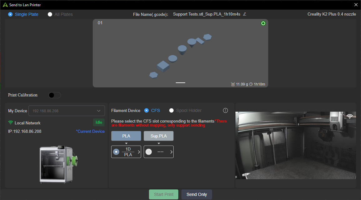

I think I’ve found the problem. I edited the filament profile and there’s a box to tick simply called “Filament for Supports”. It’s this that creates the “Sup. PLA” category on the print, but there’s no way to tell the CFS that it’s holding “Sup. PLA”; apparently telling it “Generic Support for PLA” isn’t quite clear enough for it…!
I unchecked the box and it let me use the second reel, the one I’d selected for support interface material in the Creality Print “Support” settings.
Just have to hope it switches to it in the right place!

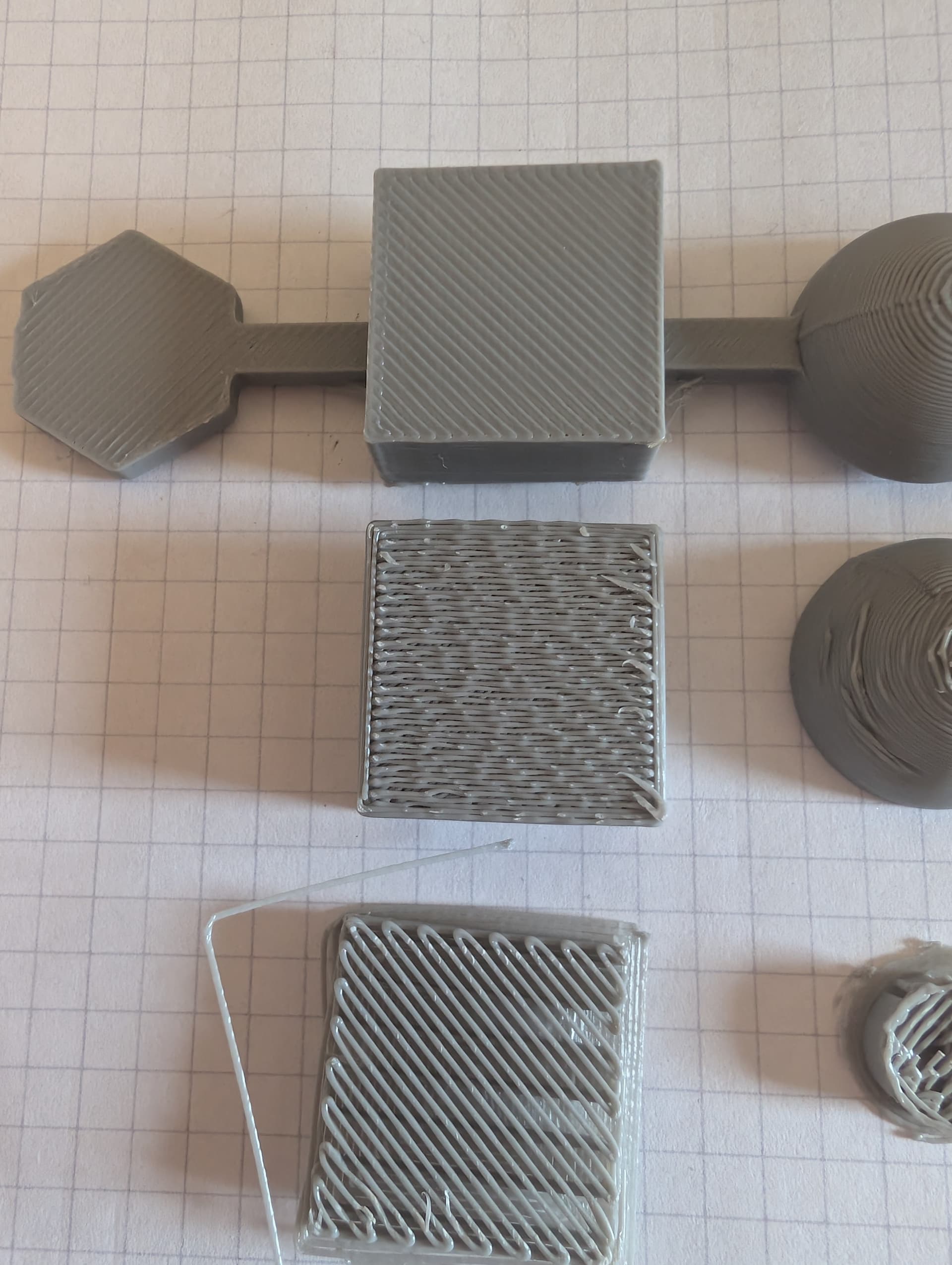

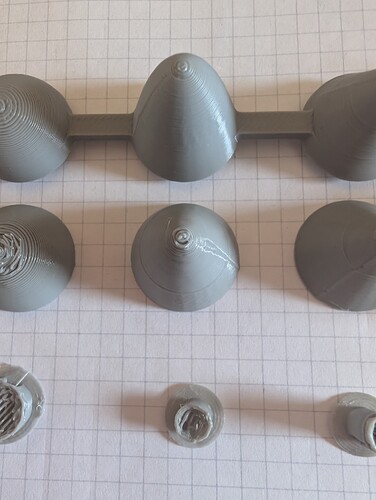

I believe the trick with support is to recognise it’s not about speed or ease of removal. It is entirely about quality. We have in the support material a “bond breaker”. Supported surfaces are notoriously rubbish compared to upper surfaces because you need that “distance to roof” and “distance to floor” setting to be greater than zero when using the same material to stop it sticking to itself.
With the non-bonding support, you don’t. You can be flush with the underside of your model. You do not need it to be low density either…because it won’t stick.
High distance and low density both lead to undersides that are worse (much worse) than the same shape printed as the top.

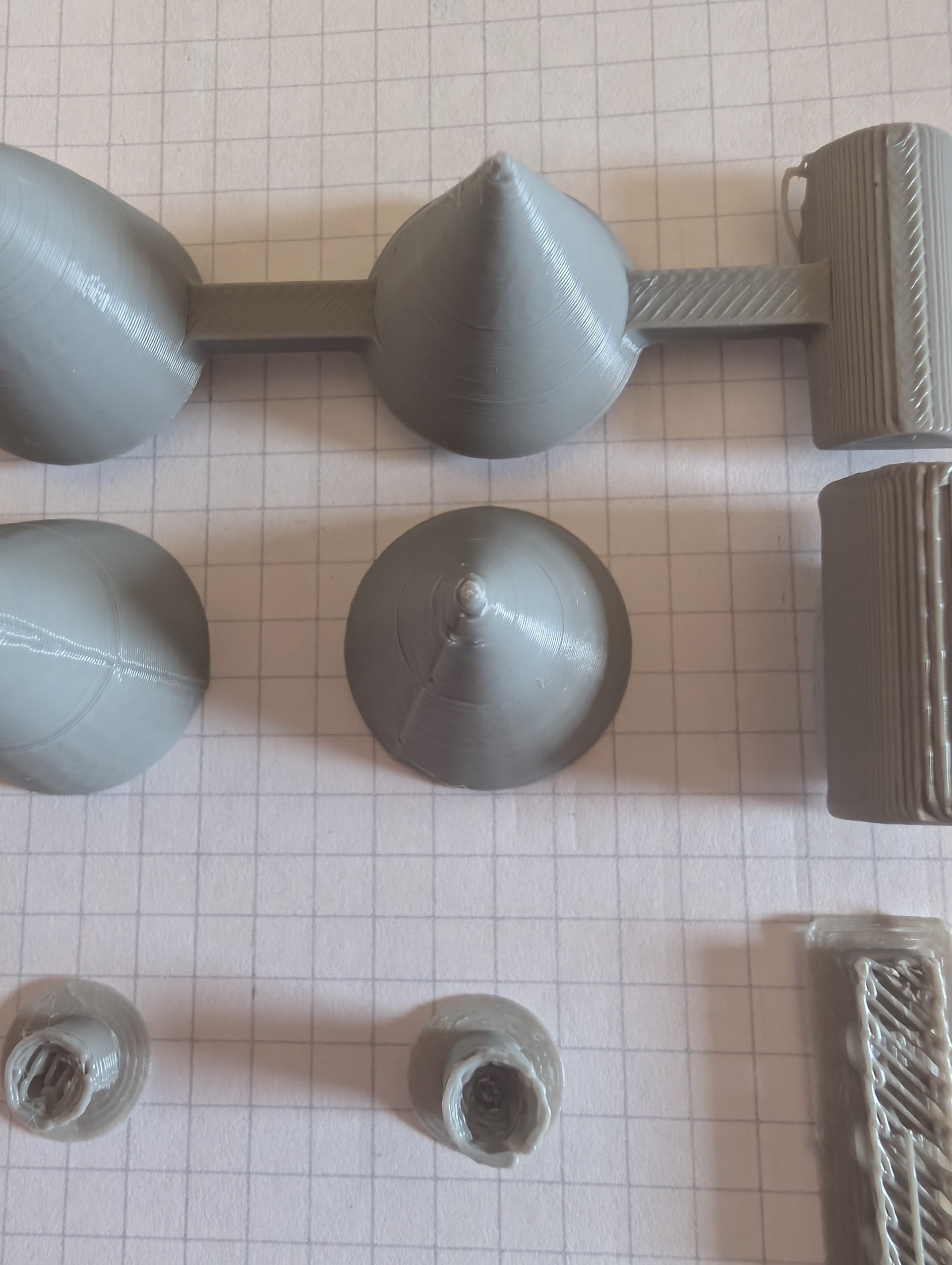

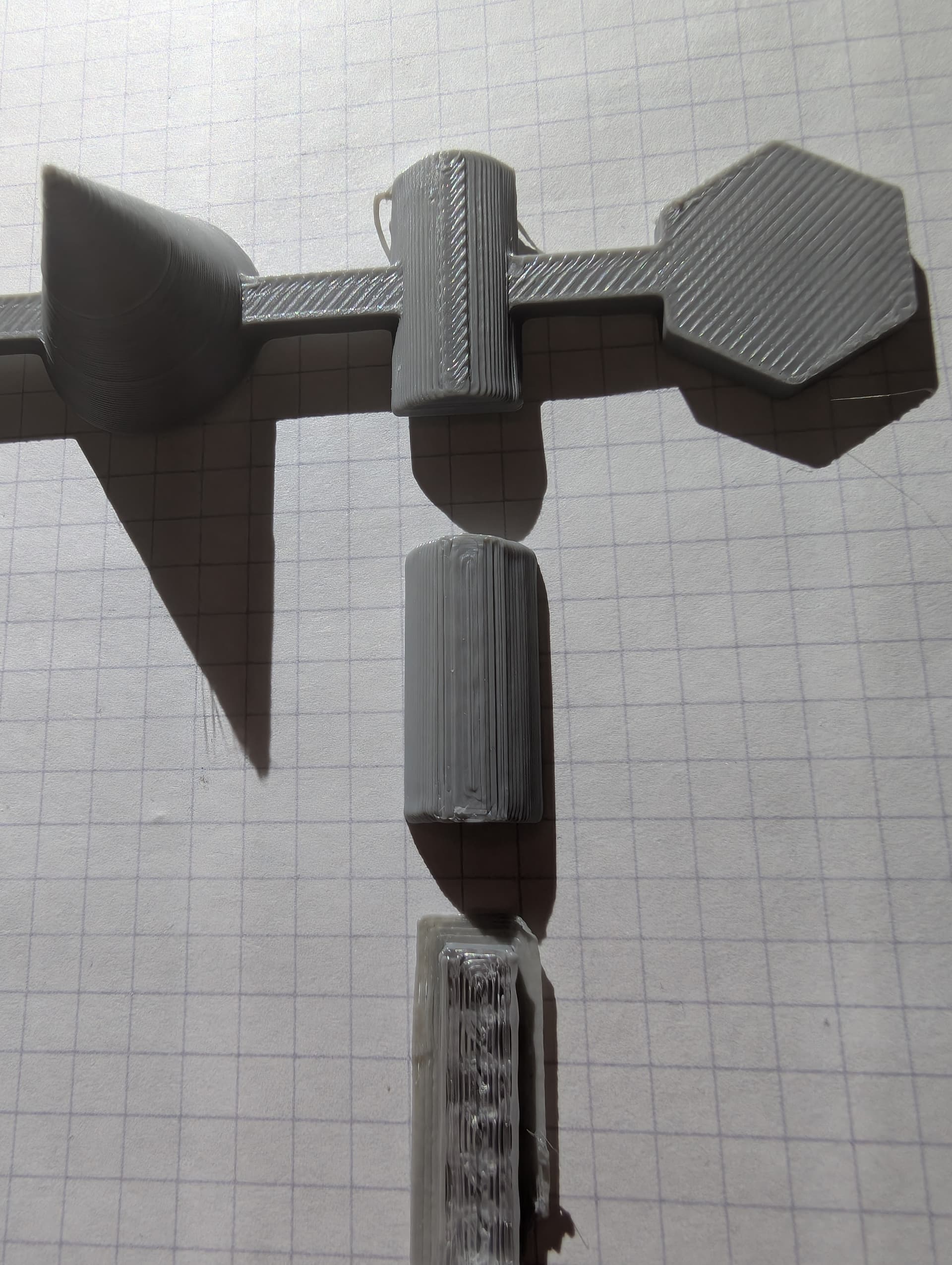

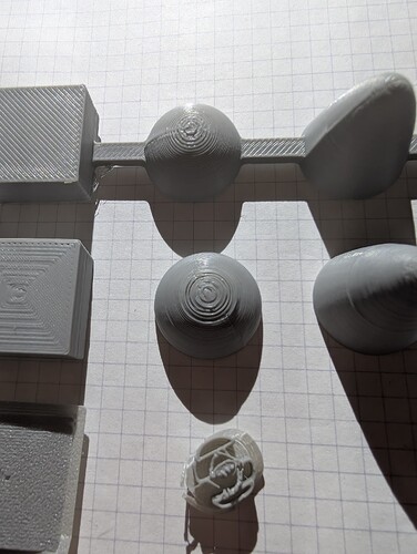

I’ve already done some testing, just to illustrate the point.

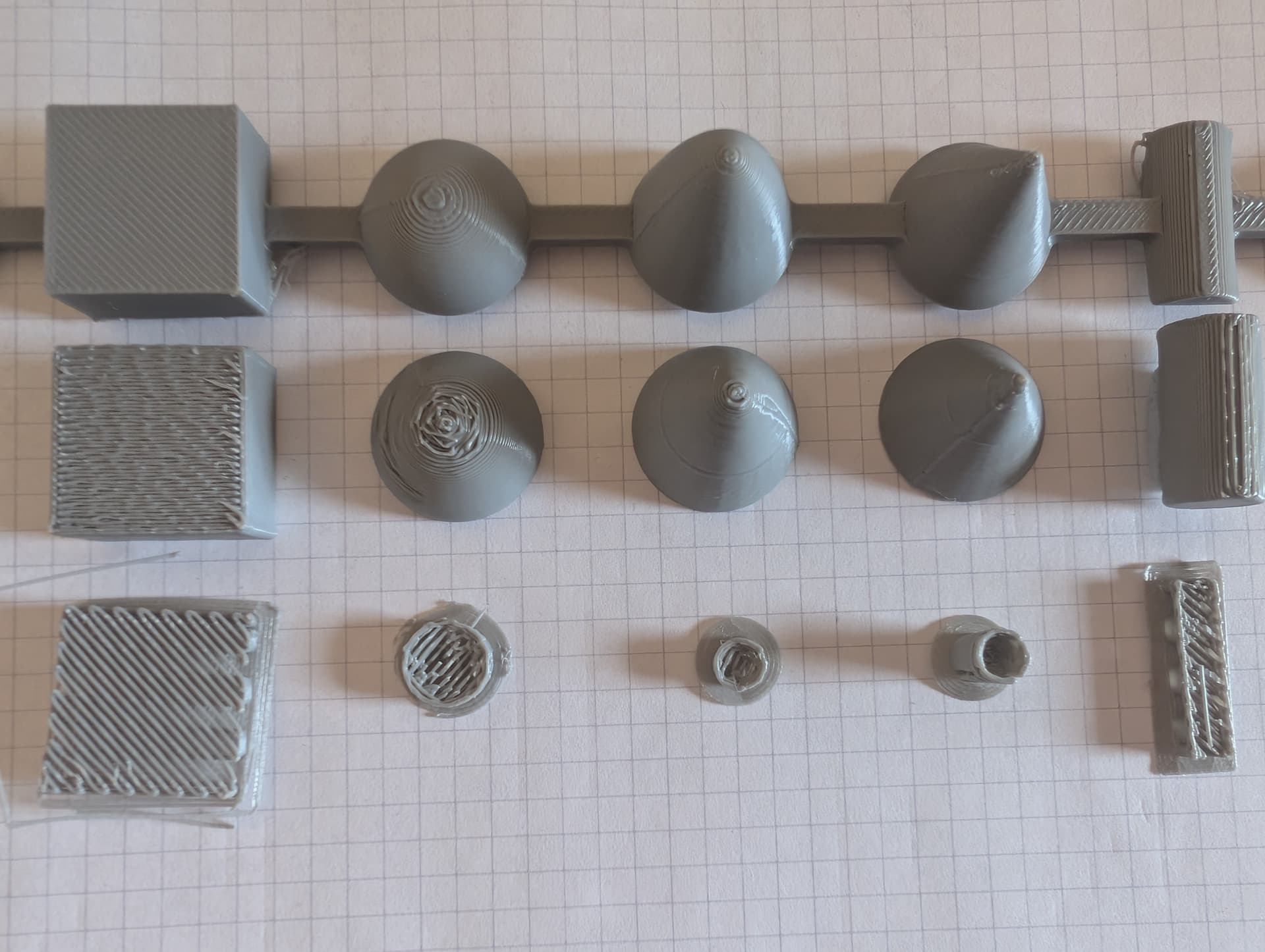

Here are five shapes (ignoring the hexagons at the end, they’re just placeholders)

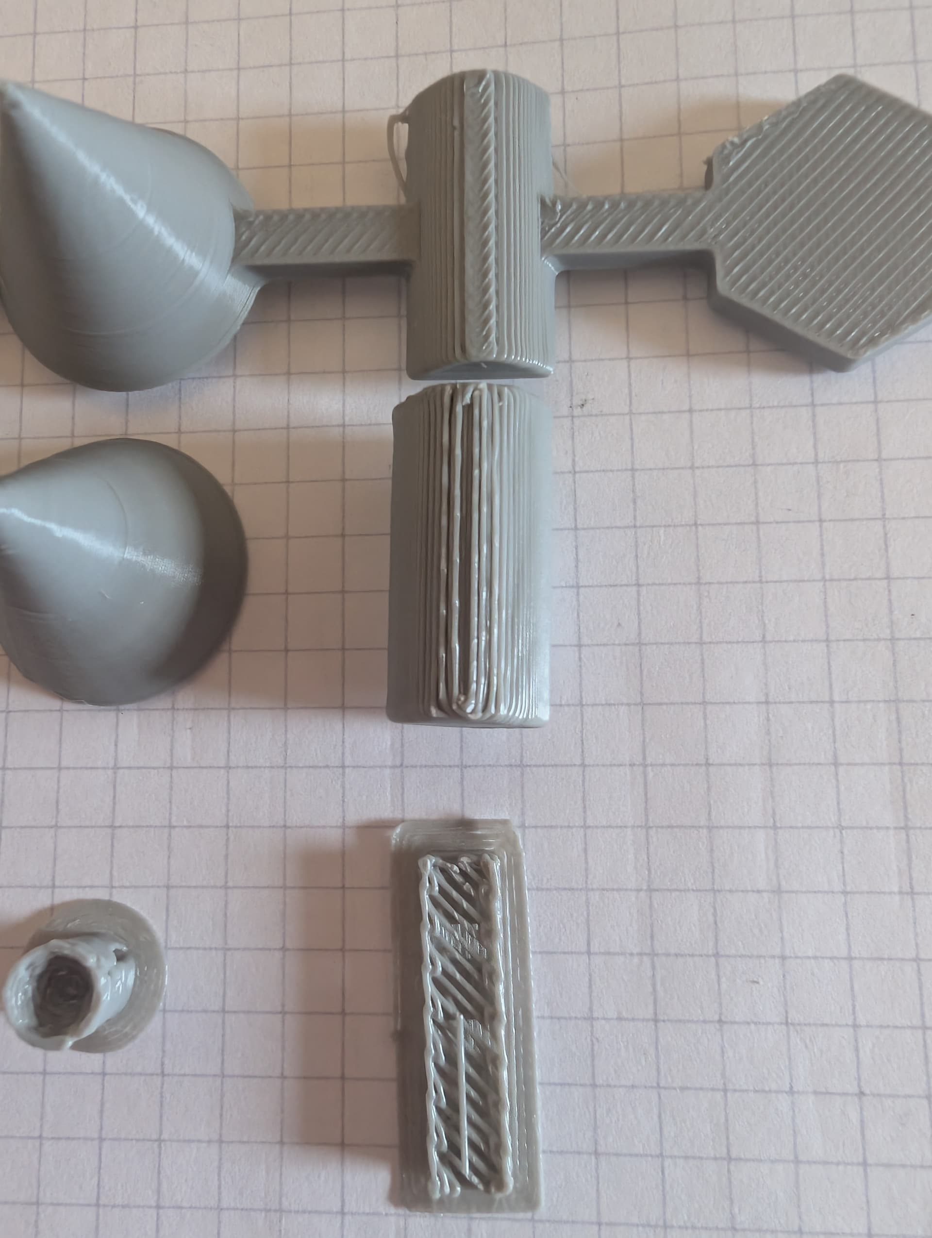

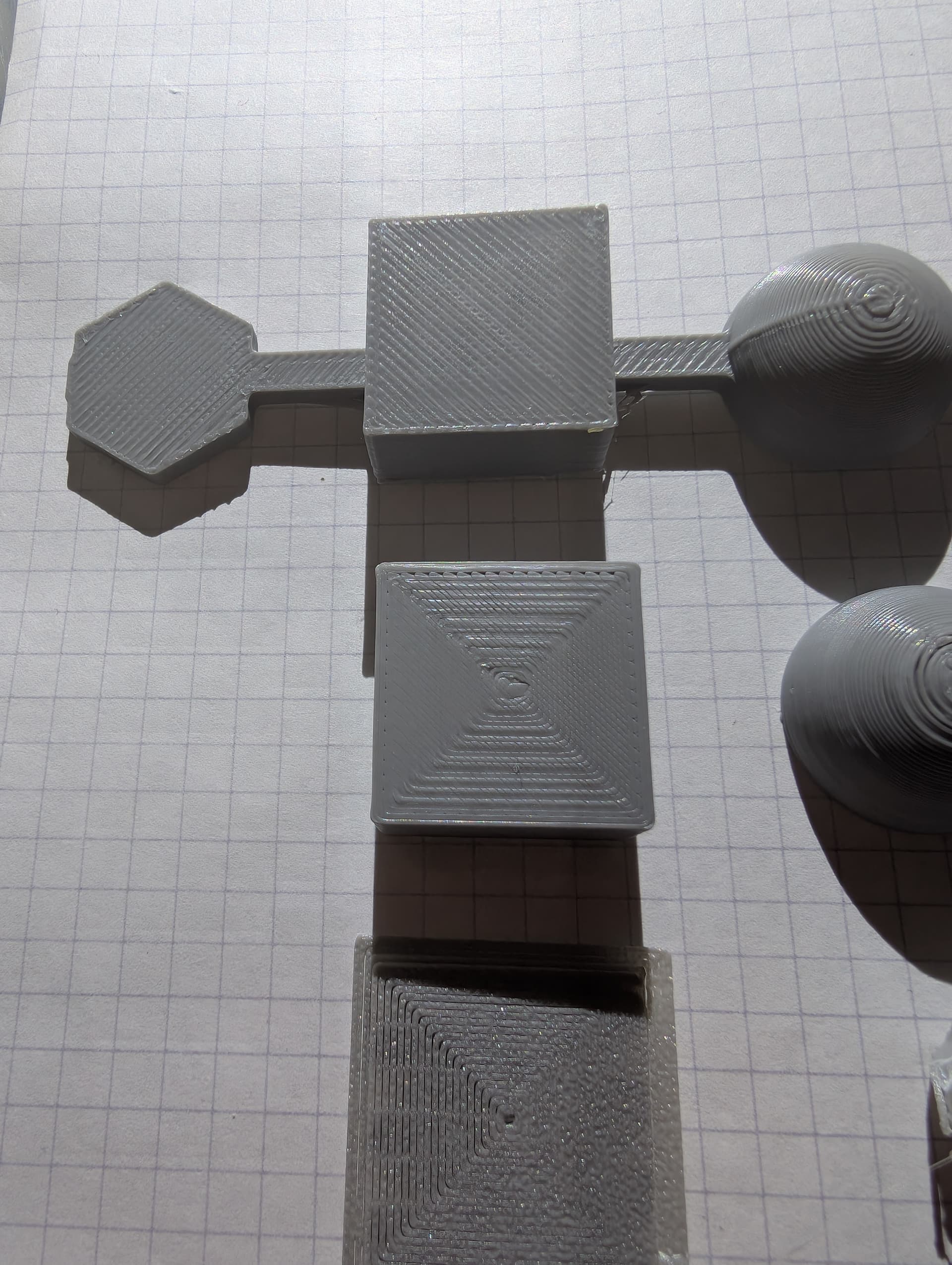

Now what if we flip them upside down and float them 3mm off the ground…?

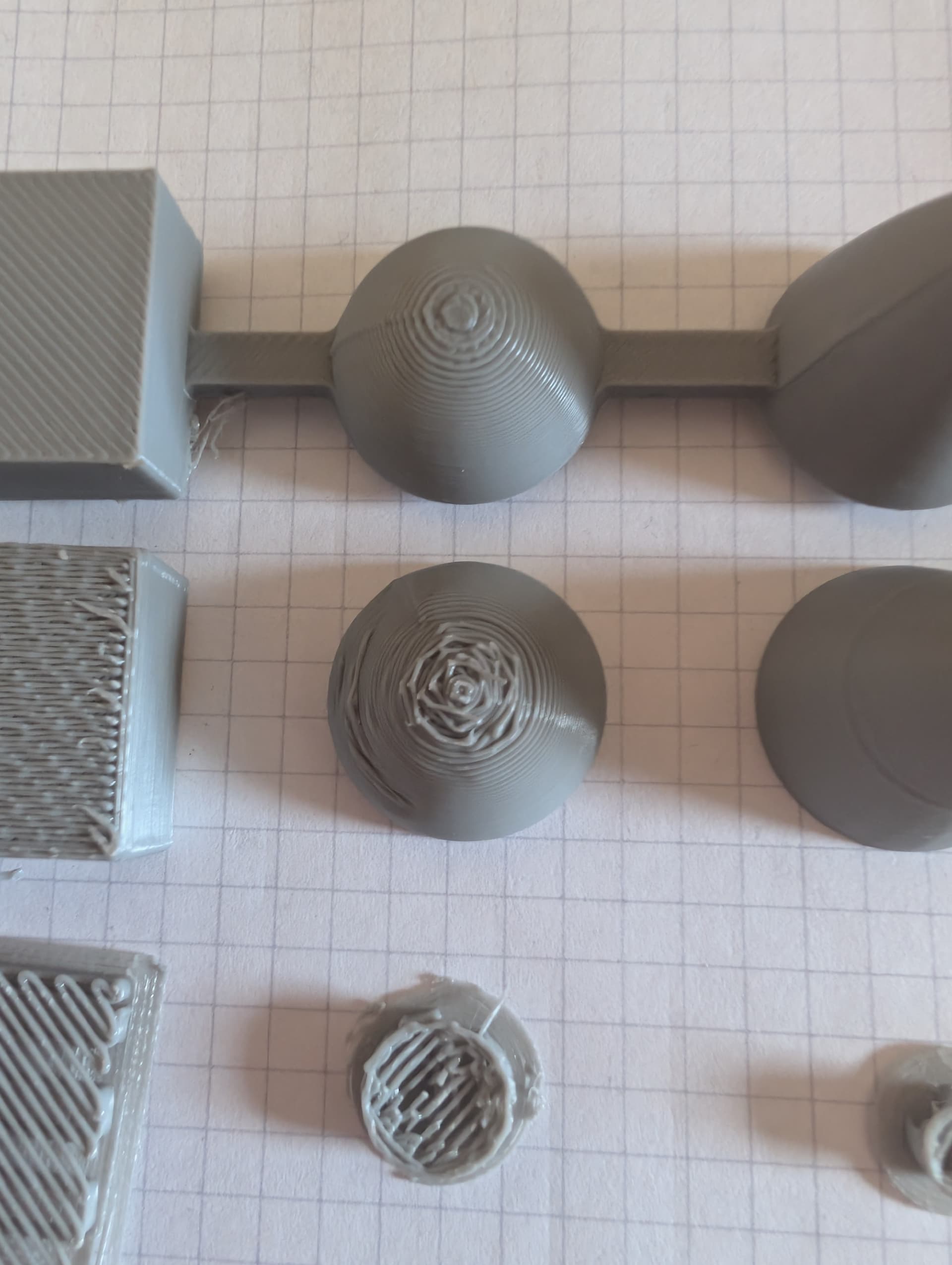

Compare the undersides (particularly of the square, hemisphere and cylinder, later to become a half-cylinder to stop it rolling about!) to the topsides.

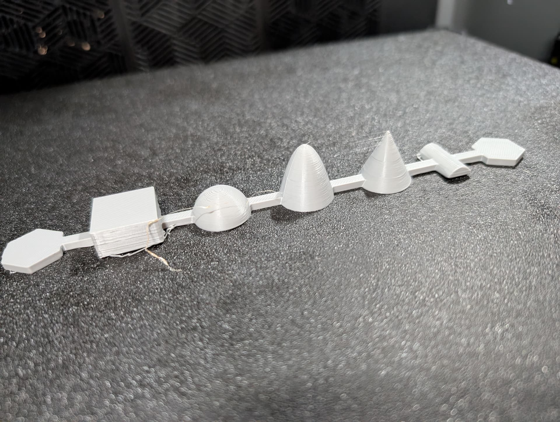

You have to admit, it’s less than great…but look what I managed to achieve on my first try with the support filament, using it just as the “roof and floor” layer, and leaving the rest of the support as PLA…

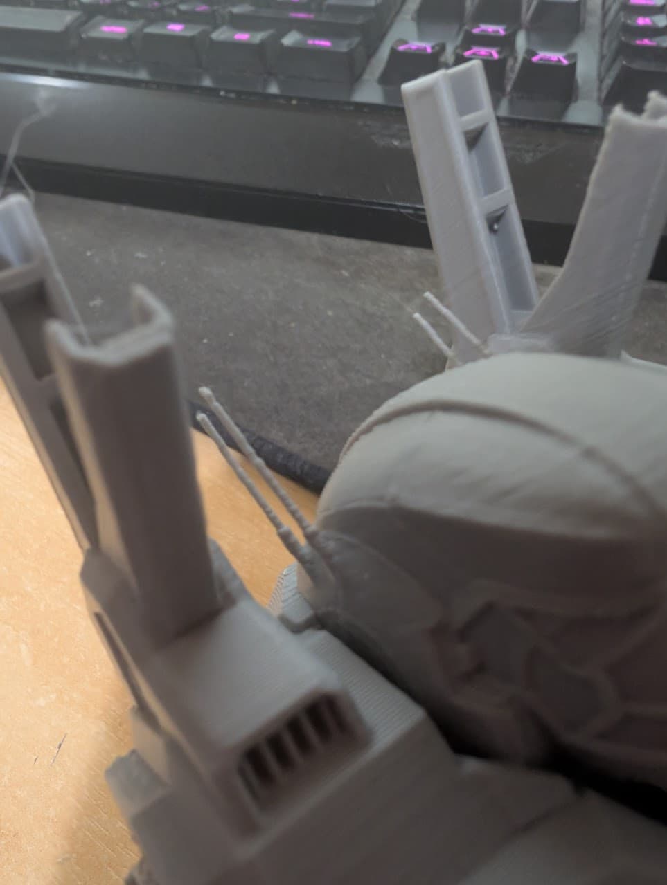

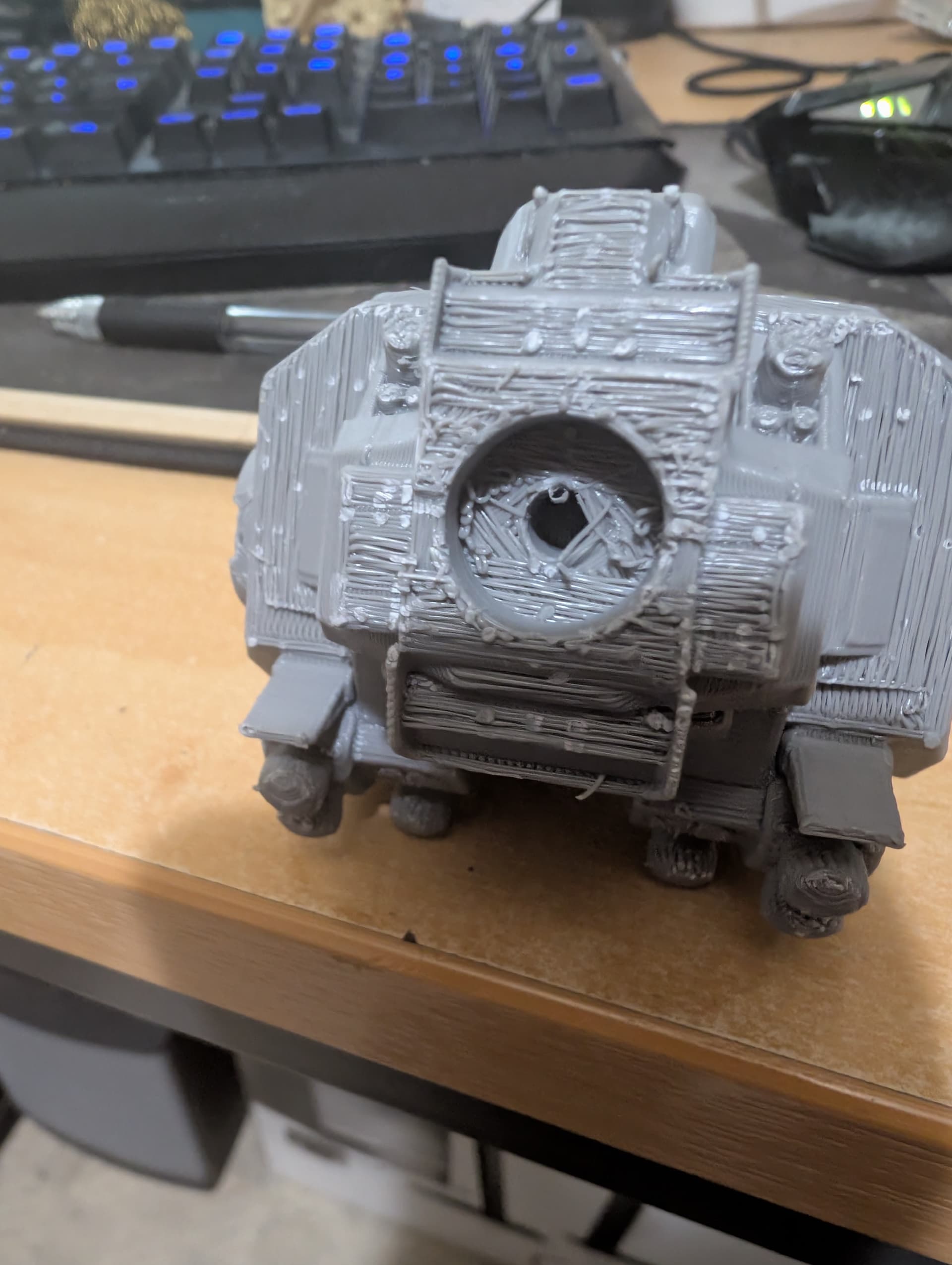

I think the square and cylinder are particularly impressive, however the square is “easy mode” for normal support. It’s surfaces with dips, bumps, protrusions and cavities that are the nightmare. But; confidence boosted by the initial tests, I’ve put one of my Mechs on to print, using 5 layers of the support as the roof and floor material. Let’s hope I can get better than this;
I’ll know in 8h41m…like I said, it’s not about speed!

Oh believe me I’ve tried, but with these mechs there’s always something that suffers from being “down below”; I mean look how fine those antennae are - I’m seriously impressed they printed at all;
Butt seems ugly…no, wait…
Butt seams ugly…argh that’s worse
But…seams? Ugly! (got there in the end!)

However…on these Mech’s the detail is so fine that the support actually seems to surround it…a bit like Giger’s Alien encases human beings in the movie…and the adhesion reduction still wasn’t enough to avoid damage.

Did you ever figure this out? It seems to only work if you uncheck the “Filament for Supports” box, correct? Does it not work under any other circumstances with this box checked?
This works straight out of the box with Bambu Studio and Orca Slicer when using Bambu printers. I’m surprised that it’s taking this much work to tell Creative Clouid to use slot X for support filament, and there’s not much information about this as well.
Curious to know if you got this resolved.
What I have seen here https://www.youtube.com/watch?v=Nd3qzX4hiJg&t=3s I would not buy this material!
I had the same issue today. What I did is press “send Only” then I started the print from the printer and was able to select the slot that has the support for pla material assigned to it. Could not start it automatically, but manually seemed to have no issue. Will update this if I find issues otherwise.

Also, I found that I did not need to go to the printer to manually start the print, once it was sent to the machine, I was able to start the print from within the Device tab of the slicer and accessing the file on the local storage, where you right click and choose Start Printing.
I did not have this kind of issue with this material, it all came off cleanly. I think there was maybe 1 small piece that I had to use the very tip of my exacto to pry up and the underside of the print where it touched this material was perfectly smooth.
