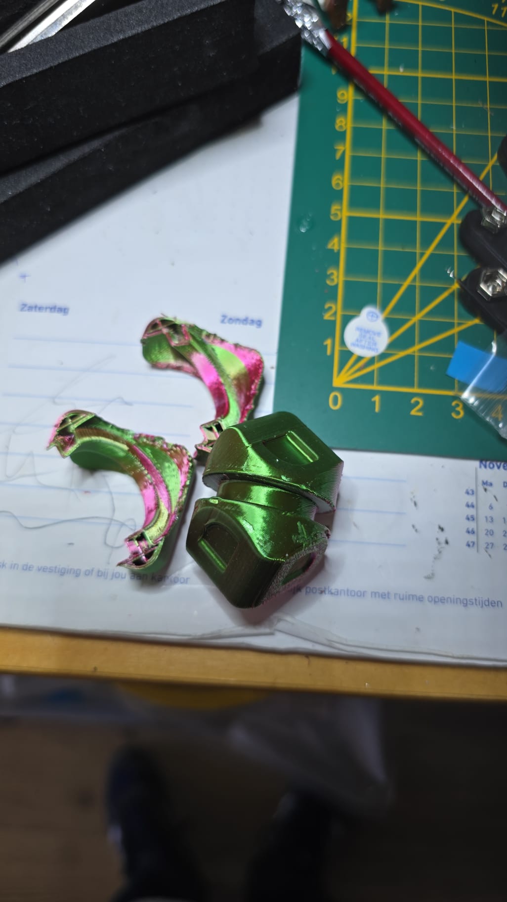

After some weeks of testing etc with my K2 plus CFS I am trying to print a cube.
See Spin Cube (Print in Place) by liminil - Thingiverse
When reading some documentation and trial and error sessions still nothing works. It is not spinning.

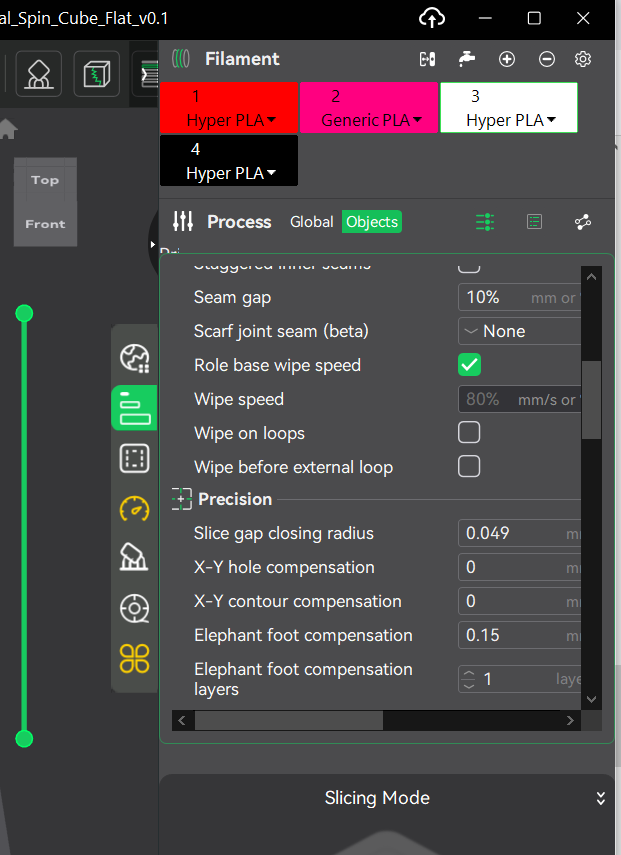

The answer to my project seems to be a “PIP construction” or enabling “assembling” .
But I can not find these options within Creality Print v6.
Can anybody help me, or give any hints.

Its print in place so for me as long as the print wall order is correct it should just work. For my mind it should outside/inside not inside/outside, the latter makes a bigger part. Turn off all brims/rafts/supports, it should just work. Can you show what is going wrong in a picture?

See also attached the pictures.

ABS I just got a cube. PLA inside/outside wall order I got a cube. PLA outside/inside (as I surmised) spinny toy, little tight but moves. May have been better with an aux fan at 100% in addition to the other cooling fans, except I don’t have any of those on the Ender5plus that I printed it on.
I remind this model which I tested on my Qidi printer (I still have aside the K2) and id tid not work out of the box.
The reason is that even side/auxiliary fans cannot cool the internal overhangs because of the model is blocking the airflow with the bigger external part.
I had luck by setting X-Y-contour compensation to -0.1 mm (On Qidi I used -0.15) and using my standard 0.2mm profile with Elegoo RAPID PLA easily!

Tried it on my Qidi Xplus3, 0.12 layers…another cube, not toy. This cube is quite a fun challenge.

Download the stl file, and open the file in creality print 6.x
Then execute Hollowing → 1.0 mm
And I changed:
“X-Y contour conpensation” to -0.2mm
And printed again → the cube was (little bit of force) turning around. It works!
