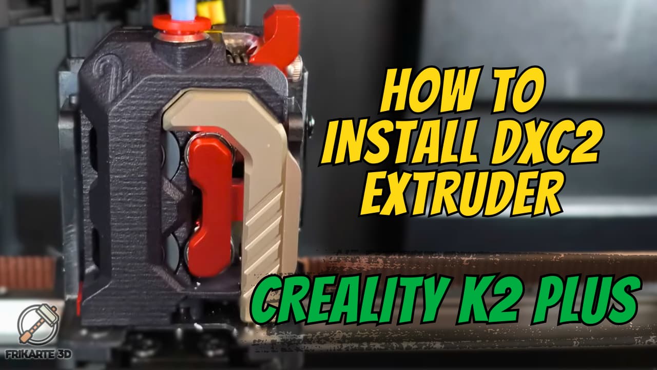

How to Install the DXC2 Extruder on Creality K2 Plus
:high_voltage: Magnetic upgrade for the Creality K2 Plus!
I installed the Phaetus DXC2 Extruder by D3vil Design — dual gear drive + magnetic quick release for instant maintenance :wrench:
Full step-by-step install + real print tests (Benchy, multicolor & more) :eyes:
:movie_camera: Watch now: https://youtu.be/c5oLDxXethg

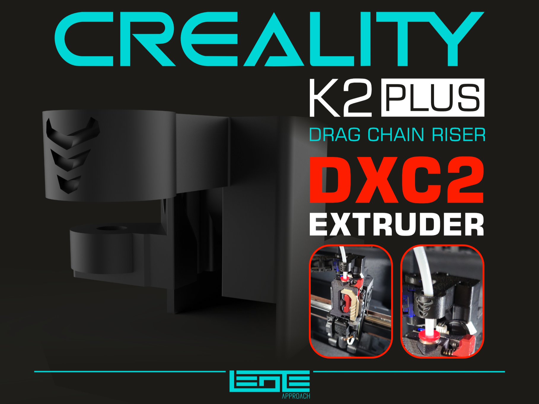

Where can we download the cable/chain/tube riser stl you referred to in the video? I just ordered an extruder but can’t find the riser for the DXC2 anywhere. Will the DXC1 riser I found work with the DXC2 and Creality K2Plus?
The one I show in the video is not available yet until the designer publicly uploads it.
You can get the one made by Phaetus without tube guide, I’m working on a remix of that one to include it: GitHub - Phaetus/DXC-2-Extruder · GitHub They also have a hotend cover.
I don’t know which riser are you talking about but the K1 chain is different from the K2 series so I don’t think so.

Does the DXC2 use the std cutter from creality as I cannot see an offering from Phaetus ?
They look compatible but Phaetus cutter looks like you can simply replace the blade rather than just replacing the whole assembly.

I can confirm you cannot use Creality cutter with this setup. It will give you an error saying the cutter is missing

I compared both and the size is identical, so I assume you can use Creality one on the DXC2
