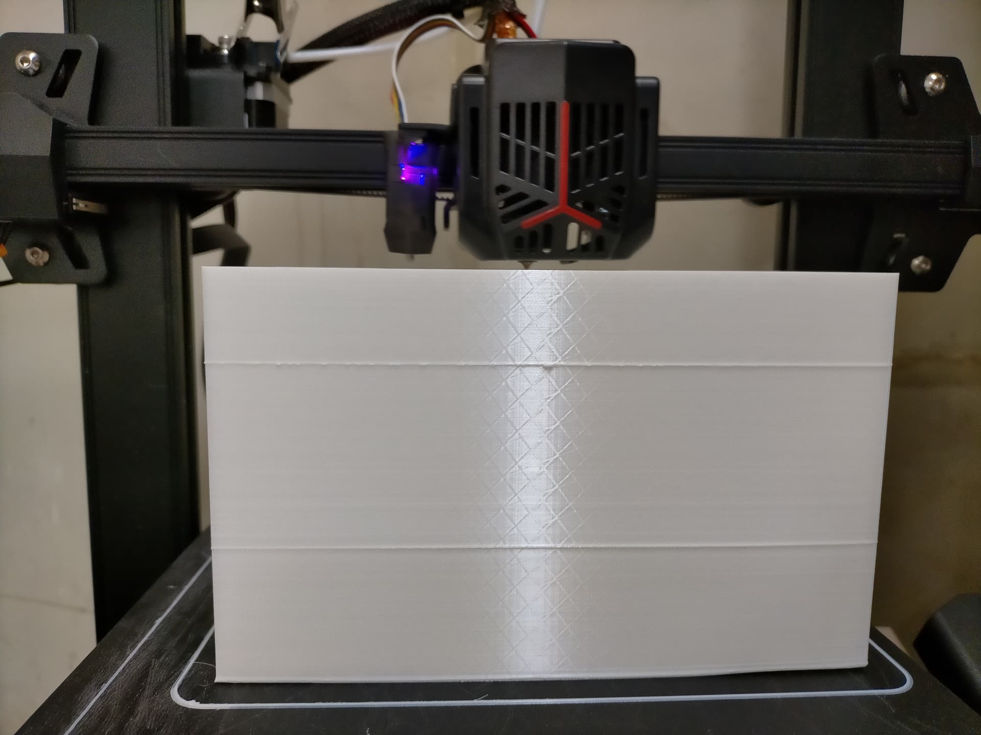

Hi @Nikoli.
Before Collet Clips arrived, I fixed it with paper clips and tried printing a large model for about 26 hours (for work). But because the printer is located at the company, due to concerns about fire and explosion, I am forced to use the pause function. However, it appears horizontal lines as shown (In Photo)
. I tried two ways: Pause > turn off the power and Pause > reduce the temperature, turn off the cooling fan and leave the power on.
Is this an insurmountable problem and can you give me some advice for printing things that take a long time?
Thanks a lot!
You will likely find that whats happening is while the printer is paused it will be turning off the heaters to the bed which in turn will cause the PLA filament/model to shrink slightly and sometimes partially detach from the bed as it cools off. As a result when you then resume the print the model may have distorted slightly causing print imperfections.
It could also be a case where the gantry is slightly loose and is descending the Z axis when paused. The printer will only keep the stepper motors locked for a short period of time before it will usually turn them off to prevent heat build up etc. If the gantry rollers are slightly loose you might find that the gantry is lowering itself slightly when the motors are off.
Thank you for your information. It seems like i won’t be able to print a large model without keeping the print bed, nozzle hot, and motor running throughout the printing process, even when using the pause function. I will try to redesign it into many small models so that it can be completed in 1 working day.
Also worth double checking the eccentric nuts on the sides of the gantry to make sure they are not too tight or too loose. You should be able to turn the pulley wheels with your fingers but still feel slight resistance.
