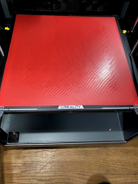

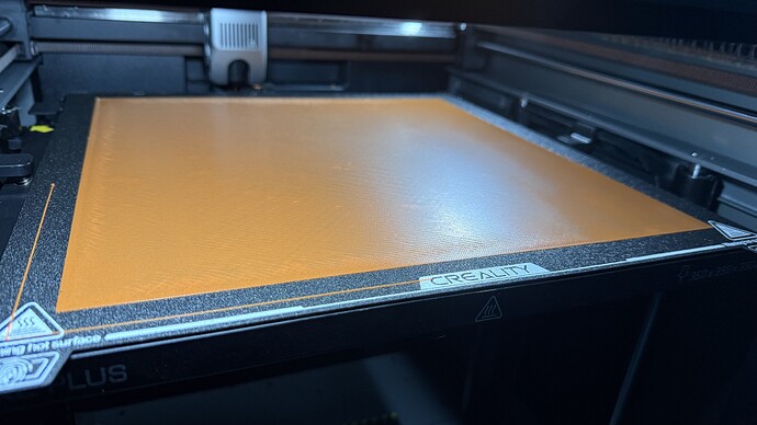

I’m trying to dial my bed in. Last calibration I ran after manually adjusting the four bed screws claims 0.3-ish deviation. That’s at the standard temps, as I’m currently testing with Creality Hyper PLA.

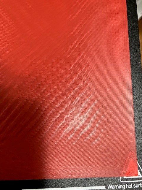

What I see, is that I get diagonal ripples or ridges (not certain how to describe them) when I do the full plate single layer print. I asked Creality support about this, posted some pics. Printer is less than a month old, and arrived without any obvious damage during shipping.
Here are a couple pics, you can see the ridges/ripples..

Check out extruder calibration in the wiki:
Thank you… I’ll check into that.
I ran the calibration last night. I think it helped, though hasn’t eliminated the issue completely.
I also saw improvement, but not elimination, of the diagonal “waves” when I ran the calibration a while back.
Thanks. I’ll continue to check into things.
