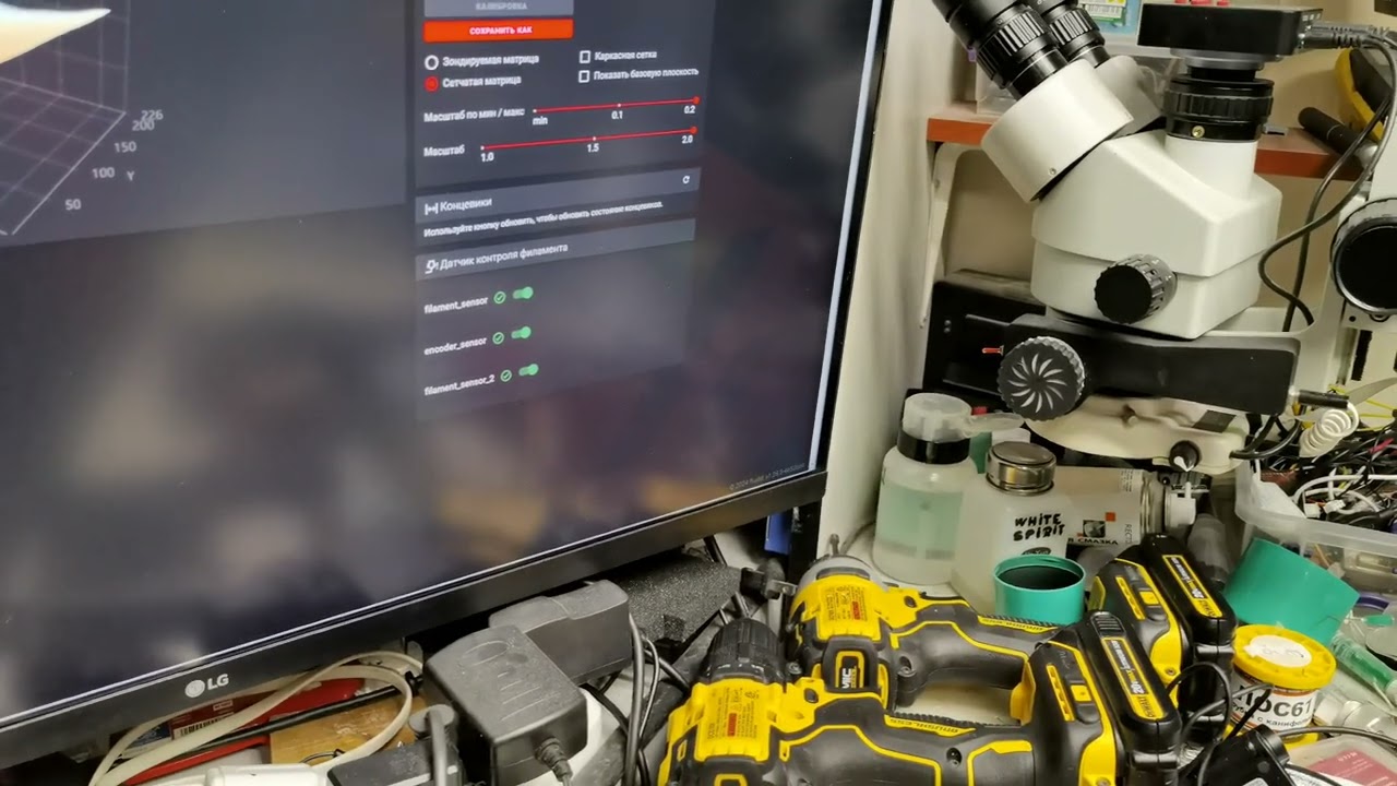

I am the author of this video). The output of the filament presence sensor must be connected to the PC15 pin (as on the old sensor), and the pulse output must be soldered, for example, to the PC7 pin on the board… I connected it like this. And here are my settings in printer_config
[filament_switch_sensor filament_sensor]
pause_on_runout: true
switch_pin: PC15
runout_gcode:
{% if printer.extruder.can_extrude|lower == ‘true’ %}
G91
G0 E30 F600
G90
{% endif %}
[filament_motion_sensor encoder_sensor]
switch_pin: PA7
detection_length: 12
extruder: extruder
runout_gcode:
G91
G0 E30 F600
G90
{% endif %}

it was a long time ago, I don’t remember. You need to find a free microcontroller pin on the bottom board according to the datasheet and connect two sensor signal pins to these pins. I connected them to the PC15 and PA7 pins

so I soldered a 3pin connector to PA1 ( the top one ) and PA7 ( the bottom one ) , but none of them worked for me. I think the board is missing the resistors. ( Signal was there, and so was ground and power , the sfs 2.0 did power up) , but I just got no response when inserting filament. Ended up making a cable and connecting the motion wire ( green ) to the original filament sensor on PC15 , and leaving my DXC connected to the tool head. The resistors that need to be solders are tiny. There is some explanation here - Creality K1-Series Btt SFS V2 Mount by anavrin72 | Download free STL model | Printables.com
