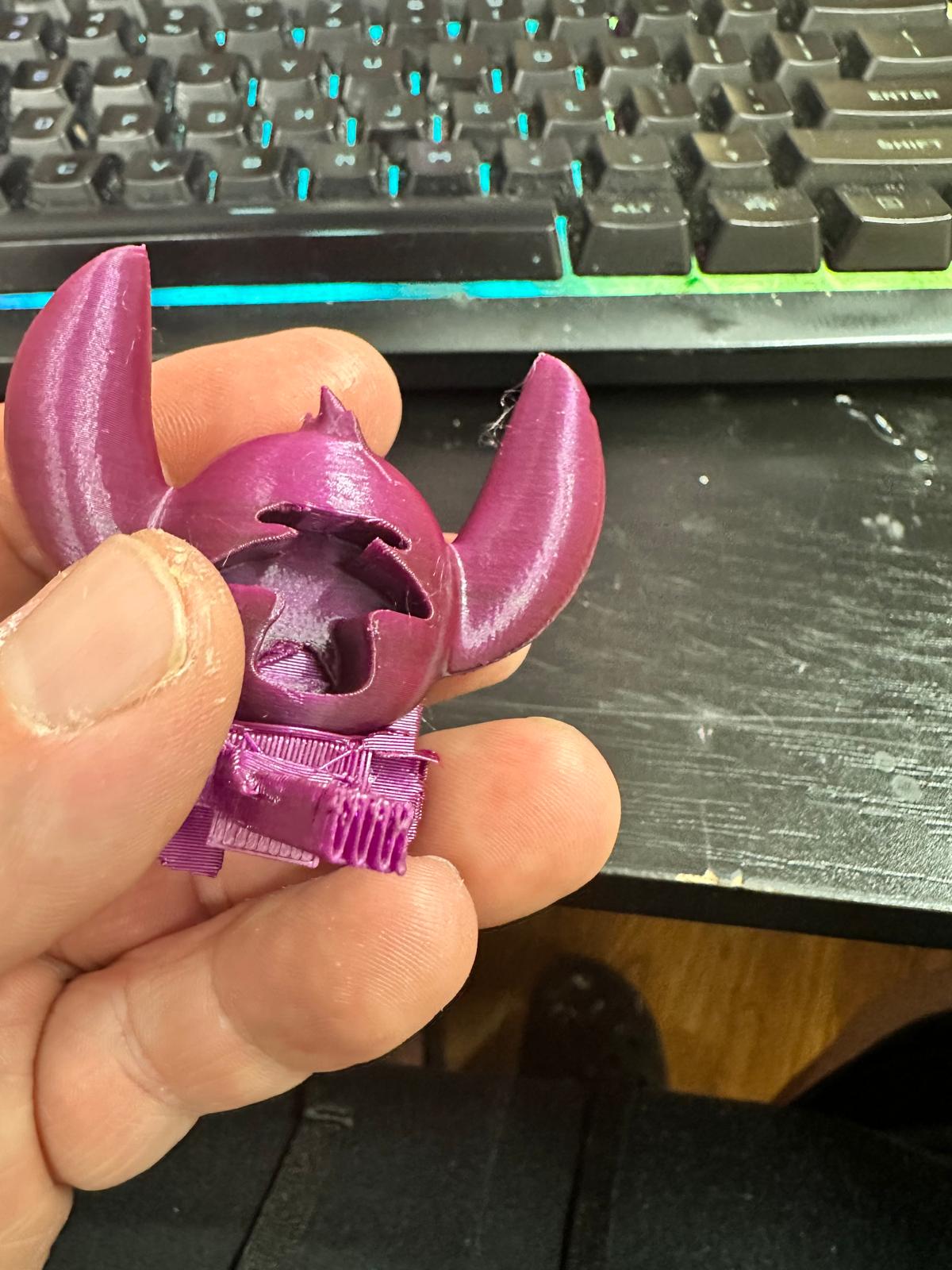

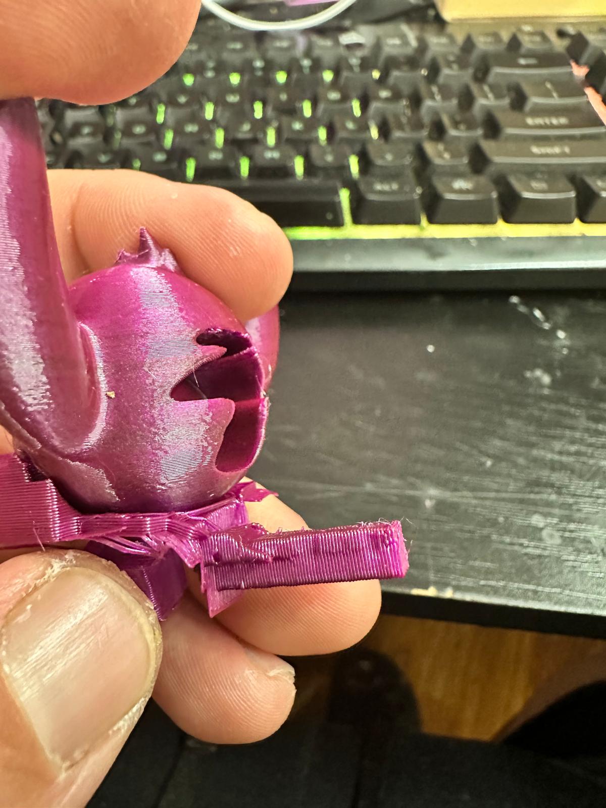

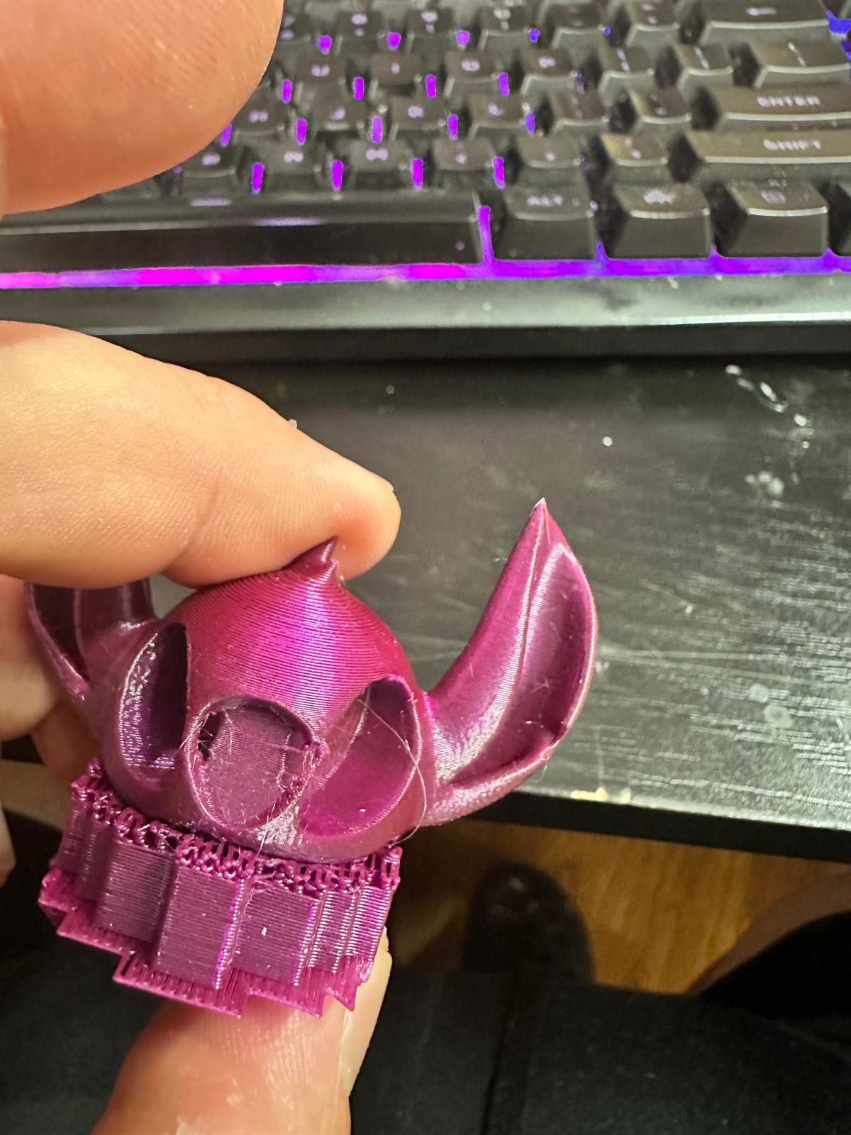

Is there a way to avoid this "support melt/burn"?
Print came out great, other than where the supports met and smudged the spot. I was curious if there is any way to reduce or avoid this? I used standard supports and was considering reprinting with slim trees instead.

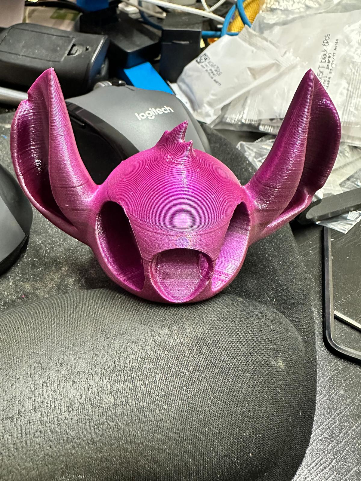

What filament type is it?
Not sure I would call that a very good fish even when there are no supports. Are you using freshly dried filament - the finish suggests a nozzle temperature or damp filament.

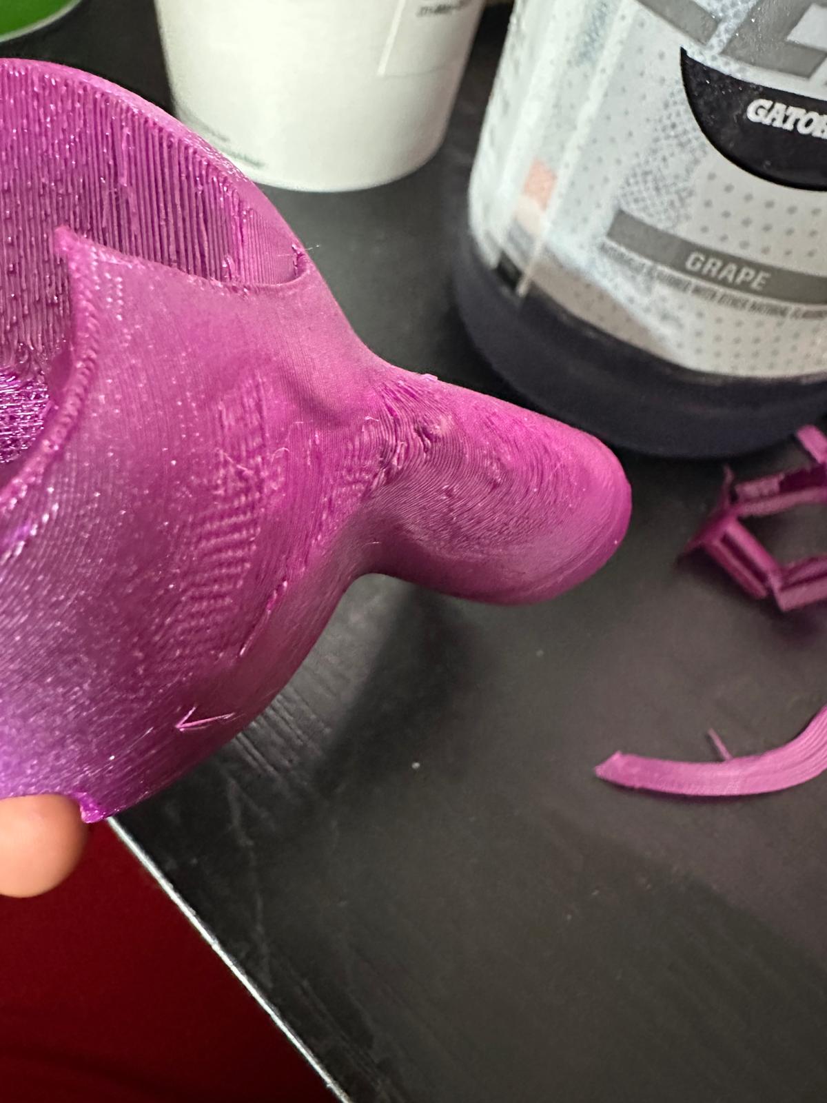

Amazon.com: TRONXY PETG Filament 1.75mm,Metal-Purple-Gold 3D Printer Filament Accuracy +/- 0.05mm, 1KG Spool (2.2 LBS) for 3D Printers : Industrial & Scientific is the filament, I dried it for 6 hours prior to printing and this pic is the rest of the finish in case that helps change your mind on it:
So, I used settings found here (My print settings for nicer/faster and more hasslefree prints) from @frankjoke and got the results seen above (not blaming him for the smudging, just giving a base reference). I love the results I’ve been getting with his settings - frank never disappoints! so one thing I did think of however, was possibly to turn the temps down and also I was running with the default speed settings. I went and changed my default speed settings in creality print now to (changed settings only):
outer wall: 60mm/sec
inner wall: 60mm/sec
top surface/gap infill/support/support interface: 60mm/sec
travel: 200mm/sec
nozzle size: 0.4mm
process: 0.20mm high quality

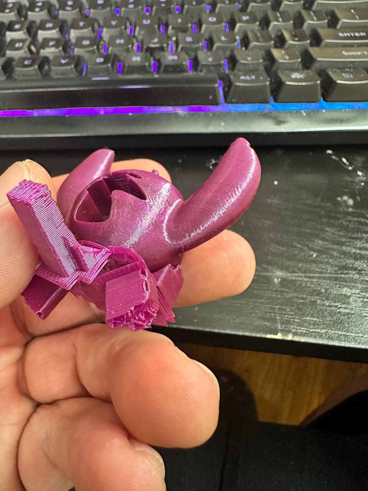

So I’m thinking the combination of the temp change and speed change helped with that smudging I was seeing around where supports were.
I also changed top z distance and bottom z distance to 0.25mm for supports using ‘normal - auto’ default supports.
Any input would be more than welcomed and appreciated because now it seems the seam on the nose is what’s being problemlatic only.
