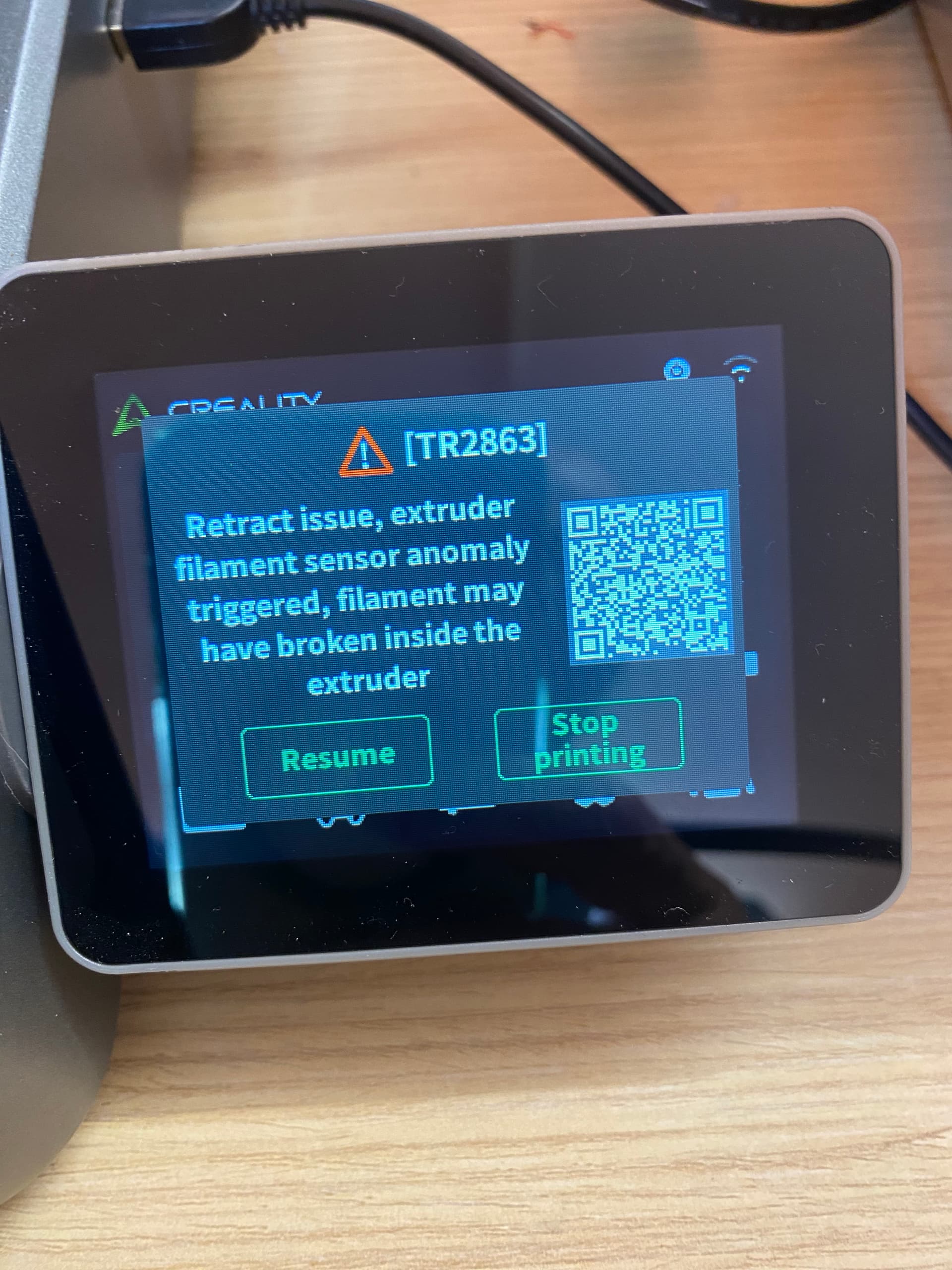

Try changing the PTFE tube. Creality HI is using filament tension for jam sensor. is the PTFE tube is not slippery enough…it will trigger the jam sensor.
Does the spool rolls back and forth correctly in the CFS? If not, it also will trigger the jam sensor. In this case you should modify the CFS.

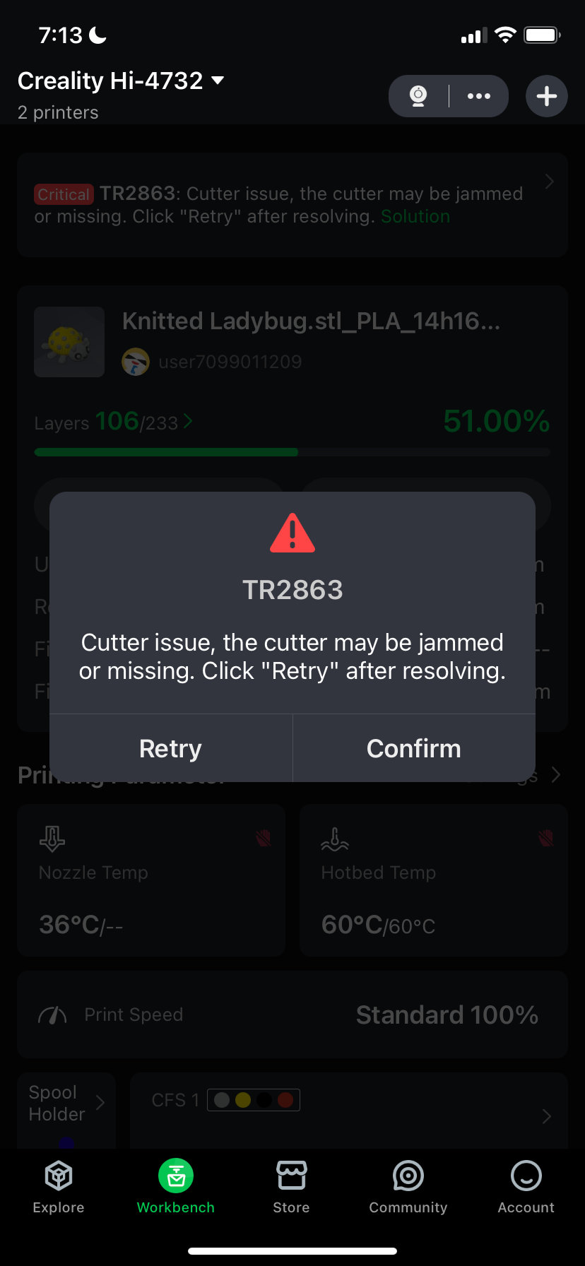

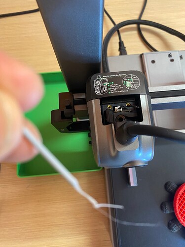

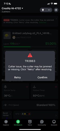

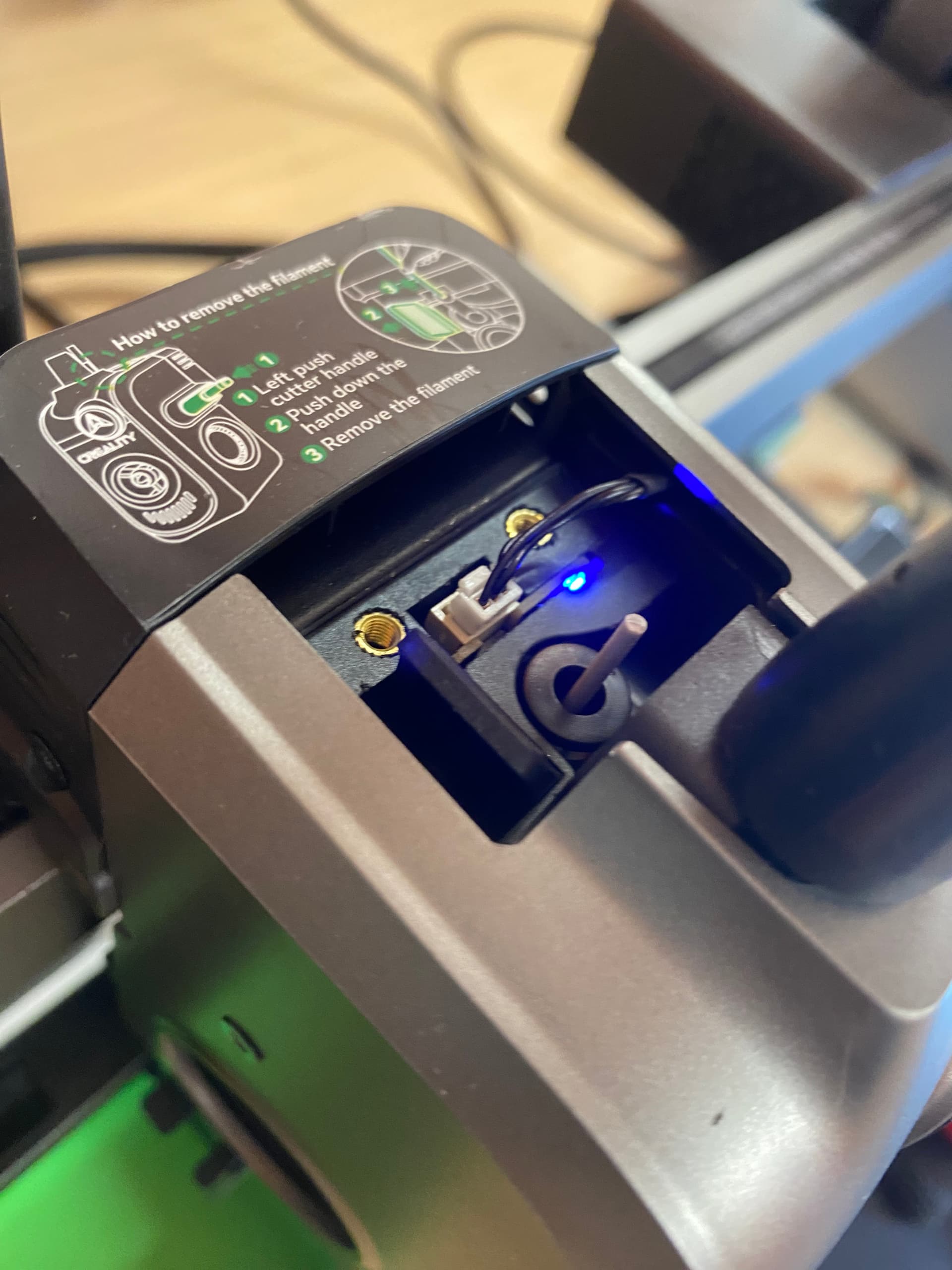

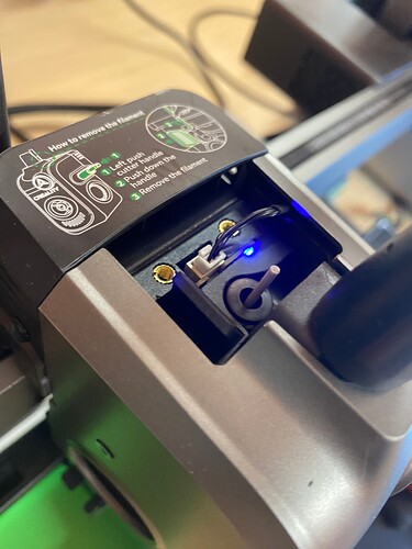

Thank you for your response. I changed the PTFE tube and the printer jammed again. If it could help I attach the photo of the error that gives (TR2863), and when I remove the PTFE tube the filament is always broken as you can see in the pictures I send. The filament comes out without problems and after heating the nozzle the jam can be solved, but when printing again the same problem appears again.

I have also had my fair share of jams and I found the problem to be in the extruder. I had to actually dismantle it and found a small nugget of over cooked filament in the gears. Once removed and reassembled every thing was fine. There is a video on you tube that will guide you through.
Seems like nozzle heat problem….or nozzle clogging…or gear issue like garrye061 said
