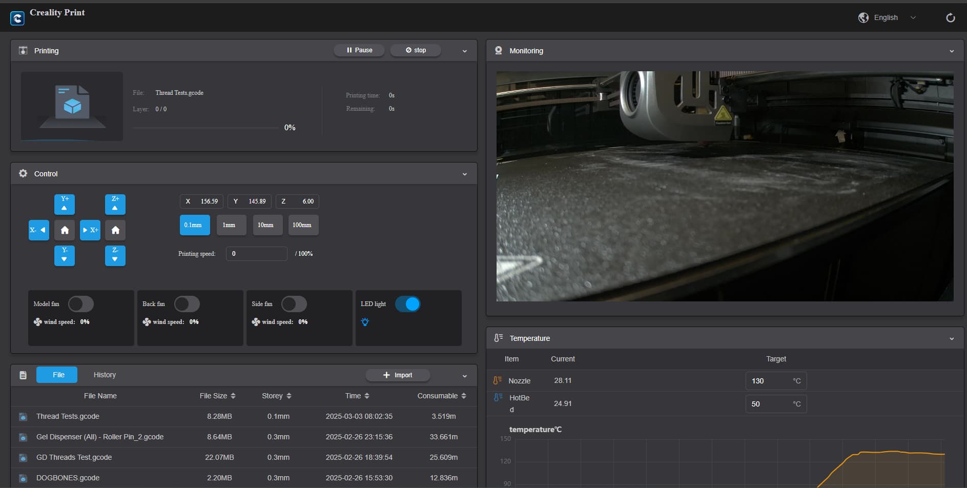

I wanted to reach out to you and let everyone know that the camera for the K1 is now working.
What it ended up being i had an older version of firmware. I updated it to the most recent version CR4CU220812S11_ota_img_V1.3.3.5.img and now it works great.
Please see the attached photo. I appreciate your help. I feel like we don’t take the time to update everyone once we figure out what the fix is.

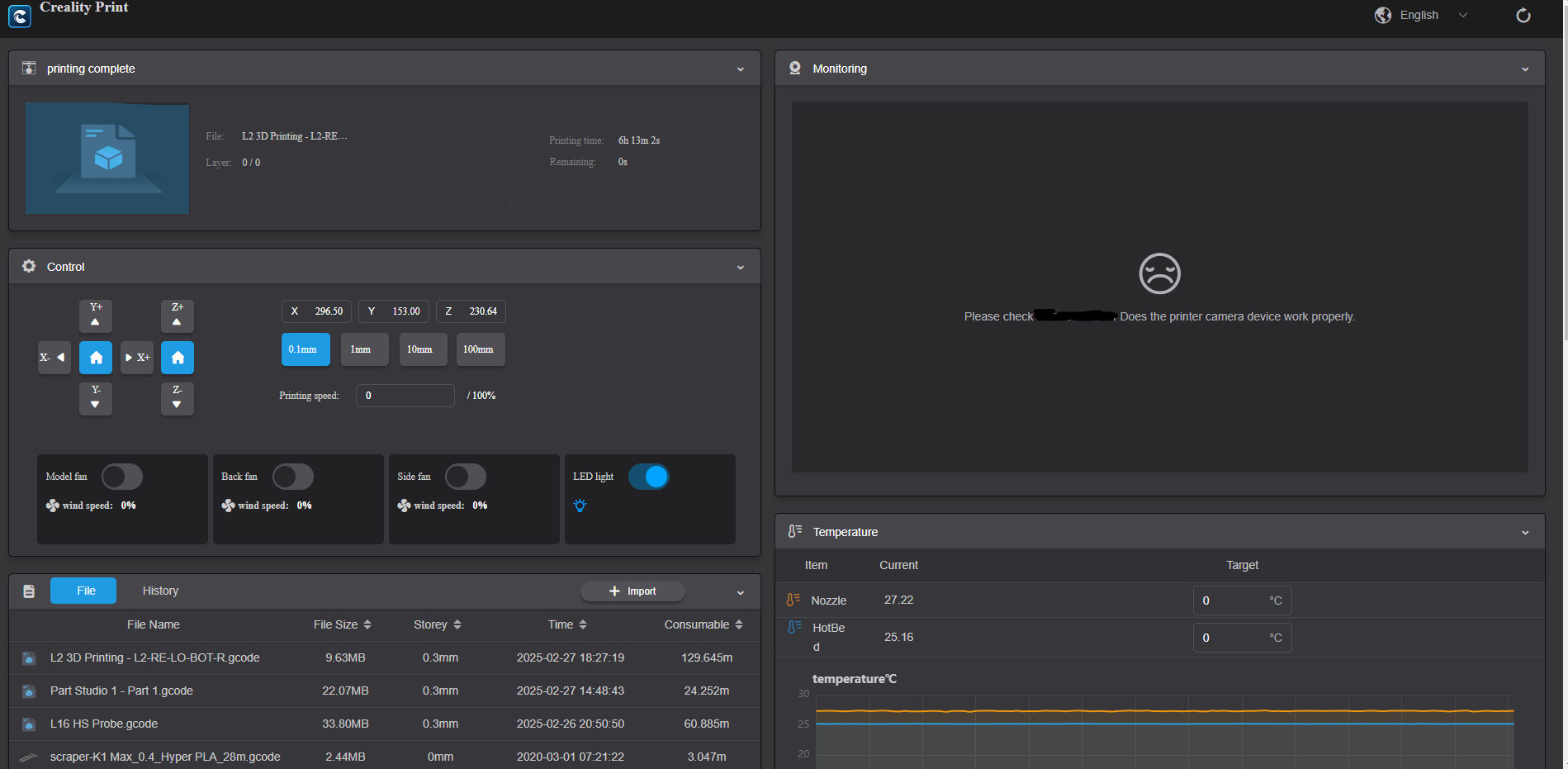

I get a 192.168.0.188 unable to connect error on my camera
Did you update the firmware? When on 1.3.3.5 you will keep having errors with not been able to conect to the camera. Switching off and on again will resolve if for a short period of time…
I have the same issue on one of my K1 Max’s ( I have two of them), my firmware is the same on both 1.3.3.46 and when checking for new firmware it appears to be ‘up to date’ but this forum suggests otherwise.
I checked the cabling, everything appears to be fine and well seated on the pins.
Were there any other steps I can try, These devices are brand new to me this week, and I would hate to have to take it apart and risk damaging it further.

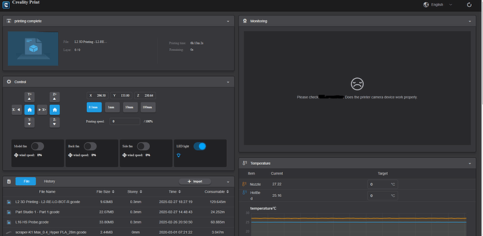

Extending on this: I have attached the screenshot of the creality print display screen for each of my K1Maxs
Printer 1
Printer 2
Again, both have the same firmware, both are new out of the box within the last two weeks.
I have already checked the cabling, which is fine.
Any help would be great
