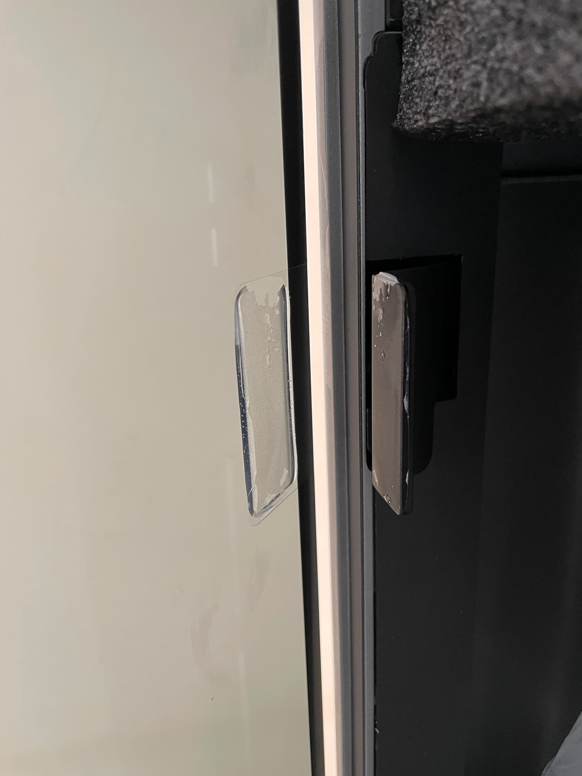

I just purchased a K2 and whilst I am very happy with its output my door just came apart exactly as per your photo. What I did is glue it back on using a two part epoxy BUT as a test I drilled two approx 2mm holes in the aluminium hinge so that the glue had more of a grip. The glue actually came through the hole and formed like a button on top. Also I sanded off the paint and went back to bare metal. I could see on my unit how the paint line clearly moved off the glue that held fast to the glass. Because the glue was still attached to the glass I could reposition it back in the same spot. Cleaned all surfaced up with alcohol before re glue.
Fingers crossed that she holds.

I donāt have a door/hinge problem myself, but if I did, I would probably try the glue used for attaching a rear view mirror to the windscreen.
It sticks much stronger than ***t to a blanket !
Cheers.
For interest I asked JB Weld for a recommendation on what they thought was the most appropriate product from their range and they recommended MinuteWeld as it āIt is suitable for glass as well as metal and has a high strength.ā

Super glue holds fine just donāt remove the lining on the inside or when it does break it will be a mess to clean up later.

The door is too heavy for glue/epoxy, I heard some have success with the glue used to attach a rearview mirror to the windshield of a car. Amazon.com: Permatex 81844 Professional Strength right Rearview Mirror Adhesive : Automotive
The glass needs to be cleaned, and all glue residue needs to be cleaned from both the glass and/or hinges.

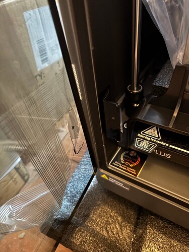

Mine just arrived today like this. I have messaged via ebay and whatsapp. Not a great start.

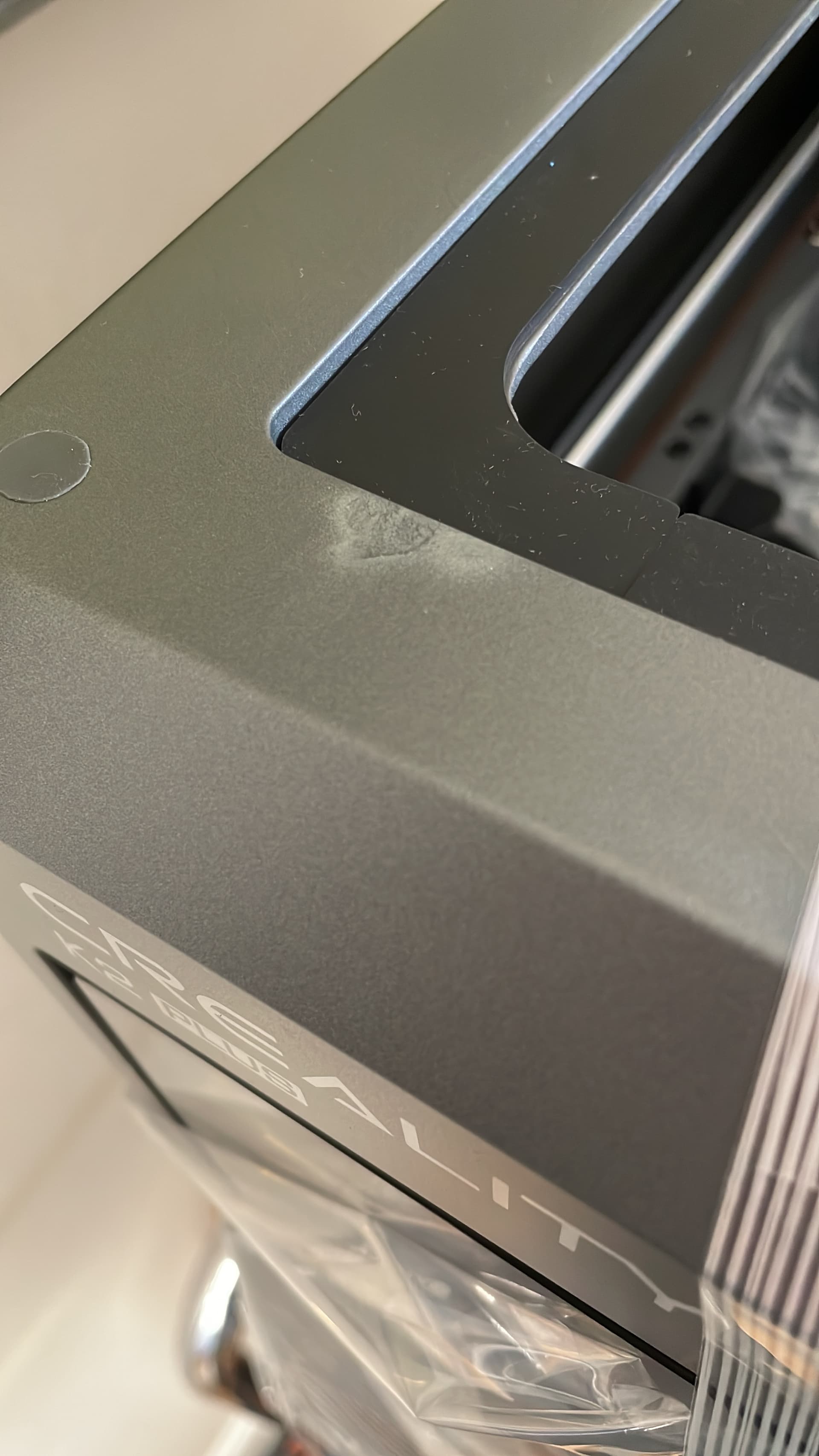

Mine had blemishes to the case as well which seems poor
Unbelievable. Itās 12/2025 and this is still an issue? I just got mine, took it out of the massive packaging and the door is hanging on one hinge.
