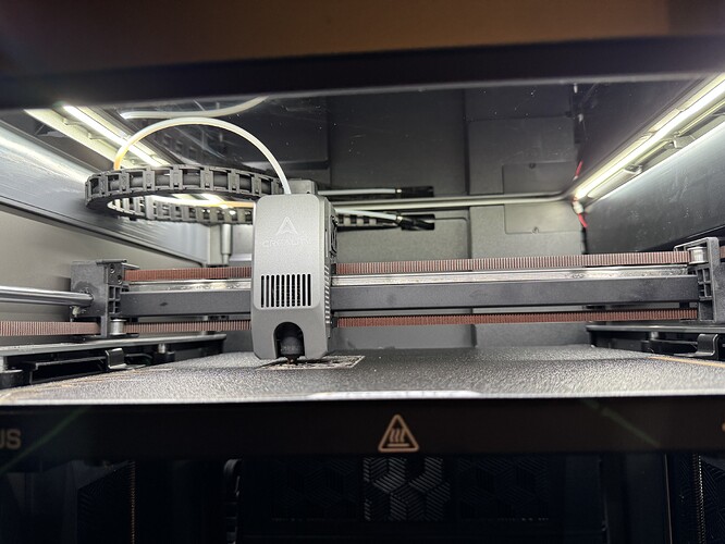

I did the mod and I stuck the led strip to the top of the enclosure. I used two sections of led so that I could spread the load across the two existing wires, those wires are very thing they are 28AWG and my led strips draw 280mA each so it’s within what the wires can carry.
I have two issues now; the first is that the led strips flicker when the temperature of the extruder hits 220 and up.
The second issues, which I should have expected already. The led strip starts to detach due to the heat. It is mostly an issue at the ends where there are wires and hence more weight. I have had to use some nylon high temp tape there to hold it.
How did you overcome these issues?
I would appreciate any input on this.

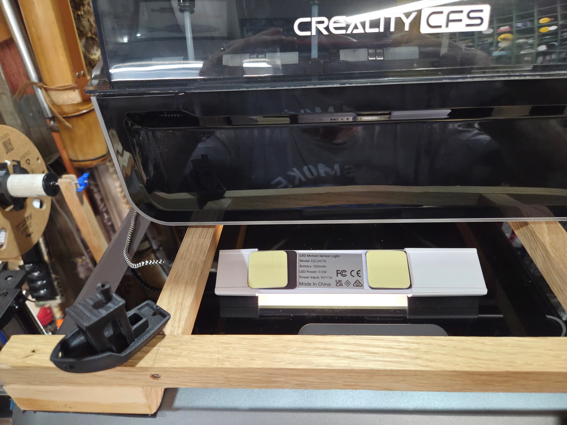

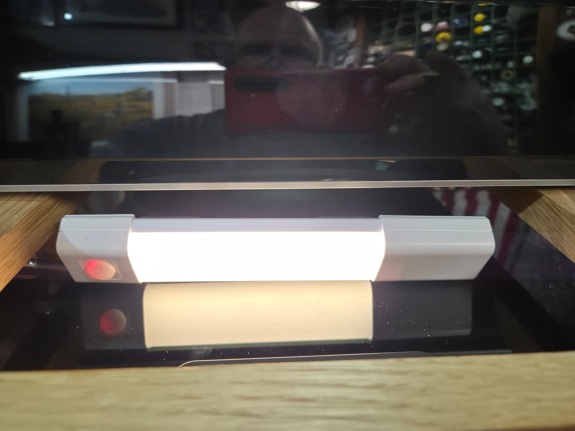

I LIKED YOUR POST! I WAS LEERY TO TRY THE SOLUTION YOU TOOK BECAUSE OF THE 28 GAGUE WIRES. INSTEAD i BOUGHT AN INEXPENSIVE ( ABOUT $4.00 ON AMAZON) MOTION ACTIVARED LED LIGHT. YOU CAN SEE IT IN THE PHOTOS. I LAY IT ON THE FRONT TOP OF THE GLASS. THE LIGHT IS " EZVALO Closet Lights, Wireless Under Cabinet Lighting, 30 LED Rechargeable Motion Sensor Light." IT WORKS GREAT!

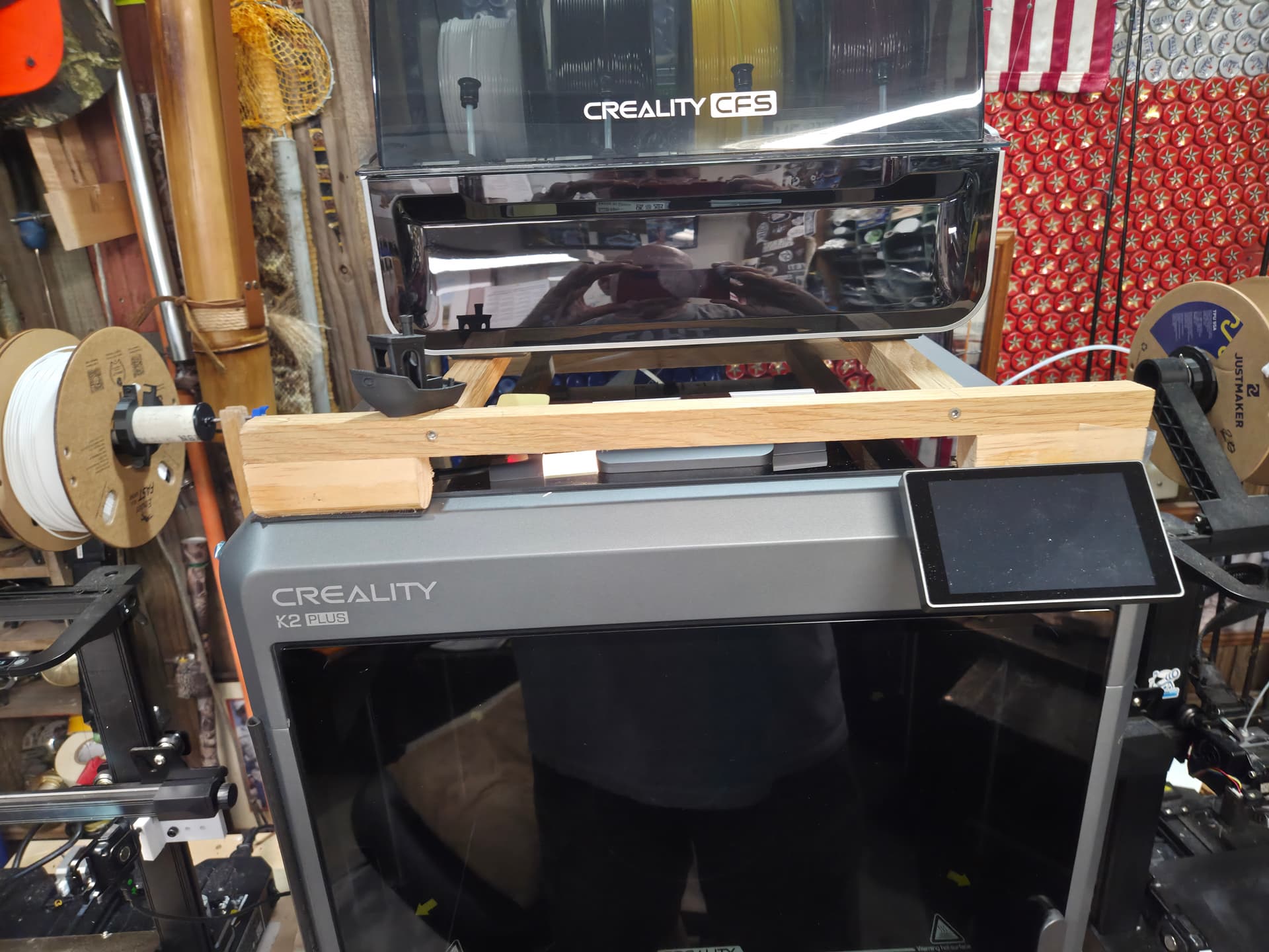

YOU CAN ALSO SEE I BUILT A SIMPLE WOODEN CARRIER ON THE K2 TO CARRY THE FILAMENT HANDLING SYSTEM ABOVE THE GLASS SO I CAN REMOVE GLASS WITHOUT MIVING THE WHOLE SYSTEM. IM WORKING ON DESIGNING THE CARRIER FOR PRINTING ON THE K2 … SOON.
