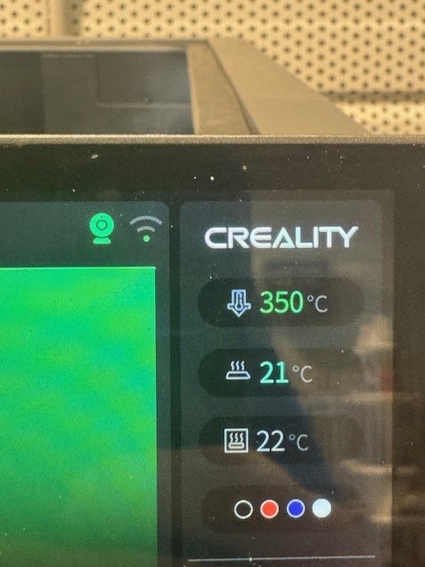

I’m having a problem with my K2 Plus printer. The filament is stuck in the extruder, and I’m unable to push it through. I’ve heated the nozzle to the maximum temperature, but when I try to push the filament using the tool, it doesn’t move and remains blocked.

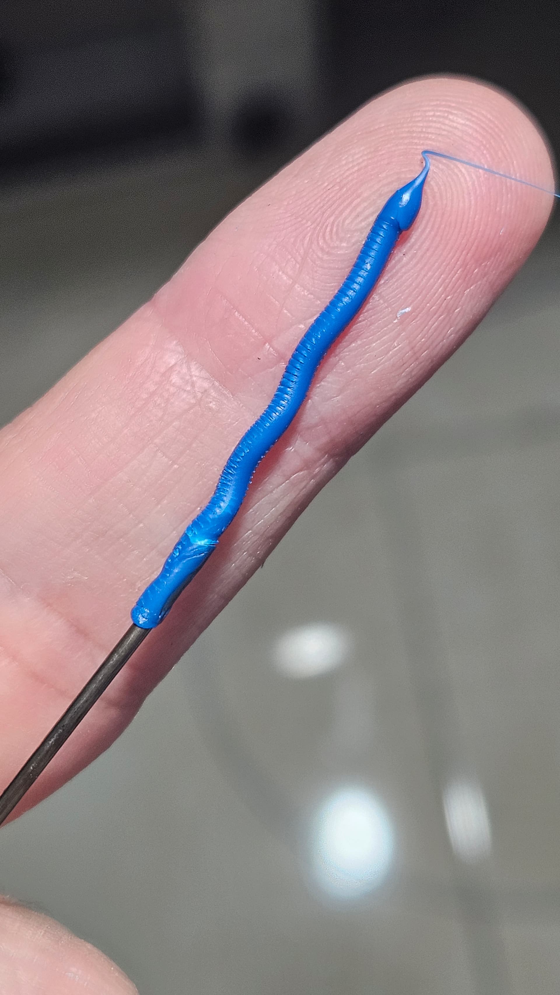

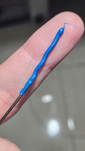

I had the same issue before. The main culprit is the extruder motor gets too hot, and the heat propagates to the filament through the gears. Its causing softening of the filament. Most of the times it got clogged in the extruder. But sometimes it also causing clogging in the hot end, particularly in the heat break area (outside the heater area, thus no matter how hot you heat up the nozzle, you just cant un-clog it).
To clean it: heat up 1.5mm allen key with a gas lighter, and then stick it to the filament inside the heat break. Then after cold enough, pull out the troubled filament. The troubled filament appeared to be bent like a snake, indicating that its too soft when pushed by the extruder.

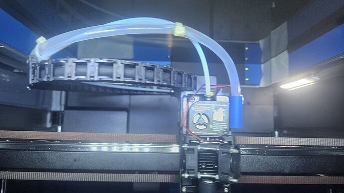

My solution is by blowing air to the extruder to cool off the gears using aquarium aerator through silicone hose. It works beautifully. No more jam and clogging.

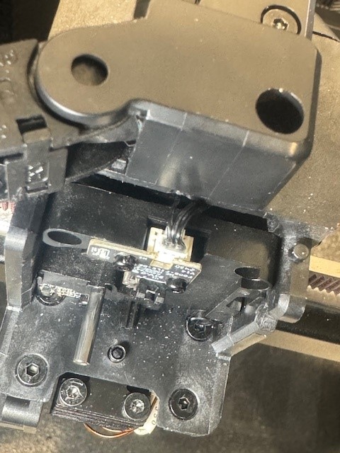

Hi everyone again, I was away for a few days. I still haven’t resolved my issue, so I decided to contact Creality support. They sent me a stepper motor for the extruder, which I replaced, but the problem still persists. Here’s a video showing an example of the issue — thanks to everyone for your feedback.
Does anyone have an idea of what it could be? The gear seems stuck, and the gear support looks like it’s being forced and about to pop out. Link for the video : Unique Download Link | WeTransfer
Can you show a picture of your air cooling set up?
@Jerry_Walechka sorry for late reply.
It has been clog free ever since.
Great idea.
It would be appreciated if you could advise parts used at extruder end to determine airflow to extruder. Is it standard aqua part etc? How is it attached to extruder parts ?
Any further photos would be greatly appreciated
