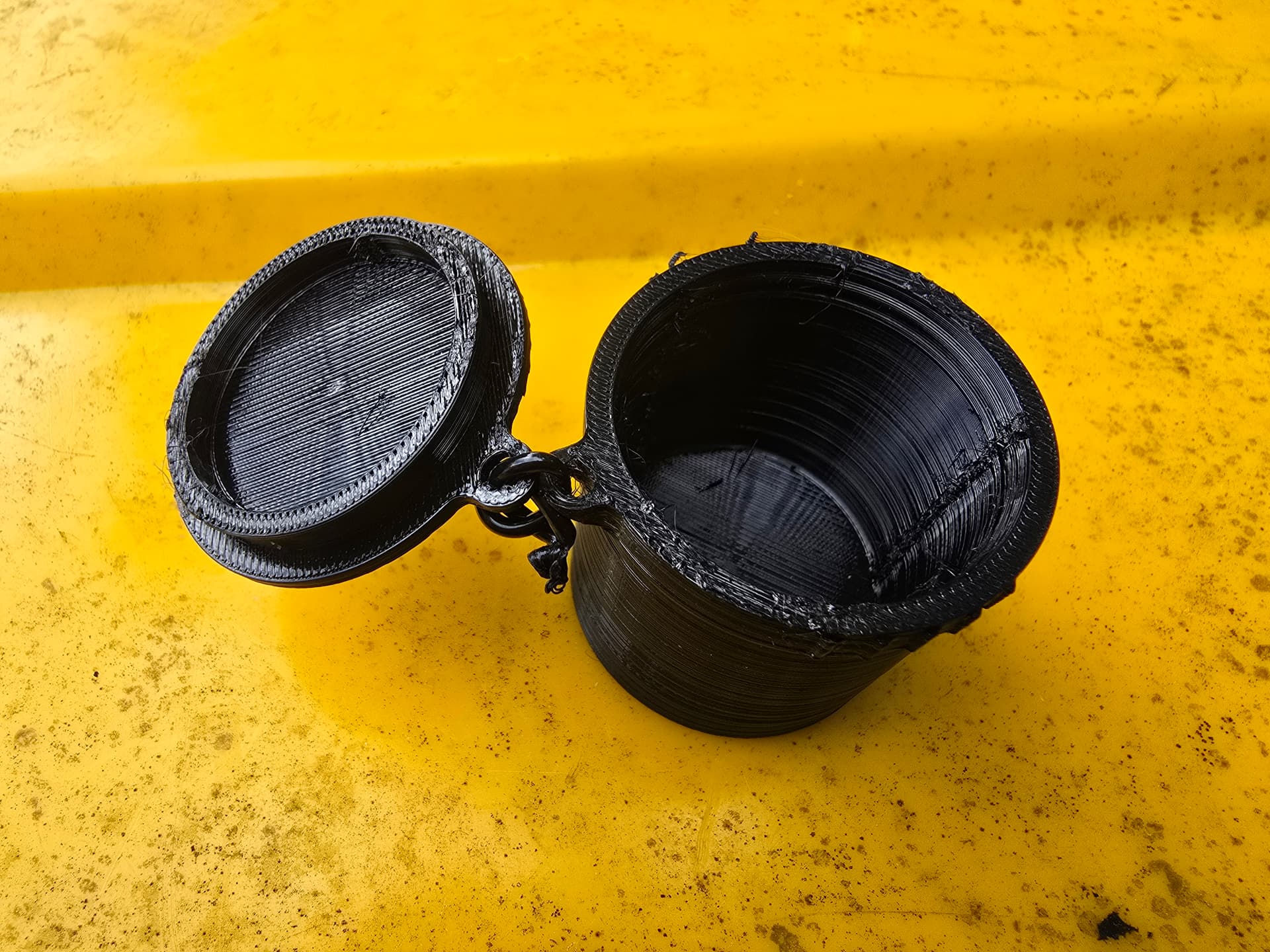

K2 Plus TPU Printing - How I print TPU
FYI, printed the spacers and gave that a try as well..
works on normal non-broken extruder
If I understand correctly, did you remove the top cover when you fed directly from the top mounted spool? Does the open chamber affect the internal temperature enough to matter? Thank you
The k2 plus specs say you can, but the cfs can not. At least when i buyed the k2 plus the say it could. I used the spacers to print tpu but mij ender 3 s1 pro’s can handle tpu a lot better so i use them to print tpu. Its even faster then my k2 when printing tpu (using klipper on my anders).
then the have change that, the k2 plus was capabele but not the cfs.
