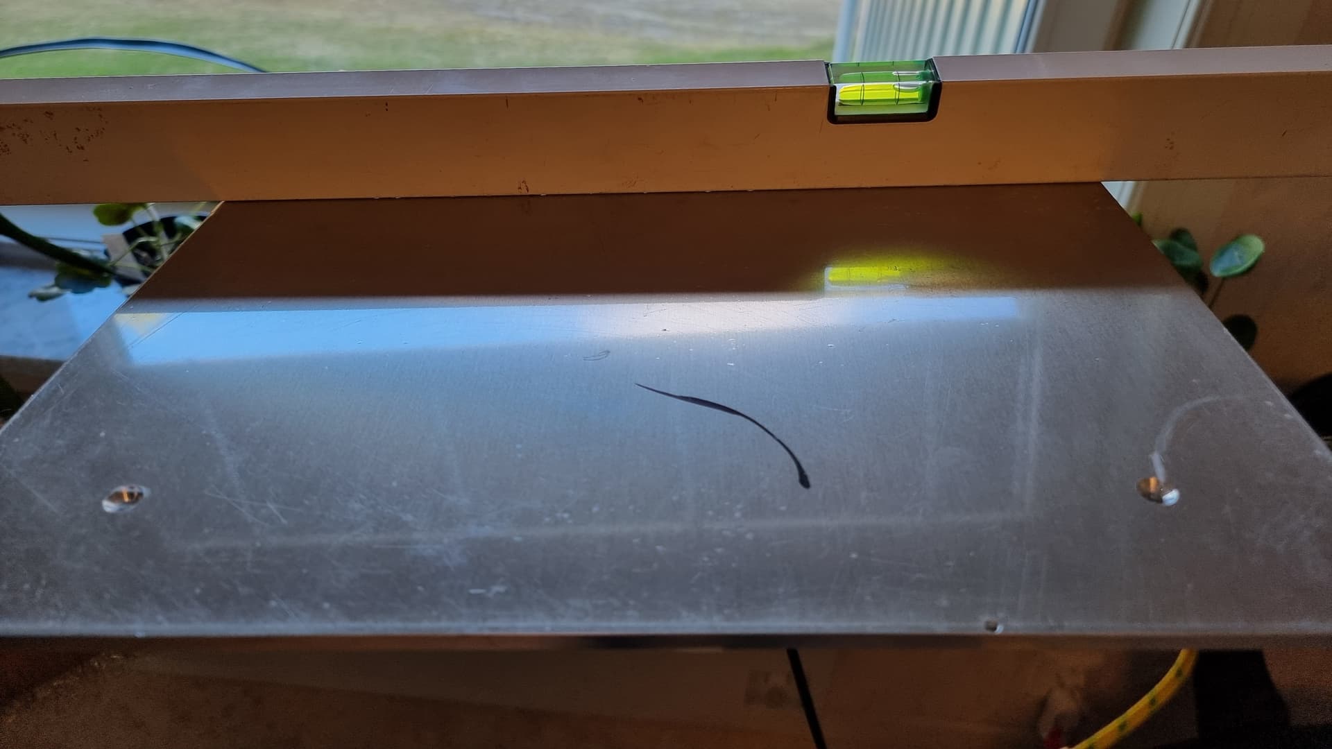

K2 taco heat bed
Even with an almost perfect calibration, I have a taco heat bed. In addition, I do not understand why the heat bed adjustment threats/ knobs come with applied blue Loctite.
Prints will work, but you get an inconsistency in the first layer on large objects. This leads to bad outer surfaces for the first few layers.
I will need a replacement heat bed.

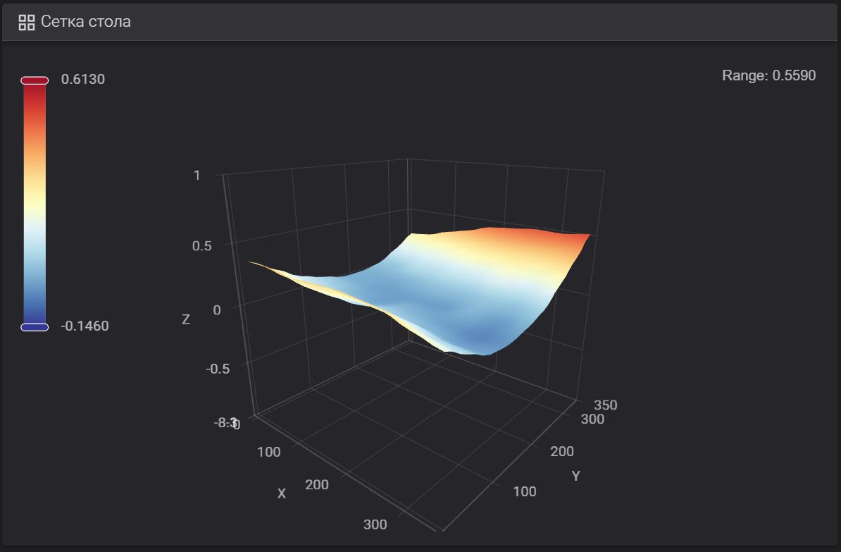

A variance of 0.6mm is not bad. Try heatsoaking the printer and disable the chamber heater for the first few layers. This thread is having a simmilar issue, althoug not exactly the same: 1 & 2 layer strong problems
IMHO, difference upto 1mm is acceptable for this printer. It will be compensated by firmware when prints.
Please check and tight screws on the rail, on the hotend, on the strain gauge.
And for now maybe something wrong with z-offset when printing from slicer directly. Please try to print the same from printer’s memory.
In general ~0.6mm would be OK, I had problems with >0.9mm only and never get below 0.3 as well.

0.6 variance is a three-layer difference. I don’t understand how you can evaluate this as acceptable. This leads to a very inconsistent first layer. It might even be the reason why you can’t buy a smooth-build plate.
You can clearly see that the compensation algorithm is unable to compensate for this amount of variance; the wall thickness is inconsistent on the first layer.

the possible compensation seems to be dependent on the the complexity of the deformation shape
Sure. Not every plate shape can be compensated. IMHO, it depends of smoothness of bending. Sharp bends is a problem.

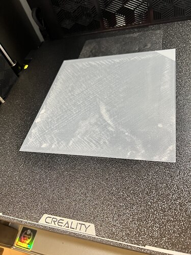

I just received my replacement bed. It’s even worse… The gray pad over the silicon is missing, its bent, and the magnet sheet is not installed. Does Creality any quality checks?! Never had such a frustrating experience in the last few years of 3d printing

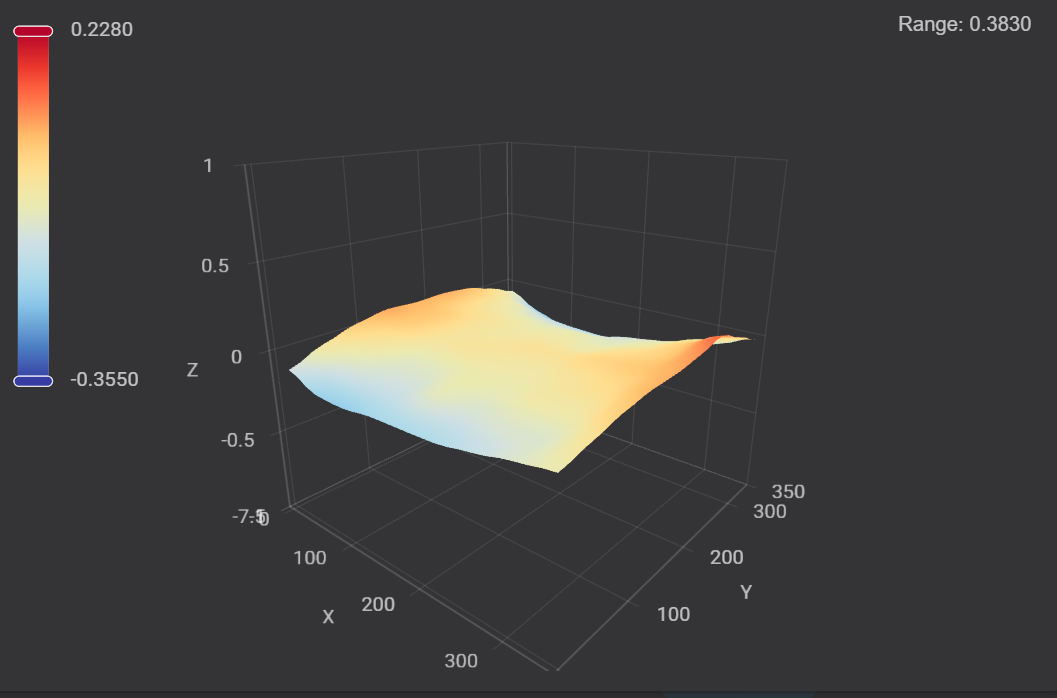

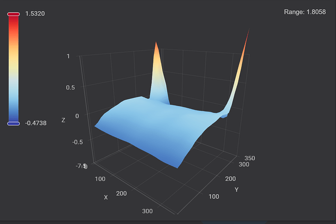

My bed was also curved, front to back (taco shape) - I suspected it was warped due to the weight of the CFS that ships inside the printer. However from your experience with a brand new plate, I’m now thinking it may be simply a manufacturing issue. Anyway, I fixed my plate by inserting a shim between the plate and the steel cradle on either side, half way from front to back (mid-way between the bed spring-loaded corner screws). Here are the before and after bed mesh shots:
Bed before adding shims:
Bed after adding shims and levelling with the four corner screws:
So it is possible to correct a curved plate to some degree, but it took me a lot of time and patience to do it.
