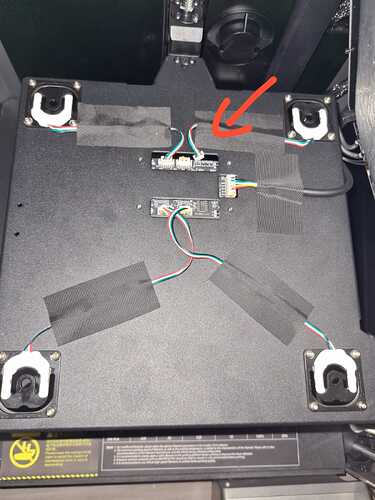

hi, did it work? im just bought mine first test goes fine but after update to 1.3.3.5 show the error 2521.
Yes it did. They sent me 4 new bed level sensors. I only replaced the one I knew was bad. But it has worked perfectly ever since. I have upgraded to the newer firmware and everything.
thanks for reply me, i send an email to creality but they really take time to reply, i thinking in send it back.
how did you know whats the bad one?
there are these things, right?
my k1 does it
i did it, i just remove all conectors bed level sensors, put one by one and find witch of them dont work.
then remove it, my z axis worked, but when i put a stf to print, error on levening, error 2522, but now i know what i have to do, gonna ask for a replace bed level sensor.

Yes that is one way to identify the bad sensor. That is probably the better way to do it. That’s how I confirmed I had found the correct one.
The way I found the bad one was by watching it do the bed level calibration. I watched it closely. When it gets to the far corner it will smash down too far for the bad sensor. Then I took it apart and unplugged that one to confirm.
