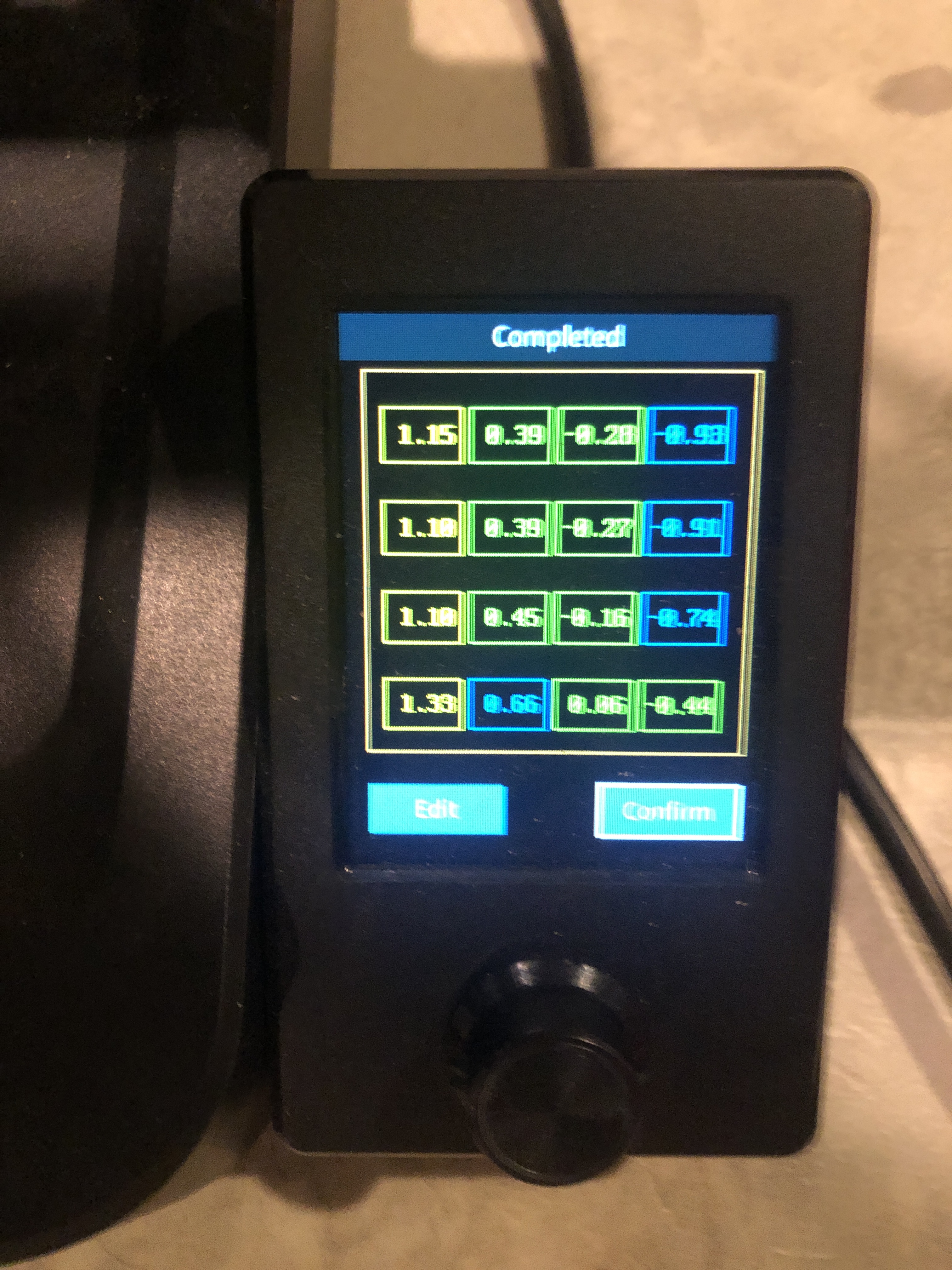

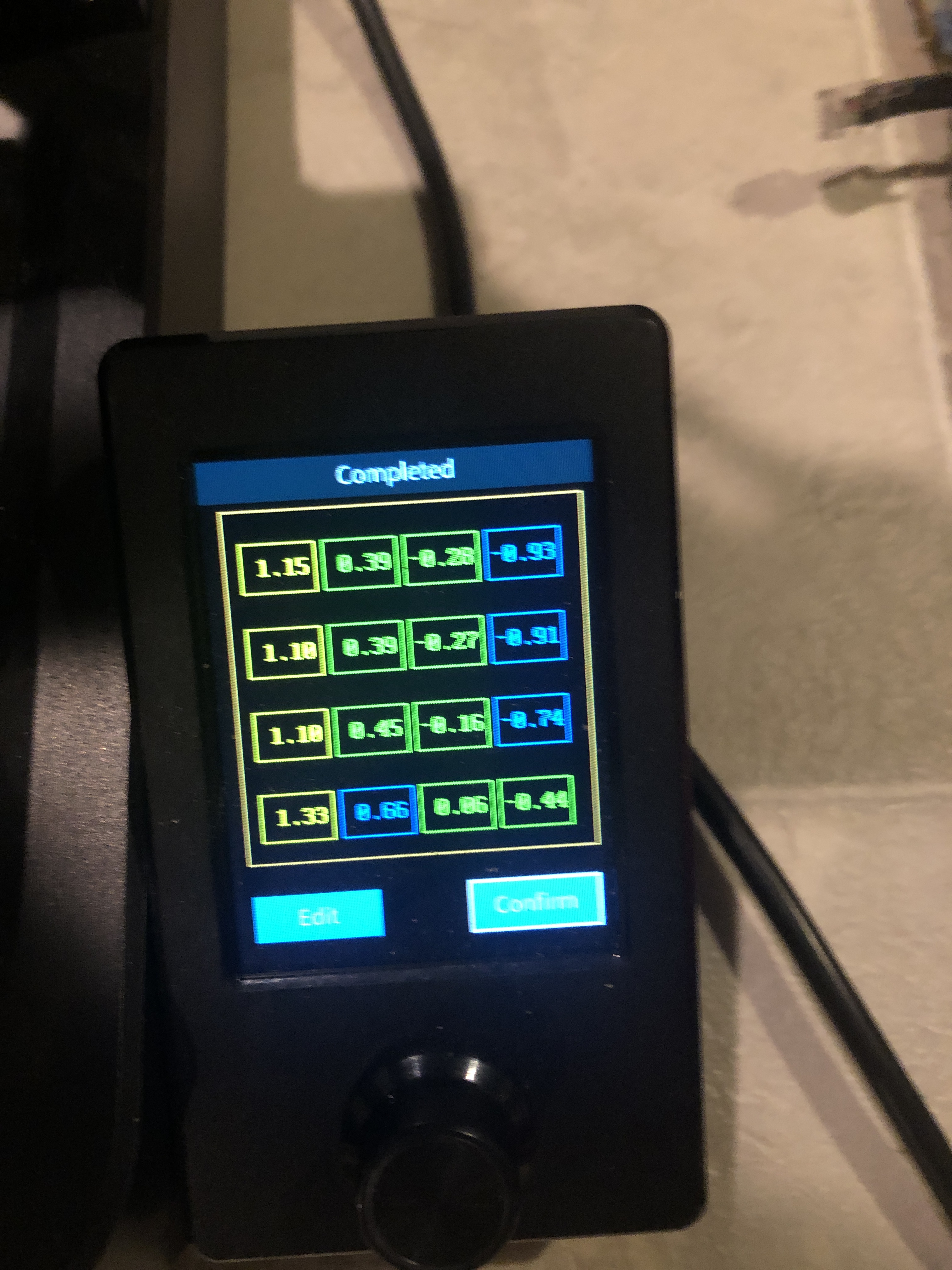

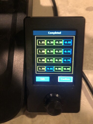

I tried to get it level by using springs meant for an Ender 3 and the auto leveling feature and it helped but I still can’t get all the corners below 0.25 mm. Here are some of the results.
You worry too much, as long as the runout is less than 2mm the autolevel will cope. My V3SE has about 1.3mm runout and prints just fine just got to get the z-offset tuned in. Here is a full bed of TPU covers with said runout.
