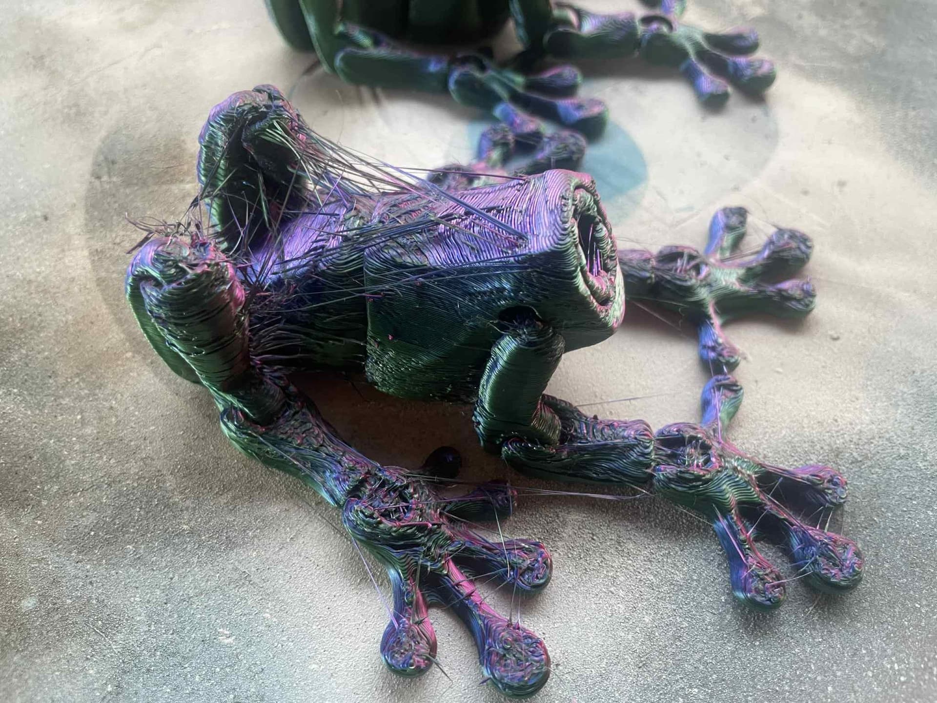

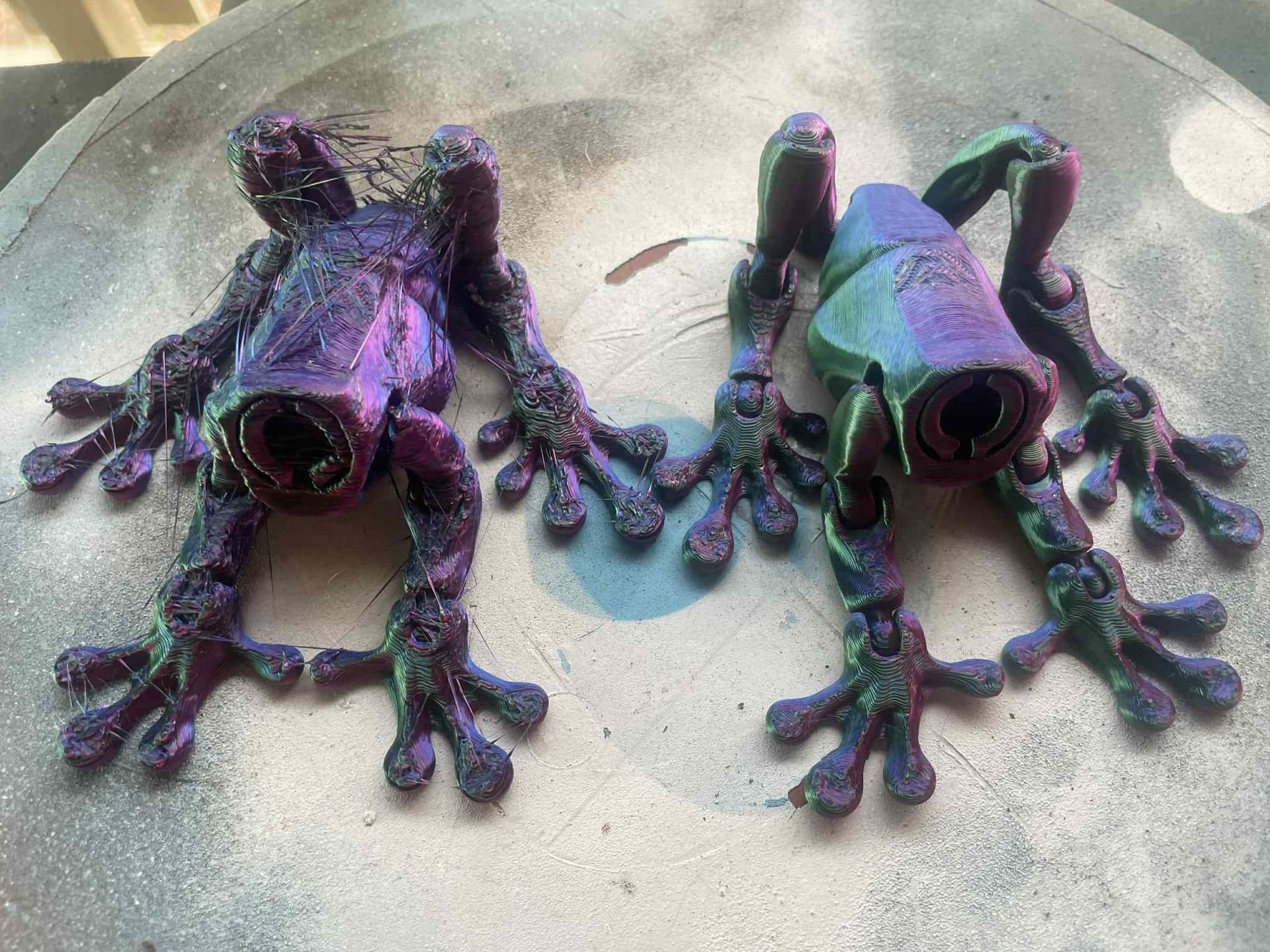

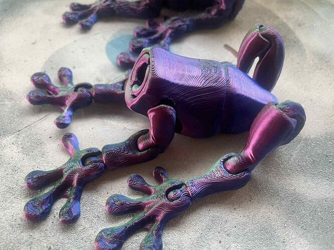

I have been trying to get this file to print for a couple of days now, but no matter what I do, the print turns out very badly. I have set a pause at layer 18 to insert magnets, but as soon as I resume, things go crazy. I have calibrated every setting I can think of, but nothing seems to work. I’m running the latest version of the Creality Print software and have updated to the latest firmware on the printer. The photos show the difference between “no pause” (smoothish with a 0.2mm layer height) and then exactly the same settings, except with a “pause” (disastrous with stringing, poor layer adhesion and layer shift)! But what really gets me is when I first printed this file many months ago, it printed perfectly, pauses and all! If anyone has found a fix for this, I would love to hear it.

After spending a very frustrating period of time chatting with tech support, which proved to be a complete waste of time. I have solved my issue by rolling back the firmware on my printer to:-
Ender-3_V3_KE_F005_ota_img_V1.1.0.14.img
It is now printing perfectly after pausing.
If anyone has the same type of issue, this might be the answer you are looking for.
