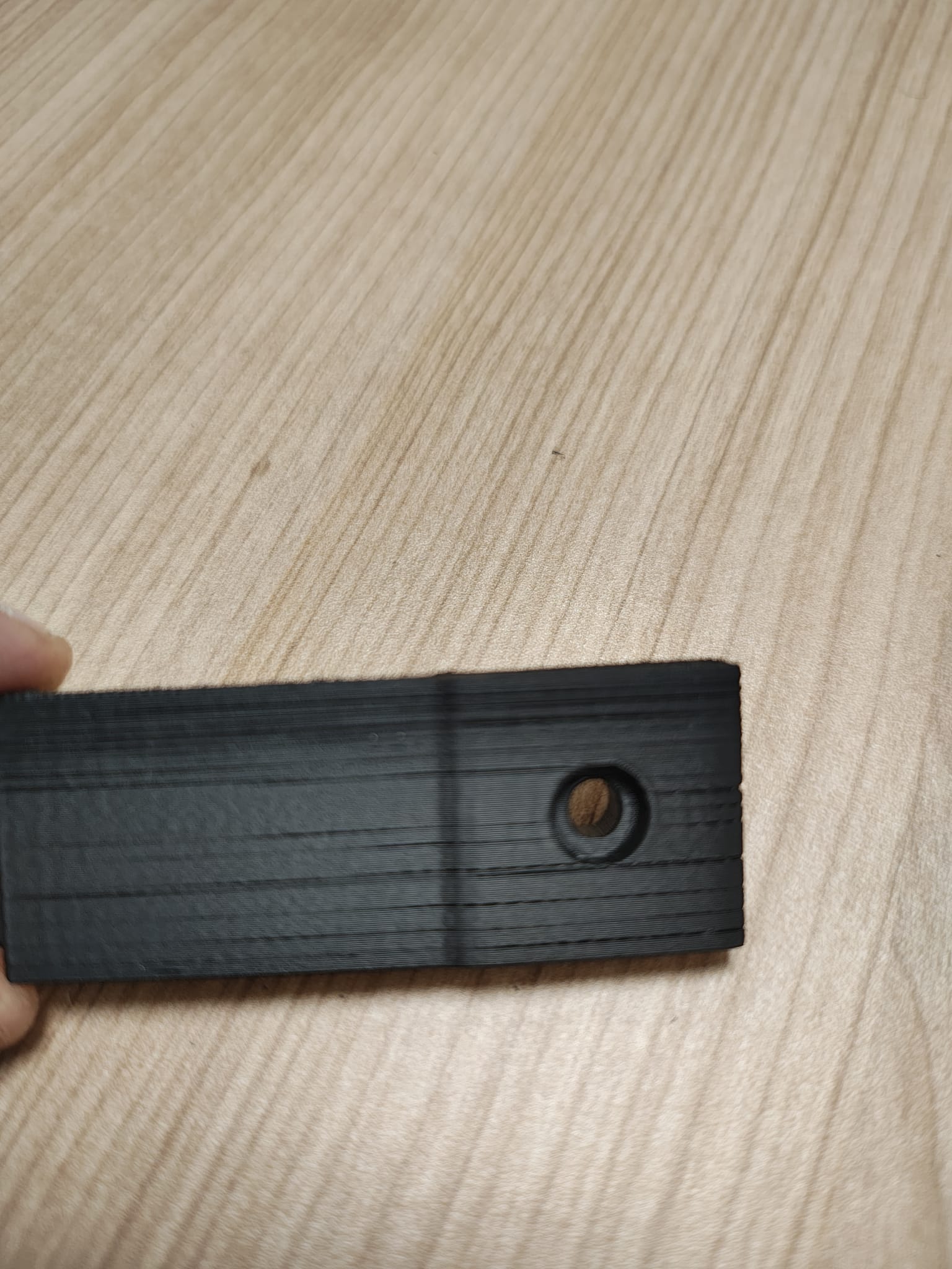

My KE was printing happily along until it started to leave some gaps in the outer wall. It happened overnight with no changes made to the printer or file.

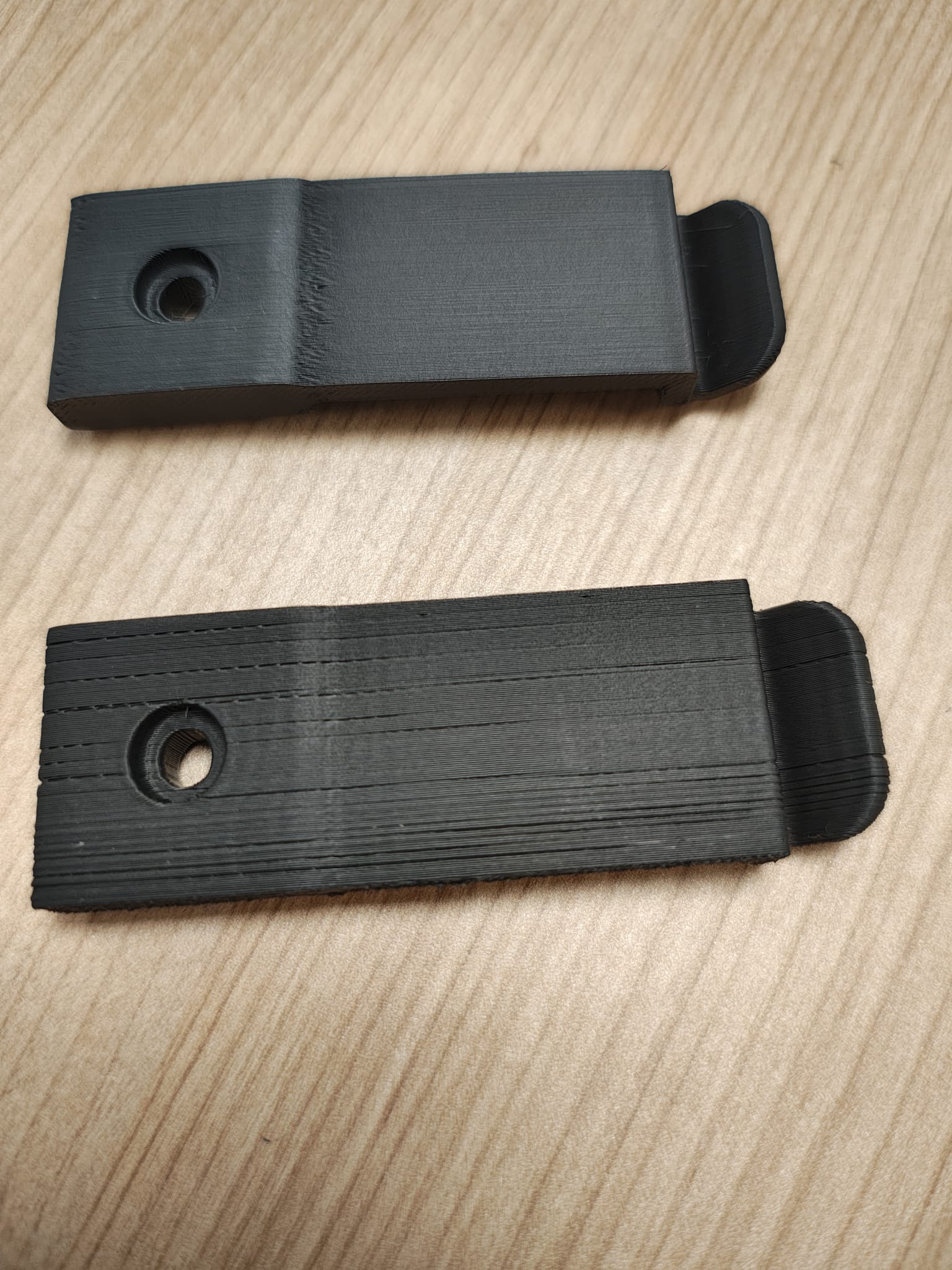

What I have tried beside the obvious full calibration + vibration calibration was to replace the hot end with a new one (same model) and use a brand new opened filament roll. This is in PLA, btw. In the 2nd picture you can see the same part previously printed in the same printer, no issues.

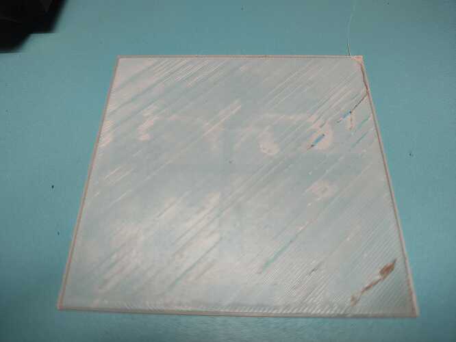

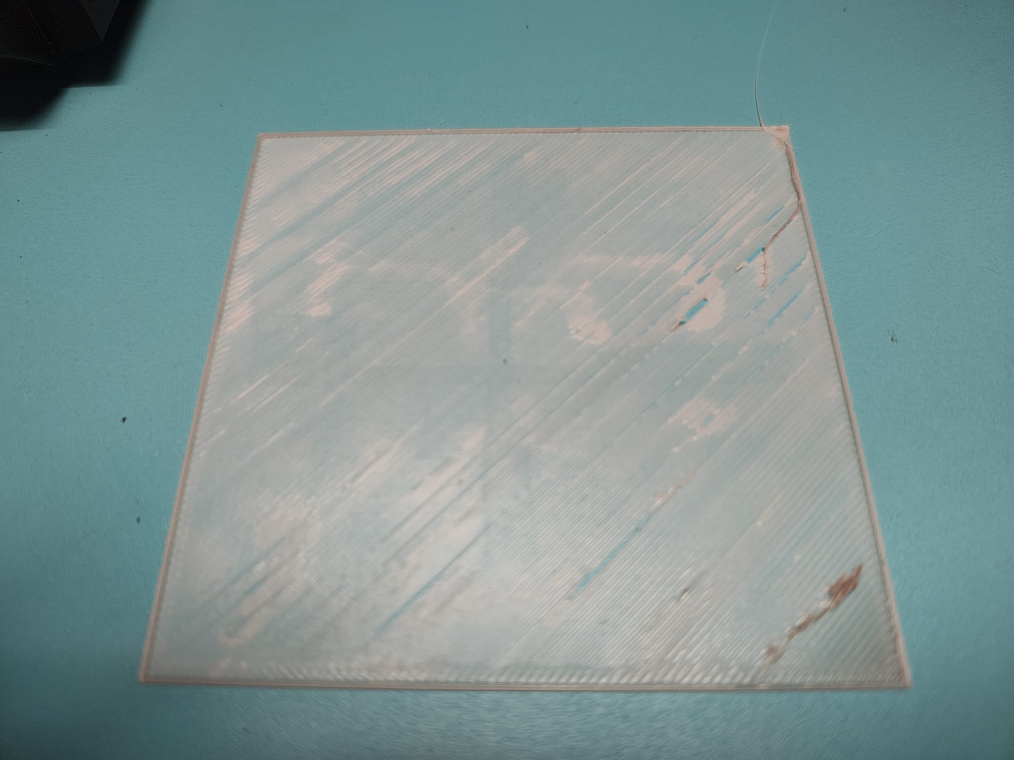

Running more tests. The first layer below is Creality Hyper PLA (fresh), 0.2, -2,5 Z as per machine calibration. On a secon test I put the flow to 130% and the Z at -2.4 and looked better. Still, how do I calibrate the extruder on this machine ? I cannot find any menu.
now, it looks like I have an under-extrusion issue. How do I calibrate the extruder on this model ?
Final update, the problem was a half faulty extruder that from tile to time was probably skipping, leading to the missing lines. I have replaced the extruder and now all is good again.
