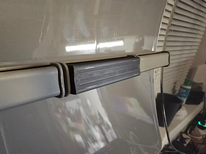

First, the handles to open/close the lid where going to hard and in most cases could not be opened/closed with one hand.
I printed CREALITY CFS OPEN/CLOSE SLIDE LATCH and used a bit of silicon spray (no other grease please for plastic!) like on the picture here:
Since then my lid opens easily with one hand (I always have the new/old spool in other hand
