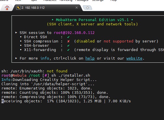

При попытке зайти получилось что вот так и как бы висит… или что-то делает но оооочень медленно.
и потом выпадает в ошибку так и не загрузив интерфейс рута.
Внимательно изучите Nebula Pad with Ender-3 v3 SE

The issue here is the pad is being told to start a “factory test” every time it boots up and this factory test automatically replaces the printer.cfg file with "factory_printer.cfg to perform the test, and so you lose all of your printer setup data and the extruder/max temp settings reboots every time you try to input it so you wont be able to change those values either.
I had this issue with my nebula pad and creality sent me a replacement after showing the customer service that i had tried everything, flashed every firmware, factory resets, replacing the ingenic firmware. None of it changed everything, and the device came with the issue so it was nothing i had done to it to cause it.
