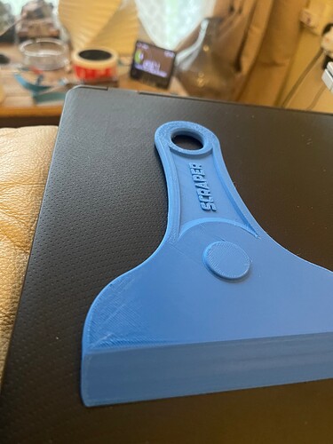

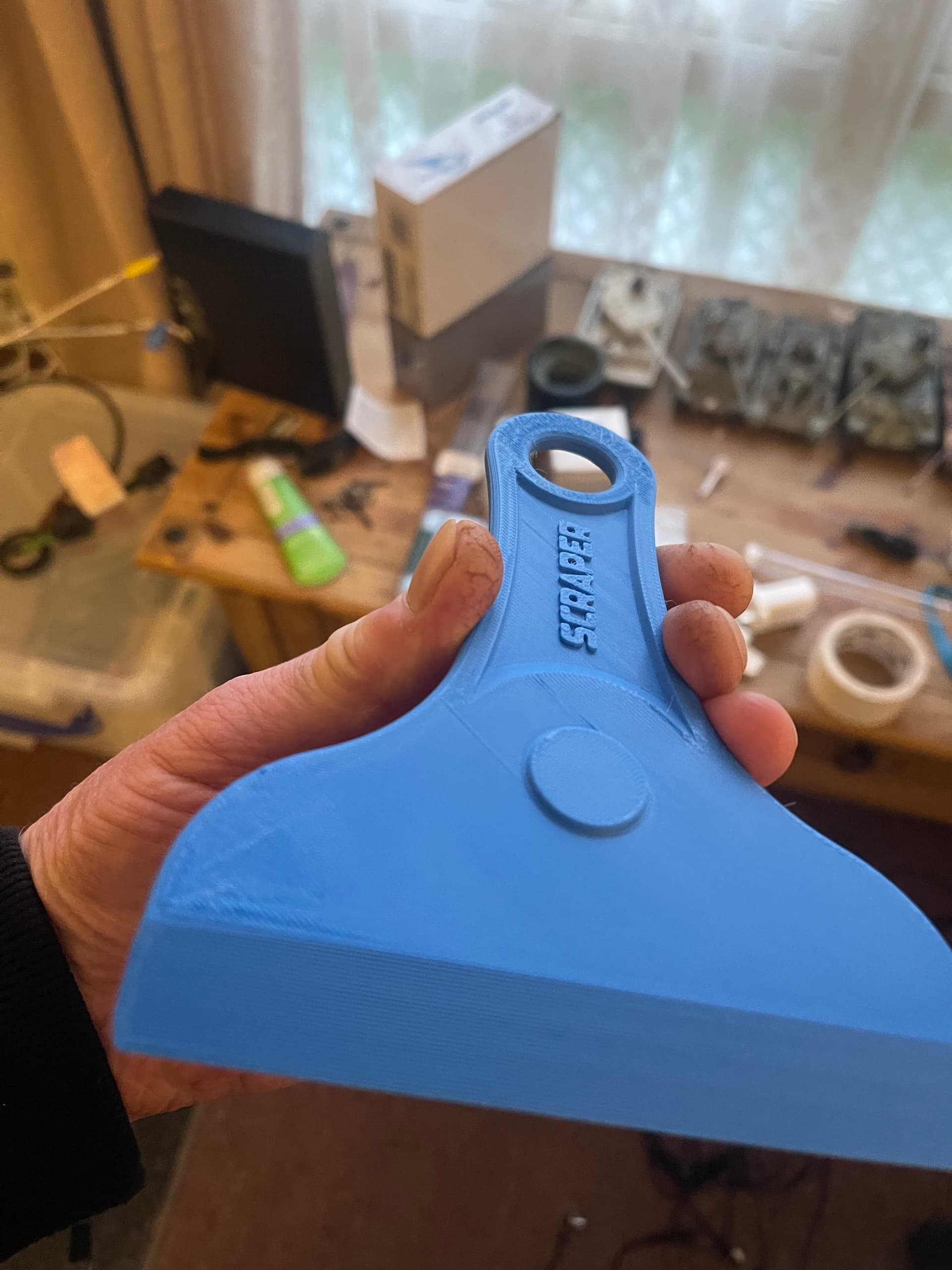

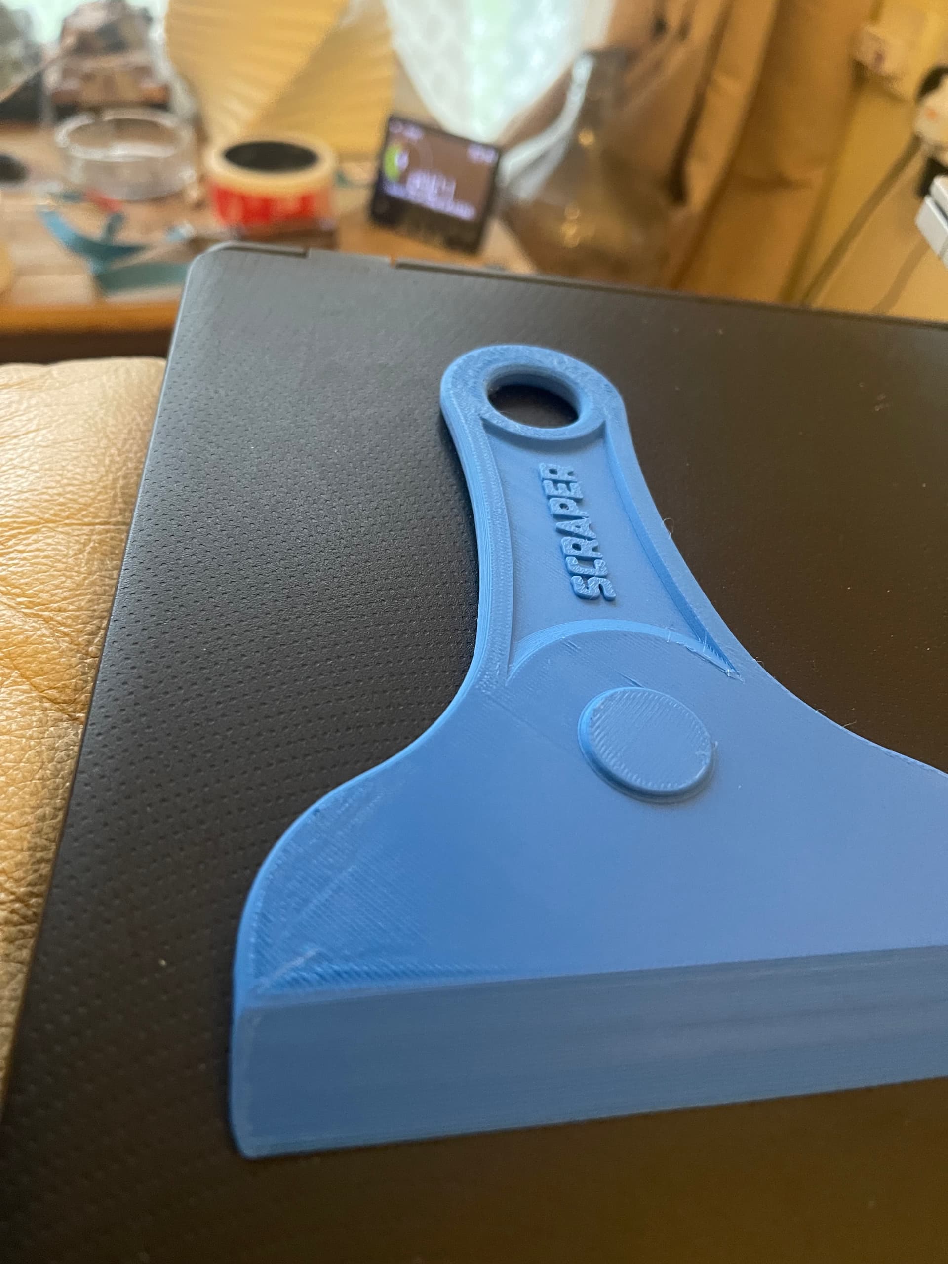

Brand new k2 pro. I downloaded this scraper from creality and the quality started to go a bit downhill at the end(see on the top of the handle and bottom left). My model fan was on most of the time/back fan was off/side fan was on from time to time. Temps in chamber were 35deg C. Bed was 50 filament at 220 iirc(maybe upto 240 at times?).
The other thing I noticed is that where it started to go a bit downhill is the 2 places where the speed was the fastest ie the head was darting back and forth really quickly.
Anyone know why this happened?

Sorry PLA. I left the door open. It just seems strange that the two parts it happened at are the 2 quickest parts,and wondering if anything to do with that. The model fan was on and the side fan now and then.

A couple of things come to mind, but before getting into those, can you post a screenshot of the sliced model as it is laid out on the build plate? That will allow further analysis of where the defect occurred relative to its position inside the chamber.
Second, can you post a photo of the underside of the model? That will help identify whether any first-layer adhesion issues are contributing to the problem.
That said, without those details, here are my recommendations in order:
  1. Make sure the build plate is washed with very hot water and dishwashing soap. No need to scrub aggressively - a nylon sponge is sufficient. The goal is to remove grease and any invisible contaminants and eliminate build plate hygiene as a potential first-layer failure.
  2. After cleaning the plate, perform a full bed leveling cycle to rule out incorrect bed leveling. Also check for debris under the plate. While this is unlikely based on your photos, it is still something you want to eliminate as a variable.
  3. Diagnostic step: After bed leveling, run a first-layer test. This is typically a cube primitive scaled to nearly the full build surface and less than 0.5 mm in height. First-layer tests are very unforgiving - issues such as filament moisture, leveling errors, or plate contamination will show up immediately. If you are not familiar with this test, I posted a quick tutorial in this post to address a community member’s concerns regarding bed leveling:
  1. Chamber temperatures: While it is often recommended to lift the top cover when printing PLA, I have never needed to do this when the filament is properly dried. While there is no harm in trying it, for the K2 specifically, this advice is largely outdated due to its active cooling. In practice, chamber temperatures would need to exceed and sustain roughly 35 C before PLA behavior is meaningfully affected, and with your model’s simple geometry and quick print, chamber heat is very unlikely to be a contributing factor. More complex, tall, or delicate structures that take much more filament and time (for example, Eiffel Tower-style models or castle spires) are far more susceptible.
