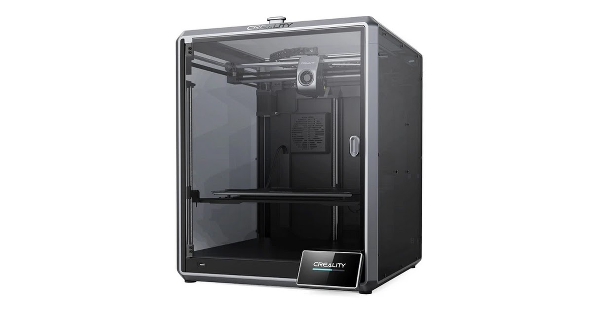

Hello. I am looking to buy a semi-professional 3d printer for my child’s advanced robotics programs. We are working on building college and industry quality robotics and require a few components to support specialized heat, pressure and impact requirements.
Because we have a smaller Creality and the school system uses them, can I buy the best Creality printer, like the K2 and get it to print the occasional “engineering-grade” filaments? I mean, everyone does PLA, Silk or Shiny PLA, ABS, TPU, PETG and really could care less about these other than general prototypes. I can’t see buying a Markforged Onxy or anything dual-extruder due to the issues with those. Would anyone have any suggestions for printing these or should I cancel my K2 Plus and buy a Bambu K1C with their AMS thing? Also, Creality needs to get their stuff together with their filaments on the main store… Bambu labs looked much more simple and easy to purchase what you need. I almost went with a Prusa XL or newer Core One but don’t want to deal with EU issues and upcoming supply chain issues.

You mention in the title wanting to print PEEK, you won’t do that on a home machine. You’ll be wanting industrial grade machine with a really hot heated chamber 100C+ and a 500C hotend, last time I looked you won’t get much change out of £10K. For ABS, ASA, PA you’ll need an enclosed machine with a heated chamber a K2 will do that. I use a Qidi Xplus3 which has an active heated chamber for printing these materials, a slightly cheaper machine.

Not saying the Qidi is better than the Creality, but the Qidi is often compared to Bambu for print quality. Could look at the Qidi Xmax3 for build volume if size is your criteria. I would look at their Plus4 but be aware there is a fixable issue with the SSR in 115V countries, its fine in 230V, they are shipping out new SSR to fix it.

Before I order a machine I know what it needs to do so I won’t have to cancel the order. This machine can print many types including CF and TPU so I wouldn’t say it only makes toys.

Like I said PEEK and likely PPS takes you away from consumer printers. I mentioned to my MD that I would like to print PEEK, we use a fair amount but it is machined pieces, I then showed her the machines that could print it, along with prices. From high interest to zero in the time it took to say PEEK.
PA6 and PA12 either carbon or glass filled is achievable with many consumer machines.
Looked at stainless steel printing but the cost of the filament, post processing then sintering makes it too expensive but possibly achievable with a consumer machine.
After reviewing the advise here, it would appear that the Bambu X1C and X1E, more specfically, is designed for these types of filaments, other than the glass bed recommended by BASF. When comparing the hotend temps, the bed temps and environment temps, the K2 Plus exceeds both of these models. Why would it not handle all the same filaments other than potential challenges with the CMS, just as Bambu had with the AMS?
