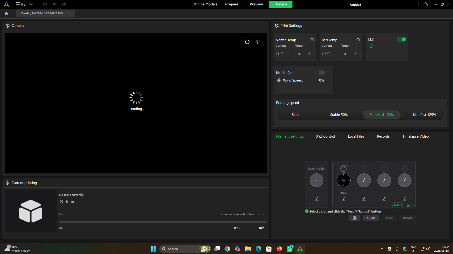

This new v1.1.0.72 firmware breaks the camera feed in Creality Print 7.1.1.4472 on Windows.
Been waiting for that loading thing to stop loading for hours now.
Works fine in Creality Print on Linux and works fine in streaming at http://creality.hi.ip.here:8000 so its the Windows connection in the new firmware that’s buggy.
I tested by rolling back to v1.1.0.65 and all is good in that firmware, but this new one sucks.
Edit > Just incase anyone has a snarky suggesting I close the application and reopen it again, I tried that like 10 times already. :rofl:

yeap confirmed here too, 1.1.0.72 breaks camera on windows

Lost my camera to. any fixes besides rolling back fw?

Yup it broke the camera in Creality Print! Can still see the camera in the Creality Cloud app though. I had to downgrade to fix everything.

For my, only broke the camera on Creality Print (Can’t see it), on cloud works well… print works, commands works too…

Ya it brooke my camera connection as well. just sits there spinning and loading.

Been watching this thread for a while. I updated mine, tested, validated that camera not working in Windows. Downloaded .65, reloaded and moved on with life.
