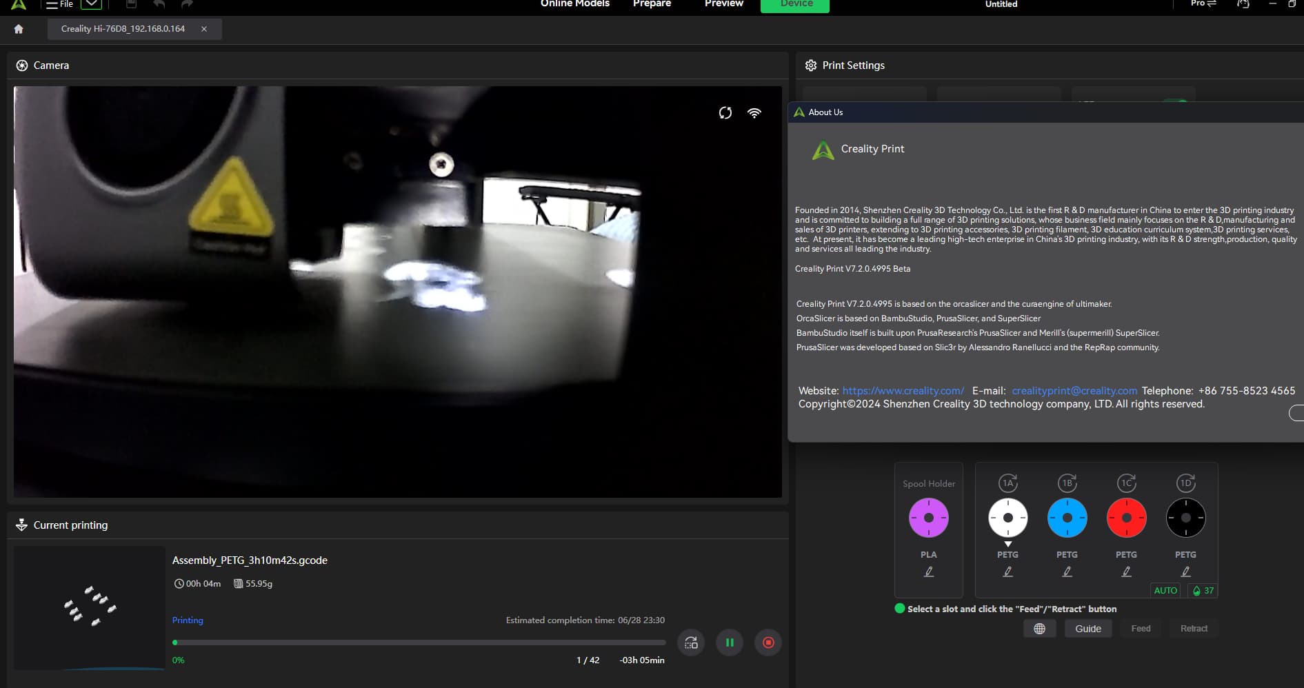

I can’t get my nebular camera working with the old firmware, or from Fluidd. Any tips on things I could check?
Blurry picture or no picture at all?

Immediately after installing firmware V1.1.0.72 through the OTA update, the printer developed several problems that all began at the same time:
The camera no longer functions. In Creality Print, the camera window remains on “Loading…” indefinitely.
The CFS no longer performs its normal startup load/retract sequence when the printer is powered on.
Every completed print ends with error FR2849: “Filament cannot be returned to CFS.”
Because all three problems appeared immediately after the firmware update, I believe they are related to the firmware rather than three separate hardware failures.
The printer was operating correctly before updating to V1.1.0.72.

Hi!
After reading through all the comments, I realized that the actual problem lies with the Windows version of Creality Print. What I did was install the latest version—including the 7.2 beta—and also installed version 4212, where the camera feature was working perfectly.
I went into the program files, copied the “Web” folder from version 4212, and placed it into the 7.2 folder—and the camera started working again!
Since that folder only handles the printer’s remote control functions, I don’t think leaving it this way will cause any major issues.

New firmware came out, v1.1.0.73

none at all, just black
I get the notification on the panel right away with new firmware versions but only after a power cycle.
la camera fonctionne, pas de nouveau bug ?
100% working with the new 1.1.0.73 firmware yes on Windows and Linux Creality Prints. I also checked it with CrealityCloud and it is ok.
