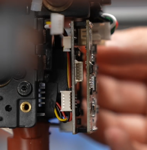

Can you post pictures of that printhead circuit board? Most of them that I have seen are 2 boards fastened together with a small space between
Of Course, I can do.
It seems to me that they have completely redesigned the K1C and absolutly ignored the CFS Upgrade Kit :frowning:
This is the Picture of my Head with the missing Connector (and missing PCB) on the red circled area.
This seems to be a completely different structure.
And this is from the install Video from Creality

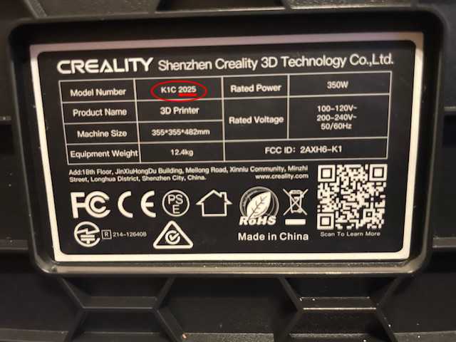

In addition, can you provide a picture of the printer’s nameplate so that we can further check whether there is a K1C 2025 model? If it is not marked, we will report it to the technical department for further analysis.
How are you supposed to know that the K1C and K1C 2025 models are different? When I bought the printer, I thought it simply indicated the year of manufacture, not that there were any differences.

You can Check if you are own a K1C 2025.
Take a look on the Nameplate on the backside, if it says “K1C 2025” under model number, then you’re out of luck. Then you can try to get them to take back the upgrade kit or resell it. With this model, multifilament printing will only be possible with the CFS-C. It’s also still uncertain when that will be released.
