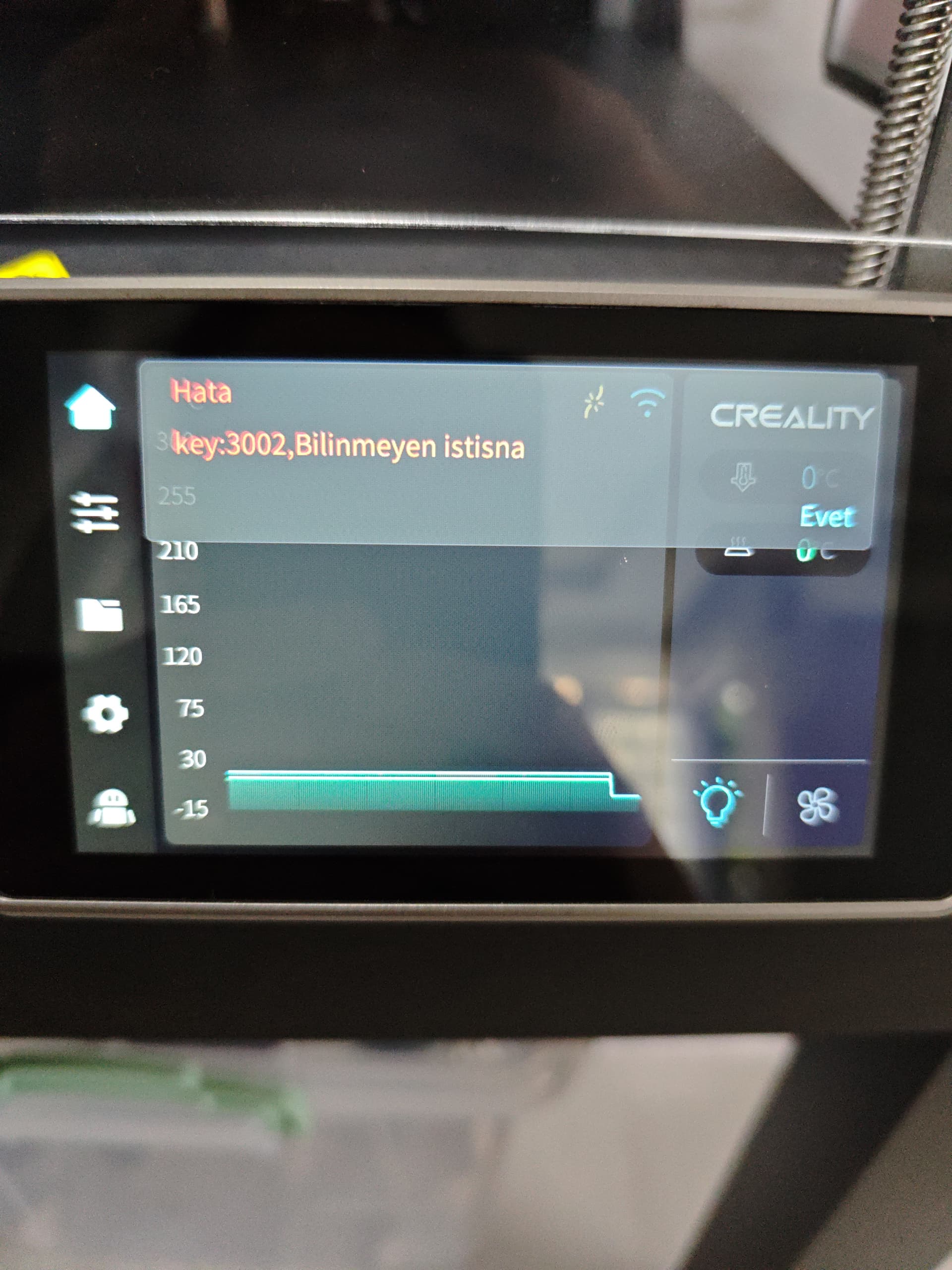

I first got a key 3002 error due to an update. Then I sent an email to Creality. I followed their instructions, and now my motherboard is bricked and it’s not fixing.

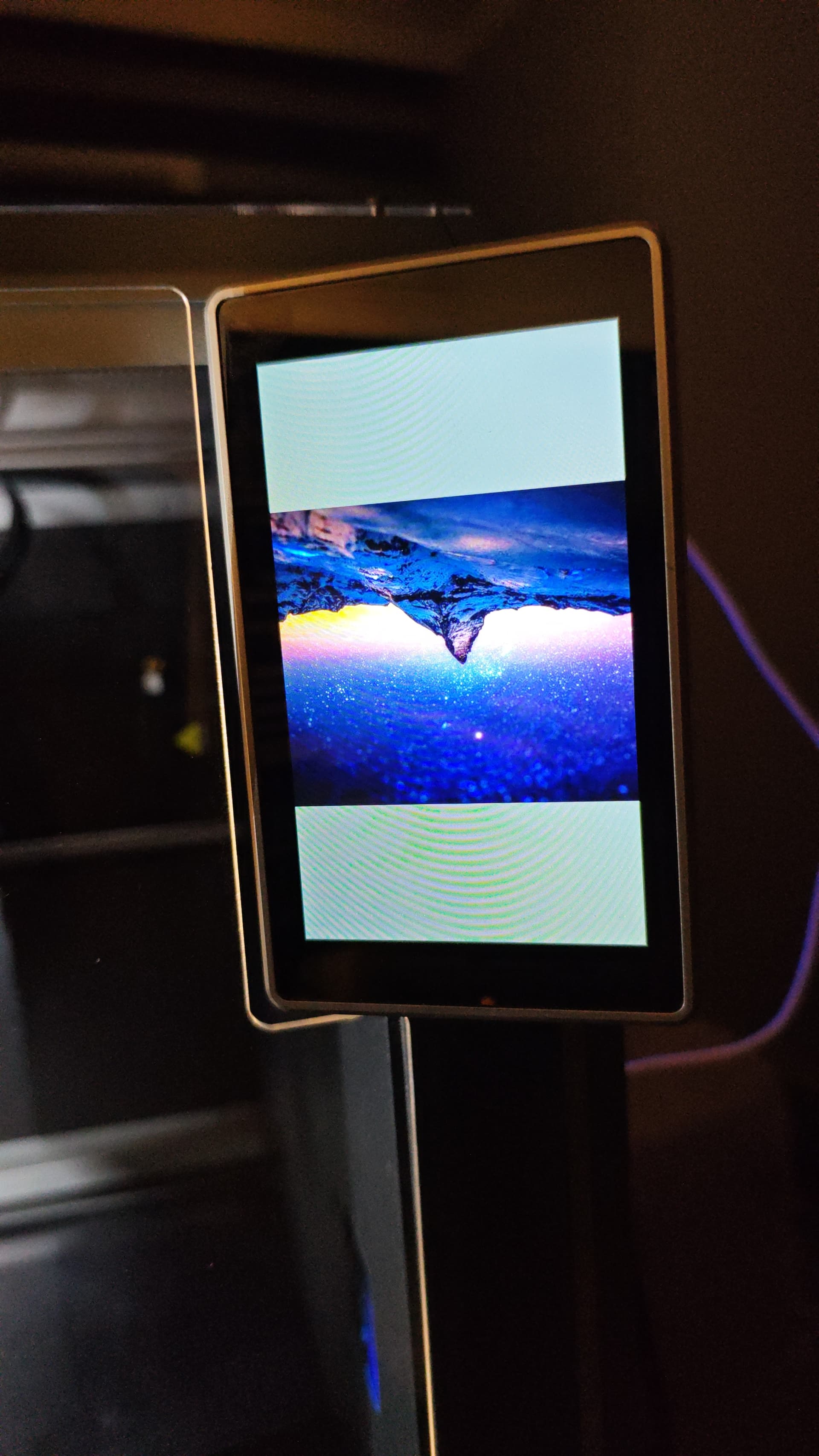

The motherboard ends with S12. I created the flash drive using the Imagine file as shown in the guide, but I’m confused about which operation to follow with the version you mentioned.

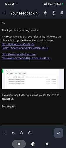

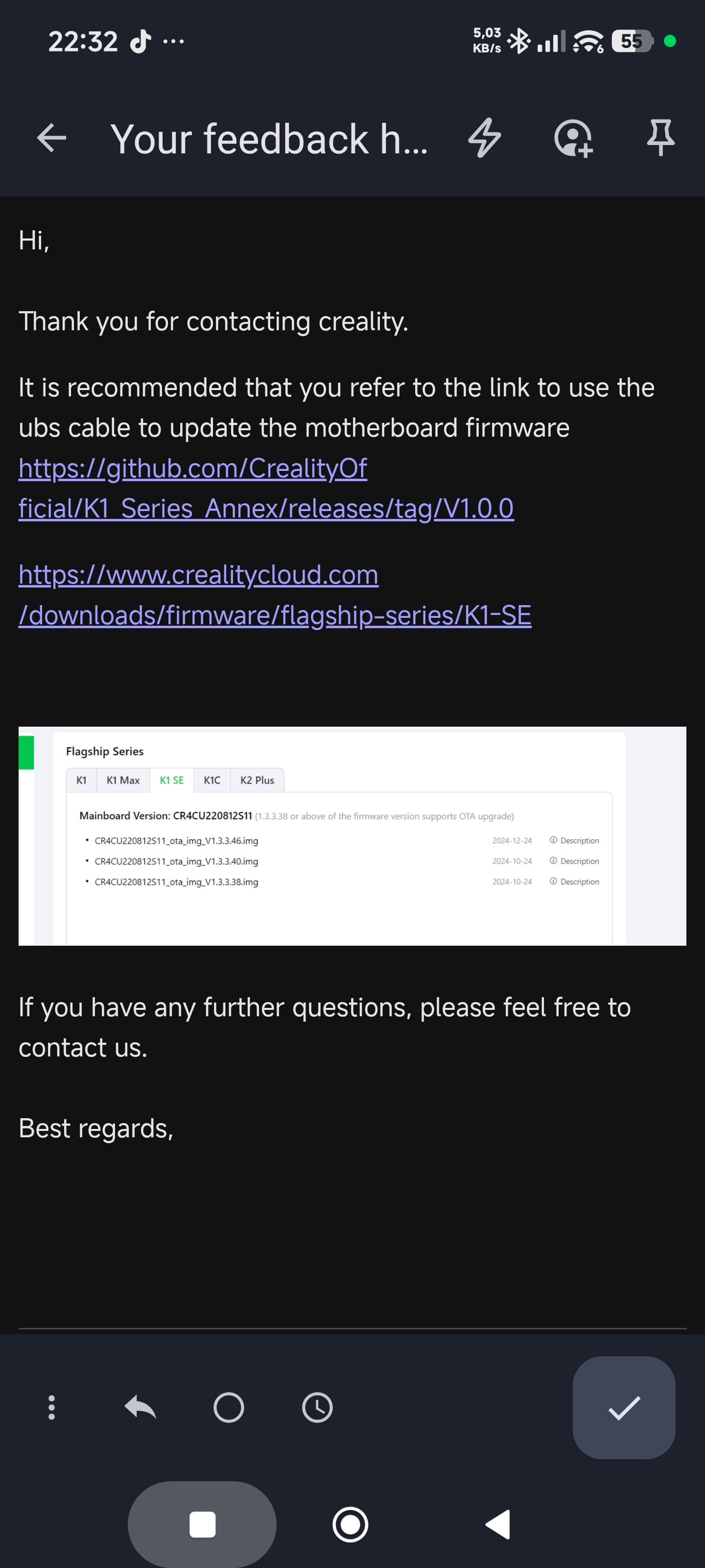

This is the latest email from Creality.

i’m sorry to hear the the board it’s definitively bricked, but second i read this is linux(klipper) not runing and just the bootloader are runing ,but you can do the same metod to put the CR4CU220812S11_ota_img_V1.3.3.46.img back again by usb cable . i think you just upload the wrong firmware the fist time. It’s in creality cloud site, session k1 SE as the link i left before above.
this is just a gess ,because i never tried this

I followed all the steps. CR4CU220812S11_ota_img_V1.3.3.46 into USB.i put the img for 1 hour, the device was the same. i still have the mountain photo.
revert how? if the printer don’t accept the previous version by usb stick.
