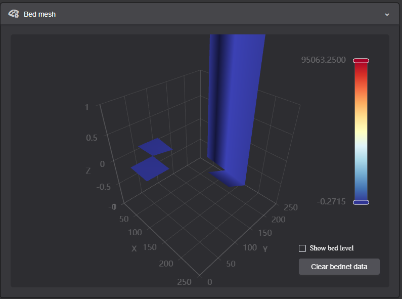

In my case not only the camera stopped working, also had the weird bedmesh and could also not see the files on the printer. Solved by rolling back the firmware version to V1.3.3.46.

All is back to normal, camera and files are visible again and able to trigger prints from OrcaSlicer again. proper bedmesh has also been restored.
