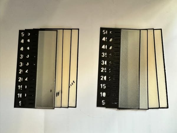

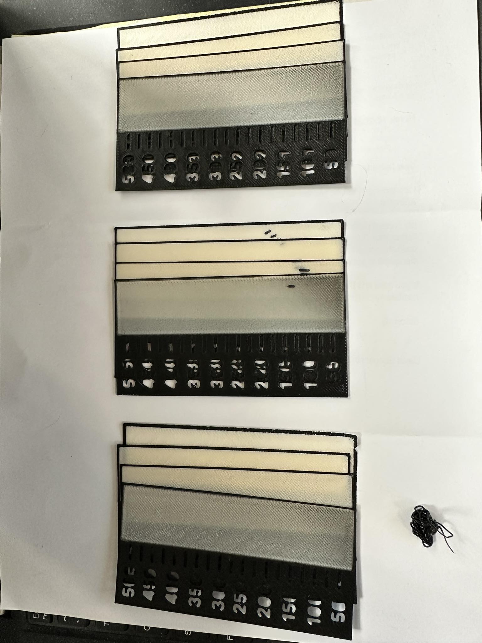

I then printed 4 calibration strips at one time with flushing volume set to zero to see how much should be flushed. Looks like right around 1000. So 906 should’ve been perfect.
I then set my flushing volume back to 906 and sliced it again. The print turned out exactly like the first and there was no purge in my bin going from black to skin, just one initial purge from skin to black and then one all black.

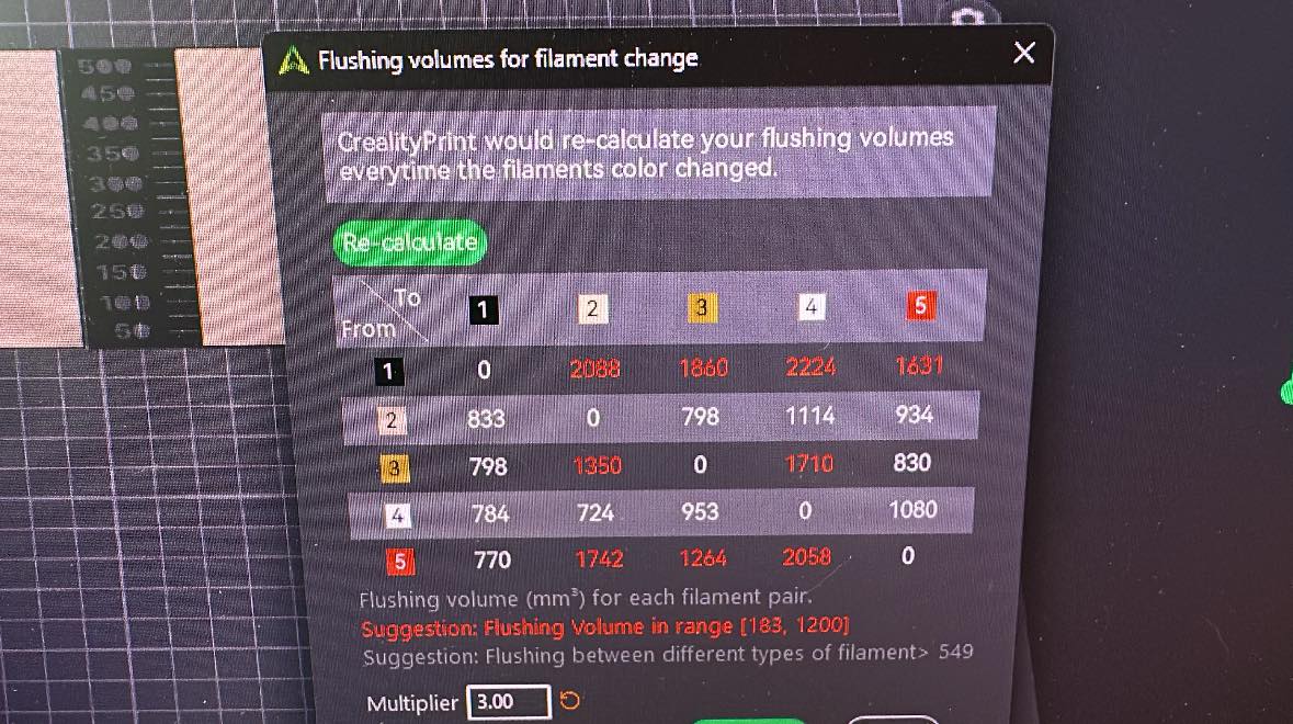

Also, what does the text mean in the flushing volume box that says “CrealityPrint would re-calculate your flushing volumes everytime the filament color changed”? I don’t want it to recalculate. I want it to do what I told it to do.

I have an Ender 3 V3 plus, but I think the Creality print is the same. Based on the two attached pictures, find the wipe tower parameters and increase it from the default 15 until it is good. For me, for example, when changing from black to white, 100mm3 is enough, but you might need 600mm3, or 1000mm3 I don’t care what it calculates and when. This value must be set to the desired value in each filament profile. With me, you only see 1 color, but you have to set it for all 4 or 8.

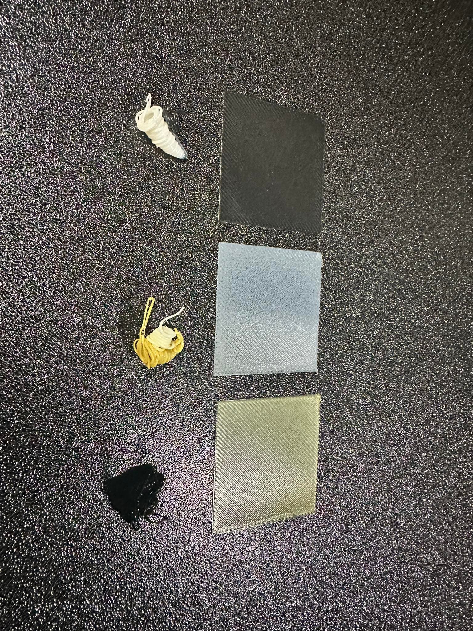

For the CFS it is supposed to all be set in the flushing volume settings. In the attached image you can see black to skin is over 2,000, but all it did was spit one little black purge blob out. It the other picture the middle is set to zero purge, but it still purges what was in the nozzle after the filament was cut, then the right set was 906 and the left set was 2,088. All three are identical and all three just had one small purge of black just like in the image.

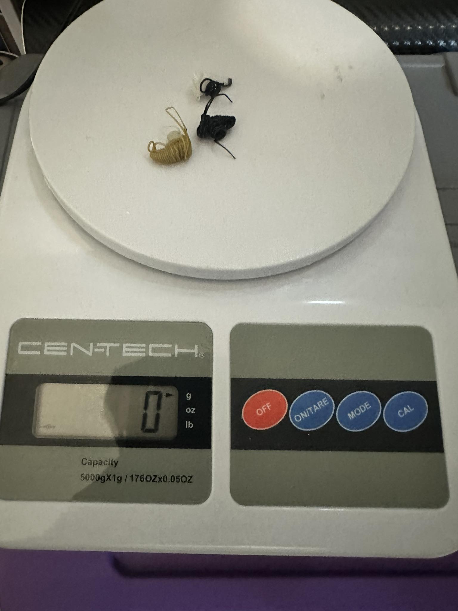

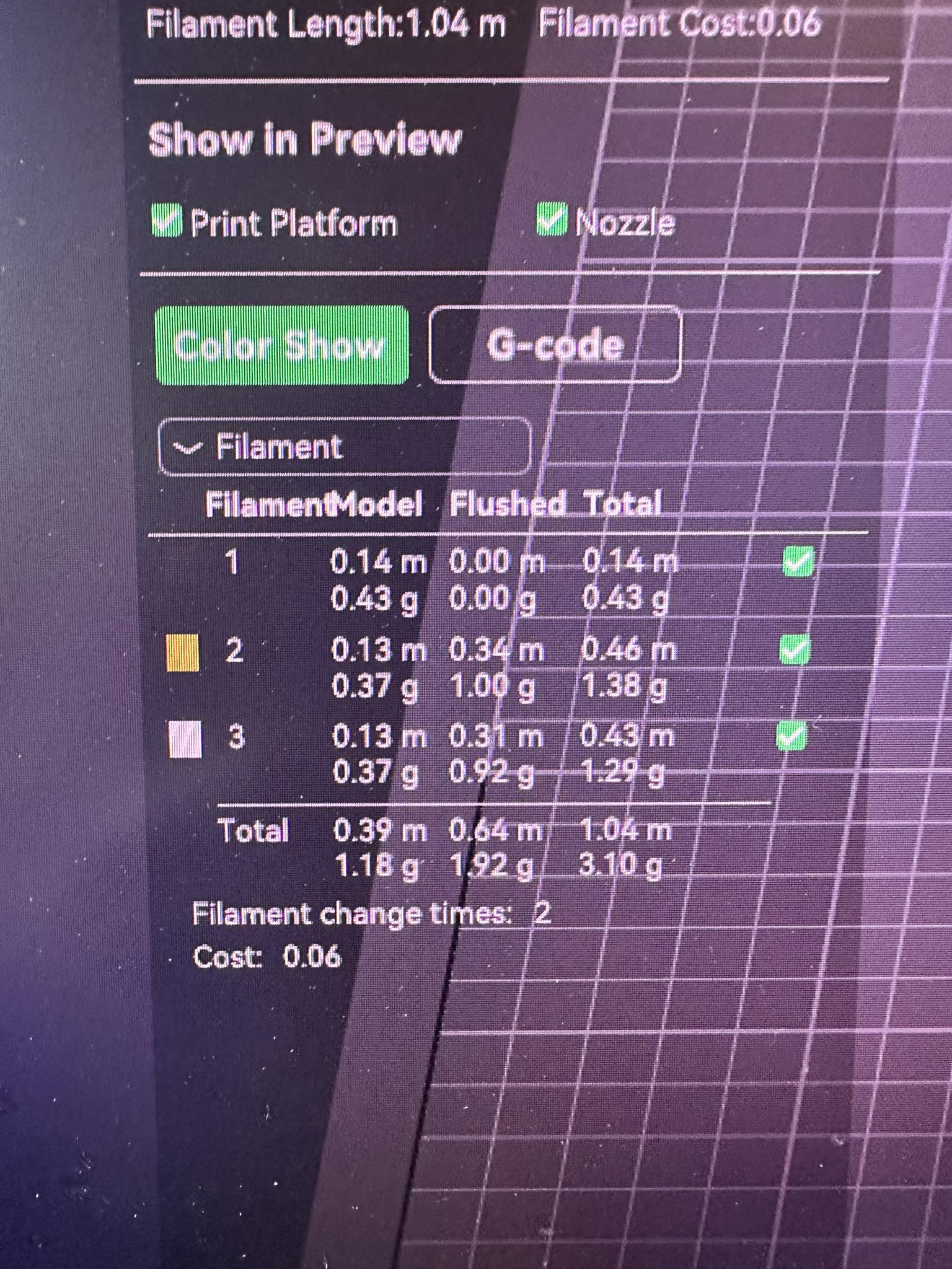

I then tried to print 3 squares. It was supposed to flush almost 2 grams of filament between the color changes. It did not even flush 1 gram. So now I have a printer with 2 CFS that are completely useless because I cannot print multi color.
