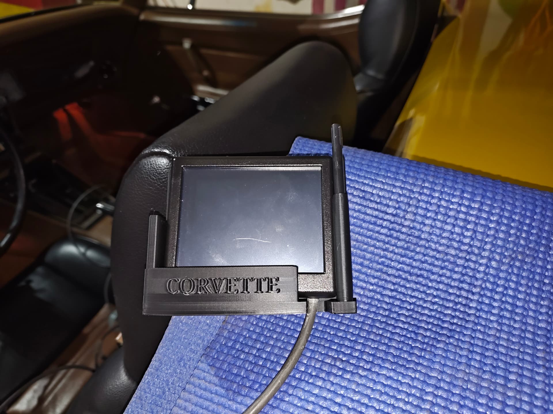

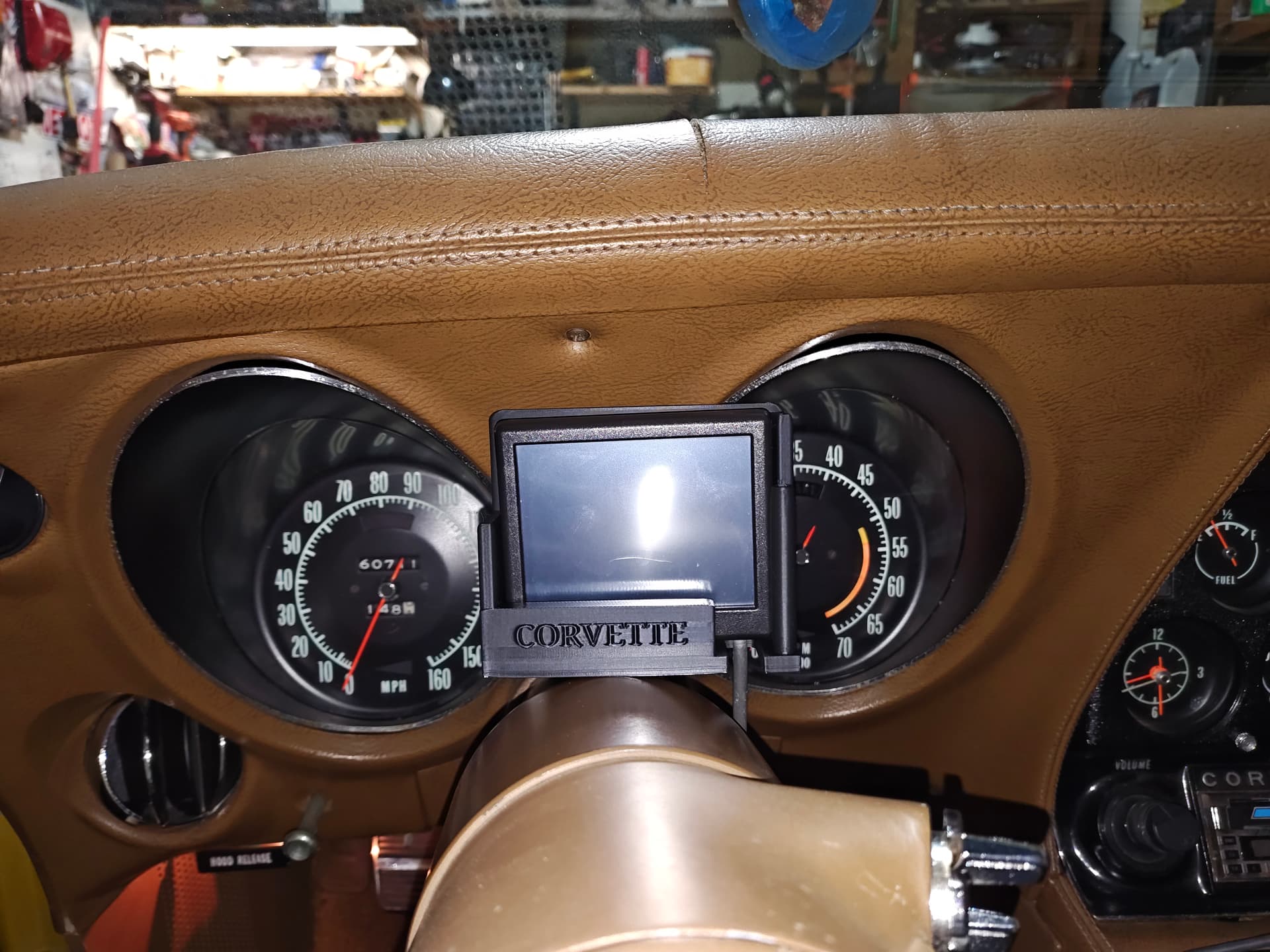

I’ve had some great success and some epic failures but it’s all part of the leaning curve. My biggest printing project is I’m creating a holder to use in my 1971 Corvette for the Holley 3.5 inch display that came with the fuel injection system I installed. This is close to the final version, I’m designing the clamp that will go around the steering column. Hopefully be done with this soon.

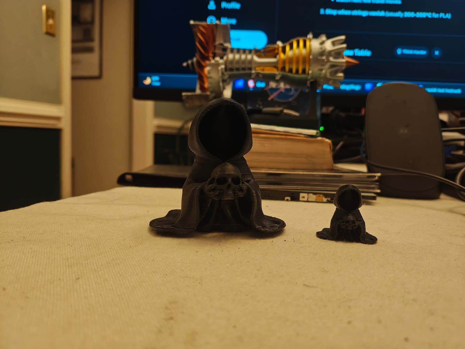

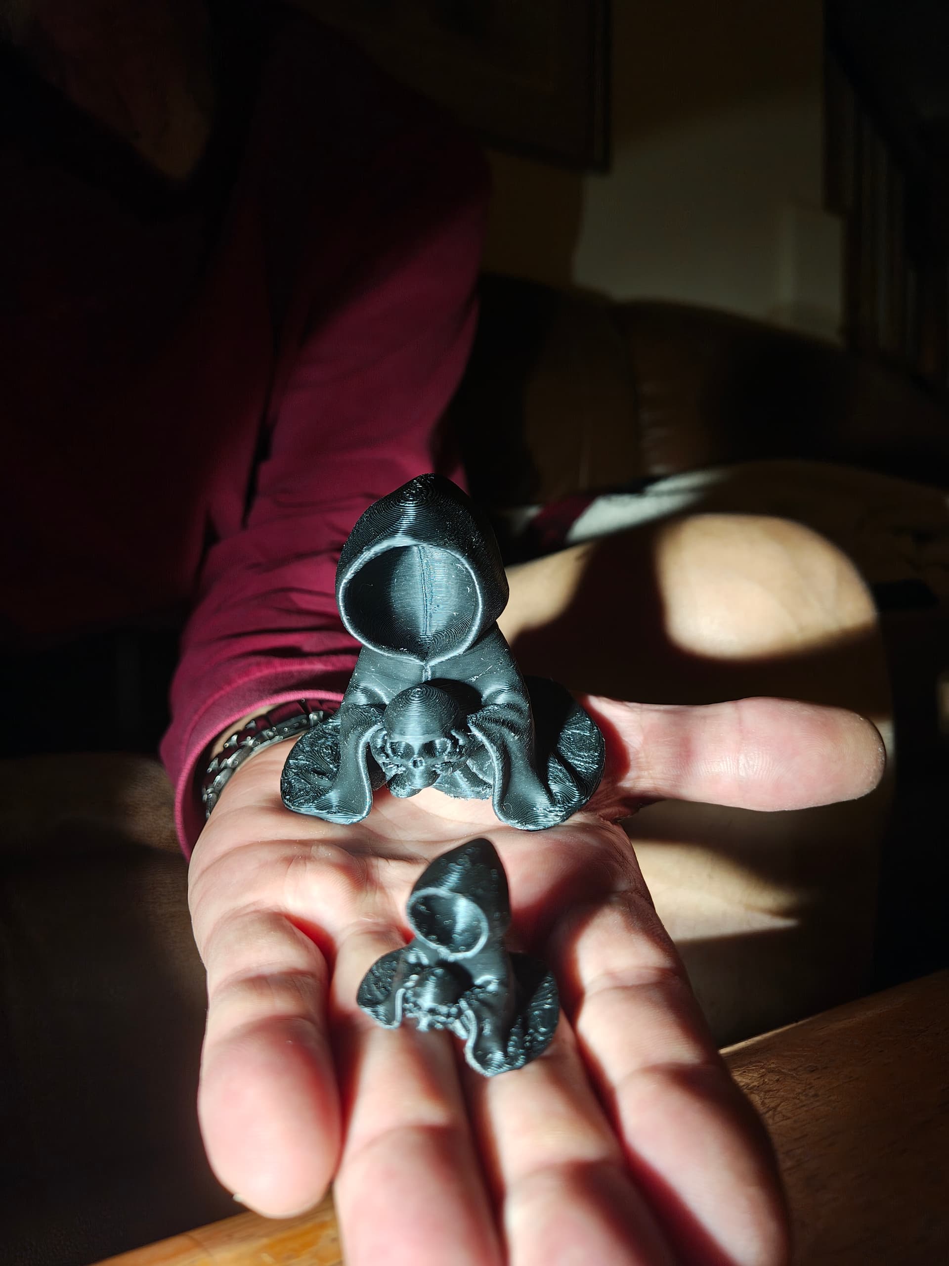

Failures tuned out to be mostly my fault. I started getting first layer issues and didn’t realize PLA (and most plastics) are hydroscopic. After a 5 day marathon of printing after getting my new KE setup my filament got too moist. Bought a drier and dried both rolls for 8 to 10 hours. Resumed printing yesterday with dried filament and everything worked fine. No print aborts!!
Printed this friendly monk. The little one I printed a few day ago before my adhesion issues. I tried to print him bigger but it kept failing. Today was a success:

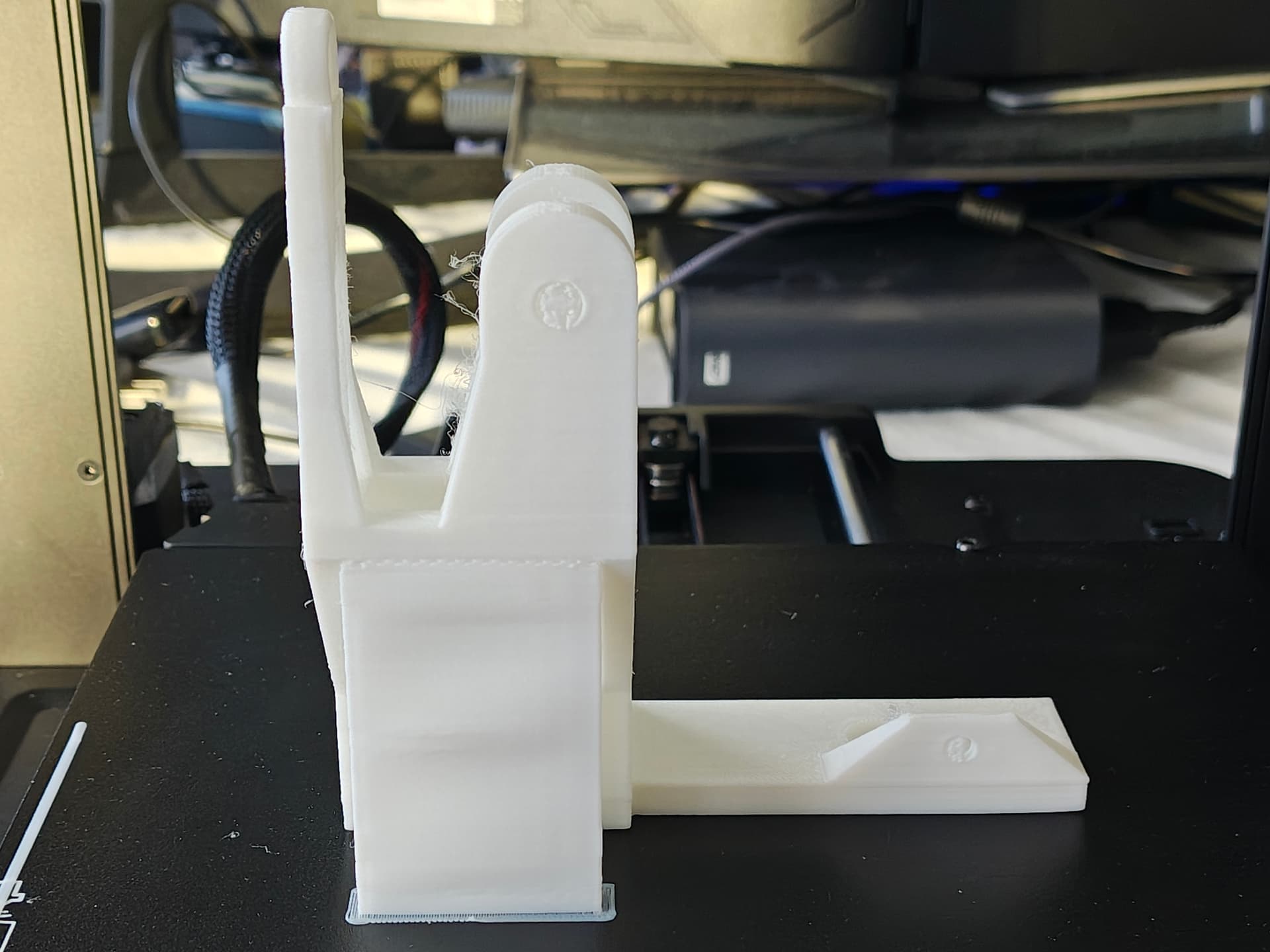

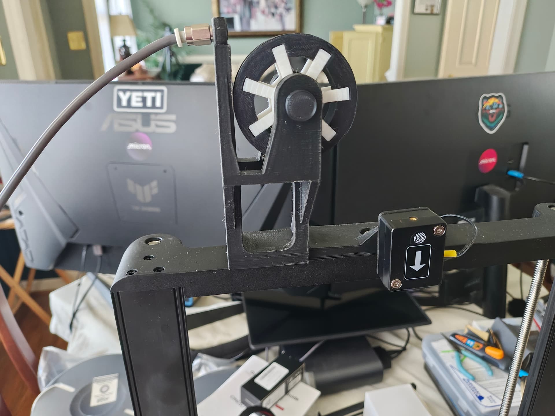

I also printed out a filament guide so I can print directly from my dryer. My first one broke because somehow when printing the filament got itself tangled and started picking up the dryer and snapped off the filament guide post. Opps. It was right in the middle of printing the monk. I thank Creality for the filament sensor as the monk was about 2/3rds done when this happened. This is the first version. The arm on the left is what broke. I then put the file in Tinkercad and beefed it up. I reprinted it in black (color I wanted it in anyway, my black was still in the dryer). Second one turned out fine.
