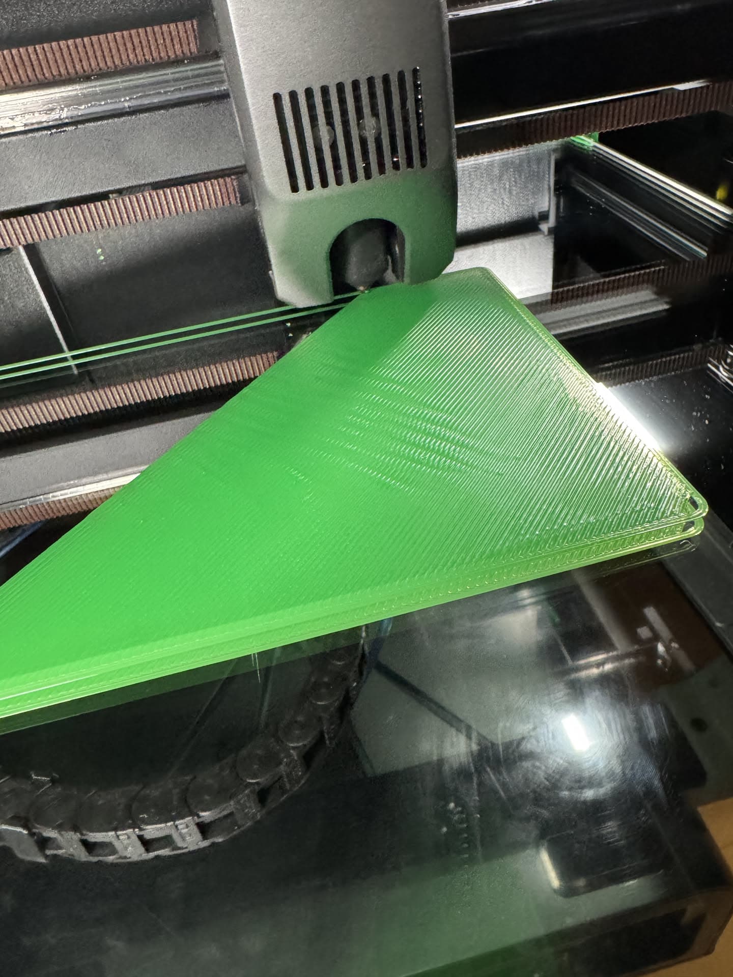

Print head scraping across surface of prints
Details
Printer: Creality K2 Plus + CFG
Filament: Creality CR-PETG
CFS Humidity: 5%
Print Surface: Mirror

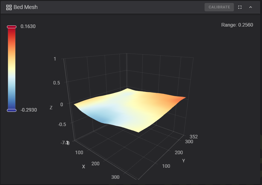

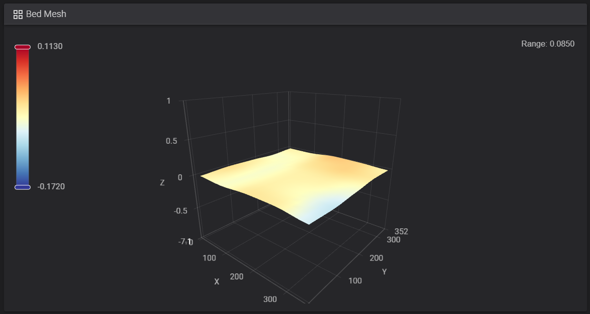

Bed Mesh Range: 0.2560
Bed Temperature: 70c
Nozzle Temperature: 250c
Nozzle Size: 0.6mm Hardened Steel (Creality)
Layer Height: 0.36mm
Line Width: 0.62mm
Z-Offset: 0.055
Z-Hop 0.5mm All Surfaces, Auto
Slicer: Creality Print V6.1.2.2458 Release
Slicer Profile: 0.36mm Standard@Creality K2 Plus 0.6 nozzle
Printer Profile: Creality K2 Plus 0.6 nozzle

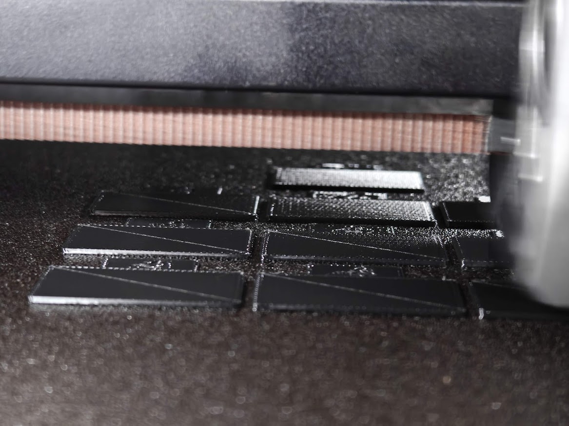

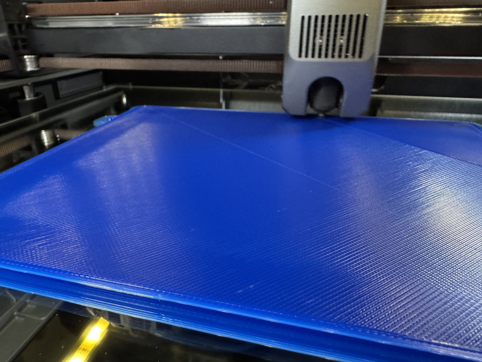

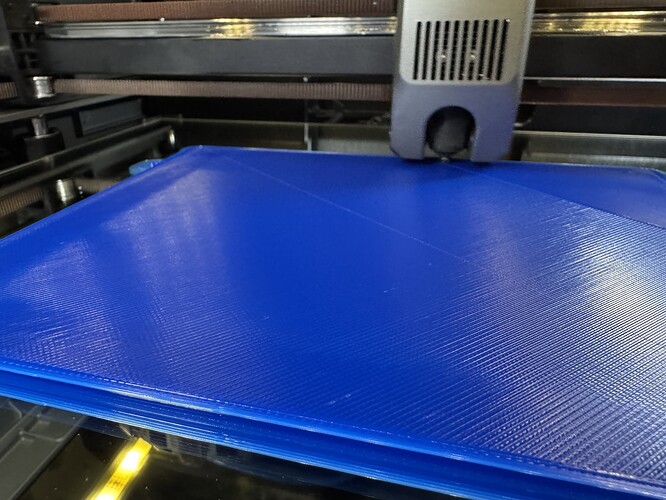

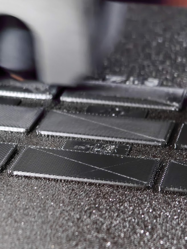

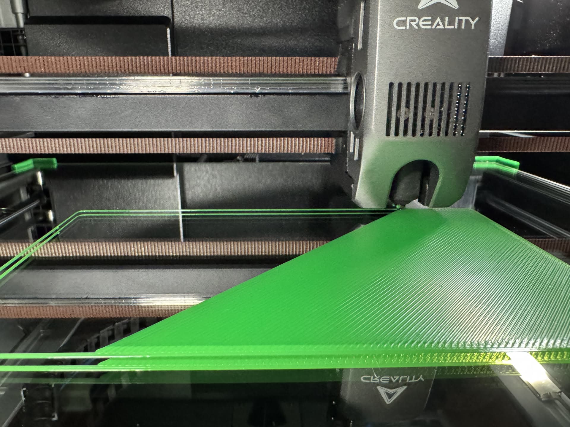

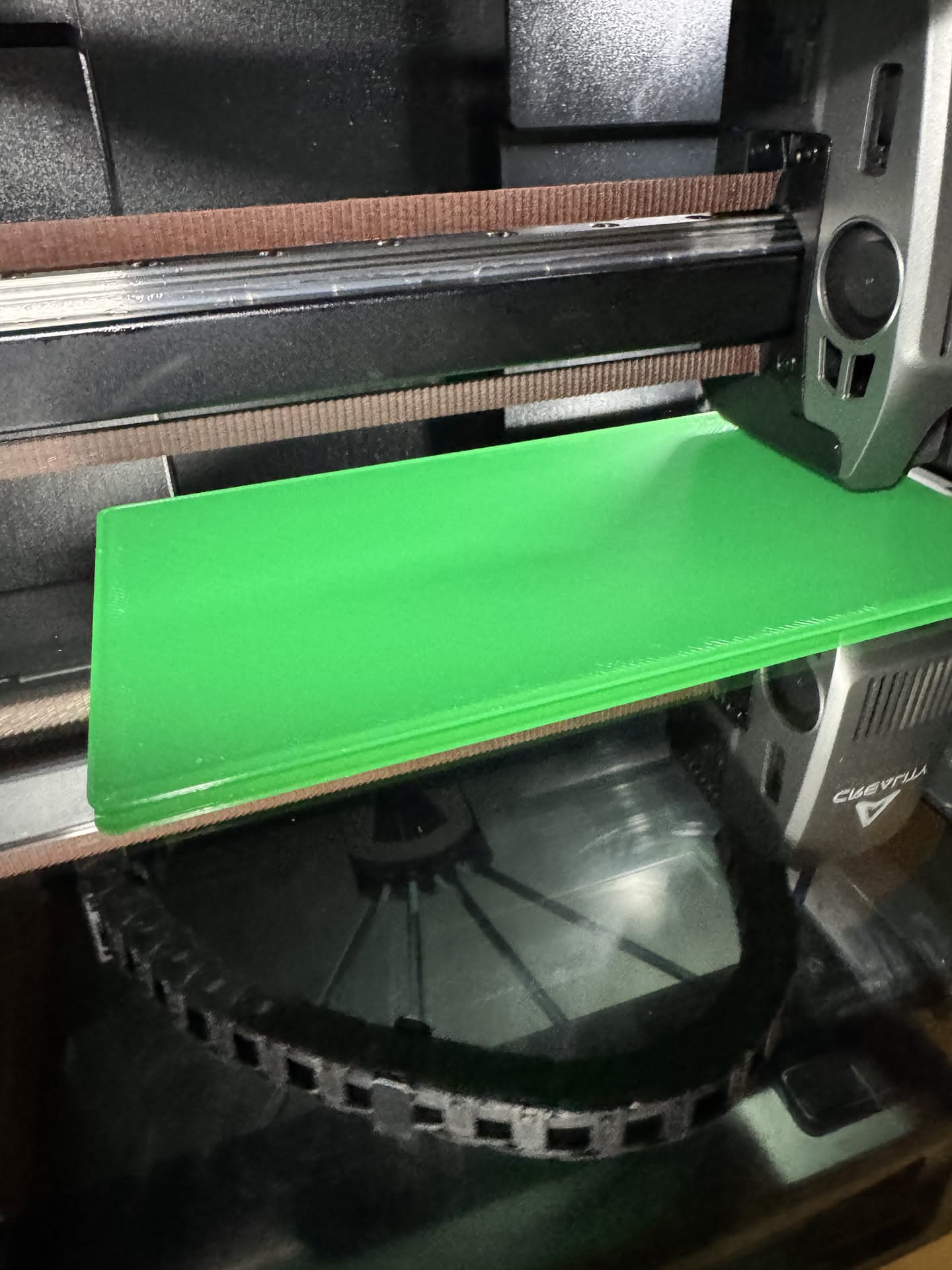

I’ve had the K2 Plus for about 2 months now and recently, the print head would scrape across the print surface after layers 2-3 (see below). I am using the default print profiles from Creality Print as they seem to work the best. I have done various tests with settings, fiddling with the Z-Offset, flow rates, speeds etc.
My first layers (with the above Z-Offset configuration), is near perfect. I have also managed to improve my bed level (see image below) by swapping it out for a mirror, going from a very warped 0.8+.

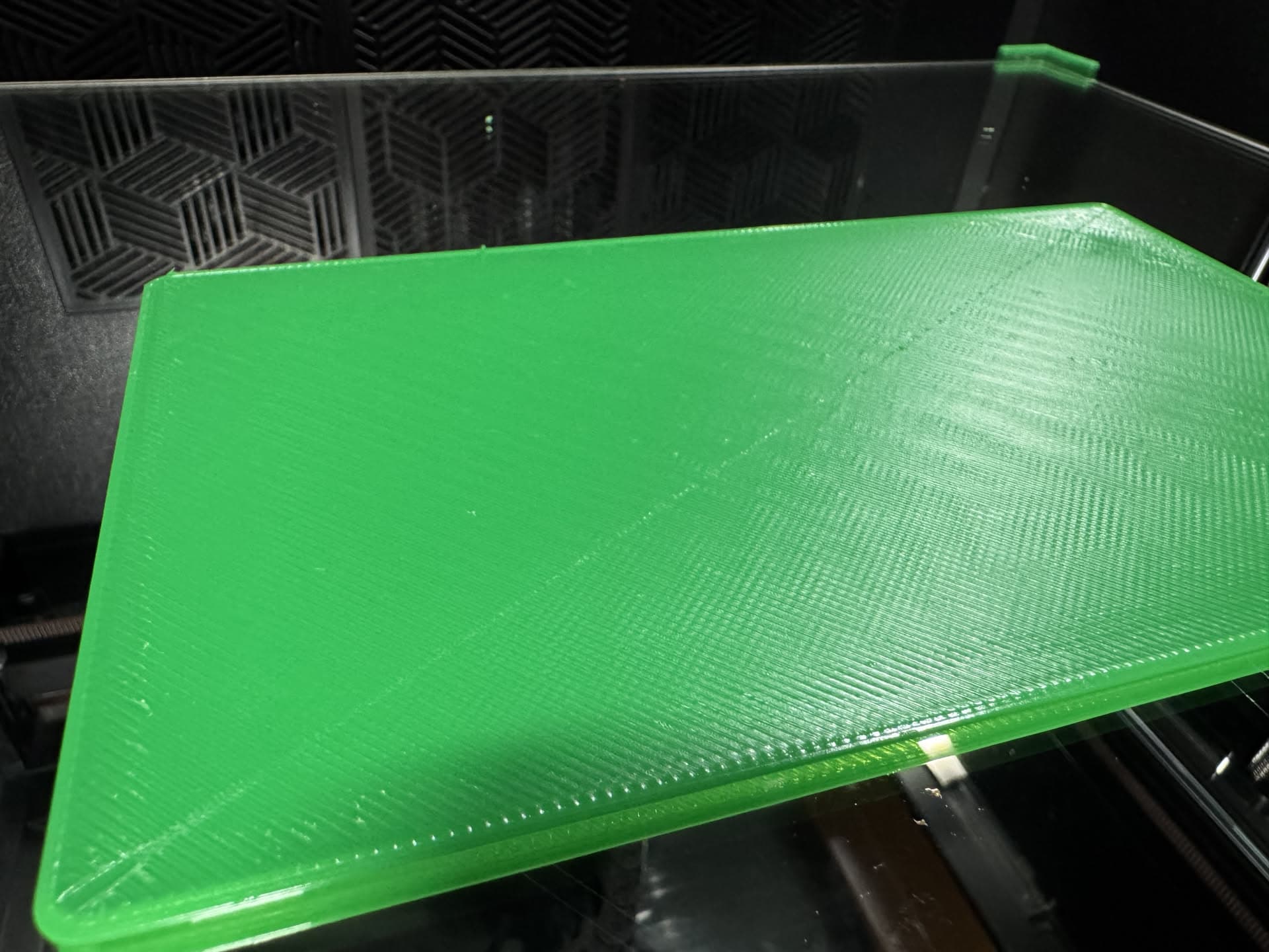

In the images below, you can see the scratch from the top left corner all the way to the bottom right corner (diagonal). This happens on all prints after about layer 2 onwards and stops at about layer 10’ish.
Here are some of the things I have tried over numerous prints:
  • Countless bed levels
  • Countless tweaks and configuration settings in Creality Print (from other blog posts and forums)
  • Numerous Z-Offset tweaks (ended with the above that seems to work the best)
  • Replaced the hot-end and heating block (twice)
  • Replaced the nozzle (stopped counting)
  • Numerous maintenance runs (from the Creality Youtube videos)
  • Added vibration feet to the printer
  • Wiggled (to check if it is loose) the extruded and tightened all screws
  • Tightened all the screws inside the case (I could find and that felt like it needed a good tightening)
  • Dried my filament (days)
  • Tried various rolls of filament (this issue persists regardless of filament type or brand as well as with the 0.4mm nozzles)
  • Fiddled with the fade configuration in Klipper printer.cfg (basically made no difference)
  • Ran all the calibrate options in Creality Print
  • Numerous Calibrate runs from the printer’s control panel
  • Do not cross walls had zero effect
  • Z-Hop various distances, types and distances - Sadly no effect.
  • Travel speed (slower made it worse and sometimes just ripped the print off the bed)
It almost feels like this is not a Z(offset/hop) issue as it only does this when it travels from one corner of a print to the opposite corner of the print.
Apart from this horrible scratching thing, this printer is amazing! Really good quality, stability and performance which motivates me to rather fix this one issue.
Anyone have any ideas on what else I can try?

  • I am currently busy experimenting with the “Travel” speed. CP’s default for this printer is 500.
    • Higher speeds (>500) = deeper cuts
    • Lower speeds (<500) = shallower cuts but more ooze (naturally)
  • Higher z-offset = less cuts, but worse line quality
  • Increased my probe density from 9,9 to 13,13 and probe distance from 5 to 2 and speed from 100 to 500 (so that my ABLs are much (much) faster) = cuts are not as frequent and now only shows up from layer 4 - 5 onwards. This however is contradicting the bed level as this is even happening on a 0,08 range with the Mirror
I will update here as I discover more things!

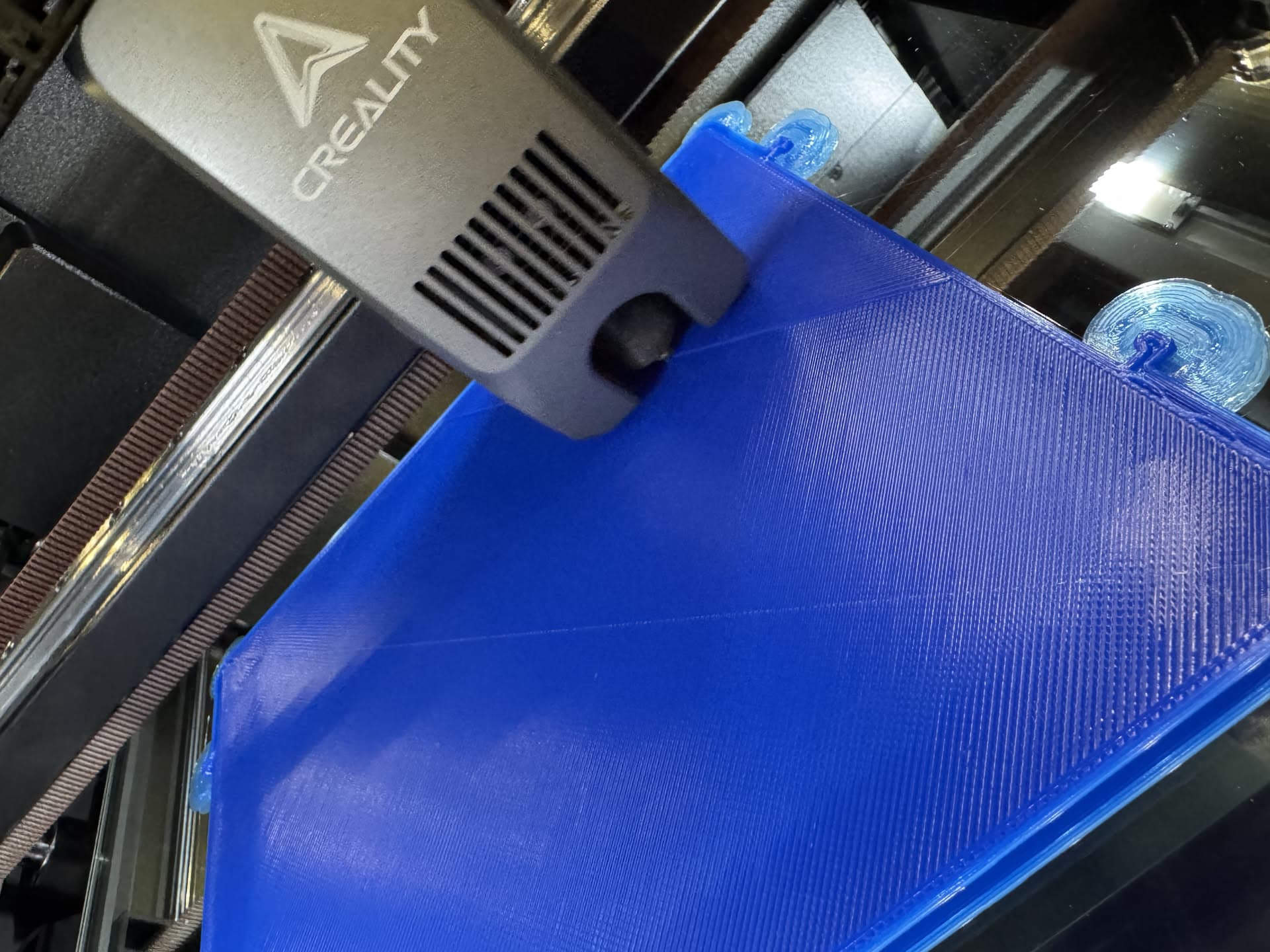

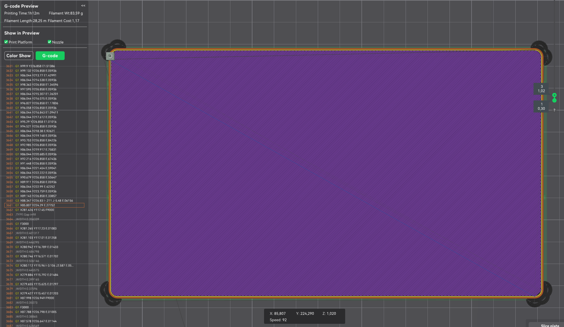

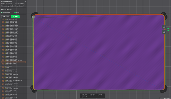

In the screenshot (I hope it is visible), highlighted is 3661 G1 X85… The scrape happens when it moves to 3662 G1 X85 (the blue diagonal line). There is no z-lift happening there. It looks like it is doing a gap infill there… Is it possible to prevent it from filling gaps that are directly opposite from the print? Thinking about it, it does not solve the original issue and I am now just working around the issue…
Quick update:
  • When disabling Gap Infill, the print head travels across the surface of the print diagonally drastically less, thus less scrapes. Side effect: You have these awkward gaps in the corners that are not filled in the same layer.
  • I can now confidently confirm that the z-lift actually works when it travels from one layer to the next.
  • I can now confidently confirm that the z-lift is not triggered on the same layer when moving back to the start to fill gaps and this is where it scrapes across the print.
With the above tests done I can now deduce the following:
  • z-lift works when switching layers
  • z-lift does not work when moving from the end of a layer to move to the start of the same layer to fill gaps.
Disabling Gap infill with the recommended z-lift settings from @Greg_McGee the scraping is completely gone, but with open gaps in the corners.
My testing is still on-going to figure out how to fill the gaps and prevent the scrapes :smile:

Quick update on my new learnings and resolution (for now)…
Orca Slicer
I was not able to replicate the issue with Orca slicer, using the default profiles for the filament as well as the printer, nozzle and layer height…
Two primary differences between Orca and Creality Print that I have noticed:
  • Orca’s default profiles uses: Gap Infill - Nowhere
  • Creality Print’s default profiles uses: Gap Infill - Everywhere
  • Orca’s default print startup includes a Home All sequence vs CP not doing this
Creality Print Default Profile
Noticeable waves and our all too familiar friend: The Scrape
Creality Print - No Gap Infill and Home All in start sequence
No waves, no scrapes :partying_face: :tada:
Startup GCode changes I’ve made:
M140 S0
M104 S0
G28 ; HOME ALL - THIS IS THE LINE I'VE ADDED
START_PRINT EXTRUDER_TEMP=[nozzle_temperature_initial_layer] BED_TEMP=[bed_temperature_initial_layer_single]
T[initial_no_support_extruder]
M104 S[nozzle_temperature_initial_layer]
M204 S2000
G1 Z3 F600
M83
G1 Y150 F12000
G1 X0 F12000
G1 Z0.2 F600
G1 X0 Y150 F6000
G1 E0.8 F300
G1 X0 Y0 E9 F{filament_max_volumetric_speed[initial_extruder]/0.3*60}
G1 X150 Y0 E9 F{filament_max_volumetric_speed[initial_extruder]/0.3*60}
G92 E0
G1 Z1 F600
I am continuing my debugging, but for now, this is my work-around. I have also set my Z-Offset back to 0. I think I am also going to stick to Orca Slicer for a short while, see if the issue comes back. For now, I am unable to replicate the issue in either Creality Print or Orca Slicer.
I will update here with more findings.
