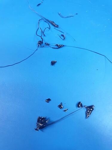

Have problems with the output on the printer, see pictures, and STL file, there seems to be blobs of plastic building up on the print head and about every 5 mins it breaks off. There is also a lot of fine strands of plastic being left about.
What files or config info if any can i U/L from the Slicer to help.

Calibrate your flowrate, I think it is too high which is why you are getting blobs. Might also be slightly damp or wrong temperature because there is some stringing.

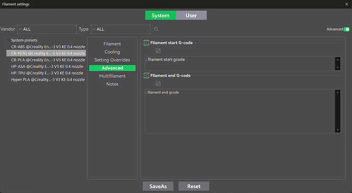

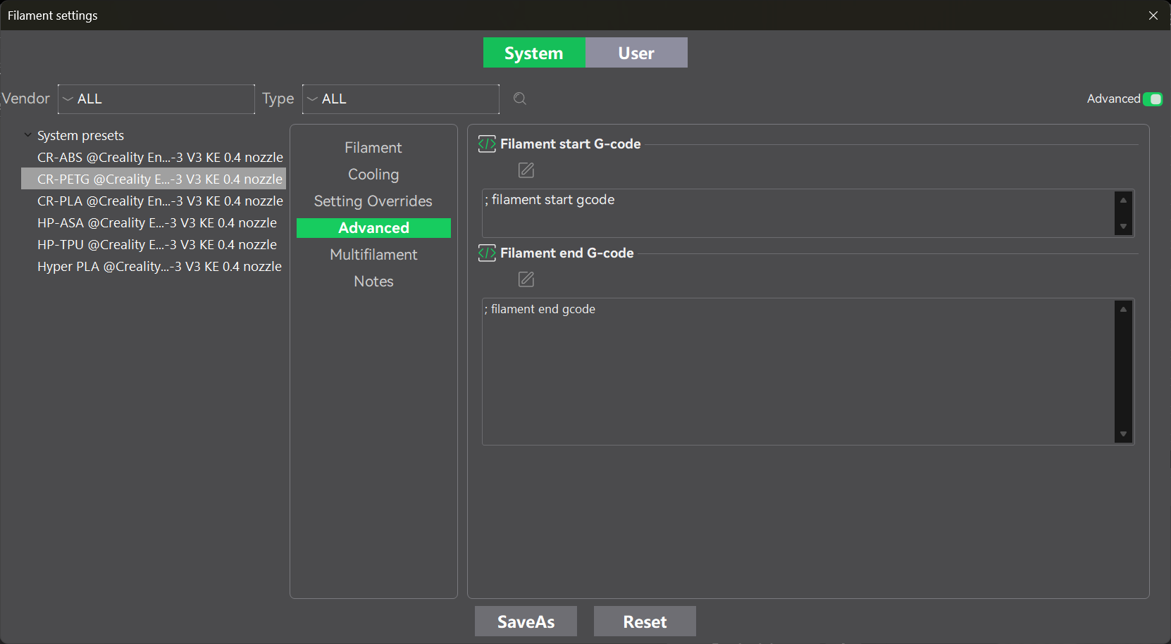

I think what i need to do is work out how to copy the header code from the good gcode file and add that to my gcode file so it does the same things prior to printing…Is there an easy way to set this up on the slicer or do i have to do it manually.
you can add start and end gcode to each filament, is that what you mean?
So far so good,
I added a command to do the bed leveling in 9 places, and i manually feed the plastic in at the start before it starts to print. There was still a bit of plastic strings and very small blobs, but it is working on the brim ok now.
