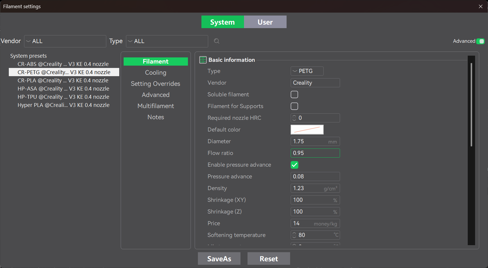

I went back to basics… first checked my filament type, and well its NOT PLA, its PETG.
So after changing that and seting the temps back to 240/65 I’m getting very good results, still have some minor stringing but i’ll do a test model to use and change some things bit by bit and see how that goes.
I’ll also print out the tower test that the Slicer can do to check the best temp to use.
I have also set my brim gap to 0mm, gives a better edge on the bottom.

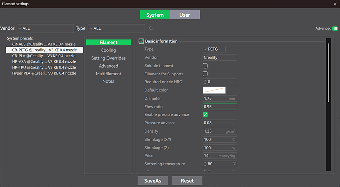

And set flow ratio to 0.95,
Z HOP retraction to Spiral
And added G29 : BLT to the Gcode in the Slicer now, so no more editing the Gcode file at the moment.

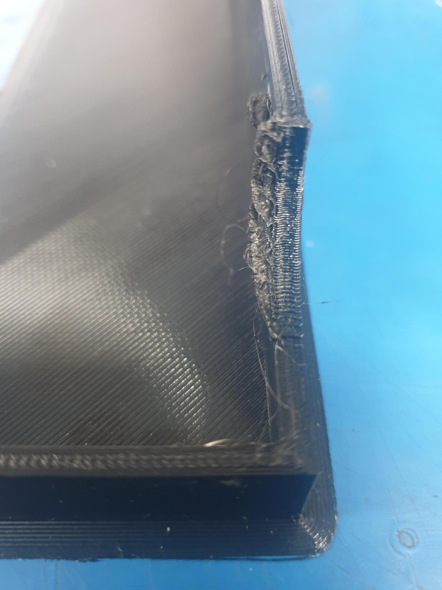

Back again, i tried to move my model to 90 degrees and for the most part it printed ok
Only some small issues now,

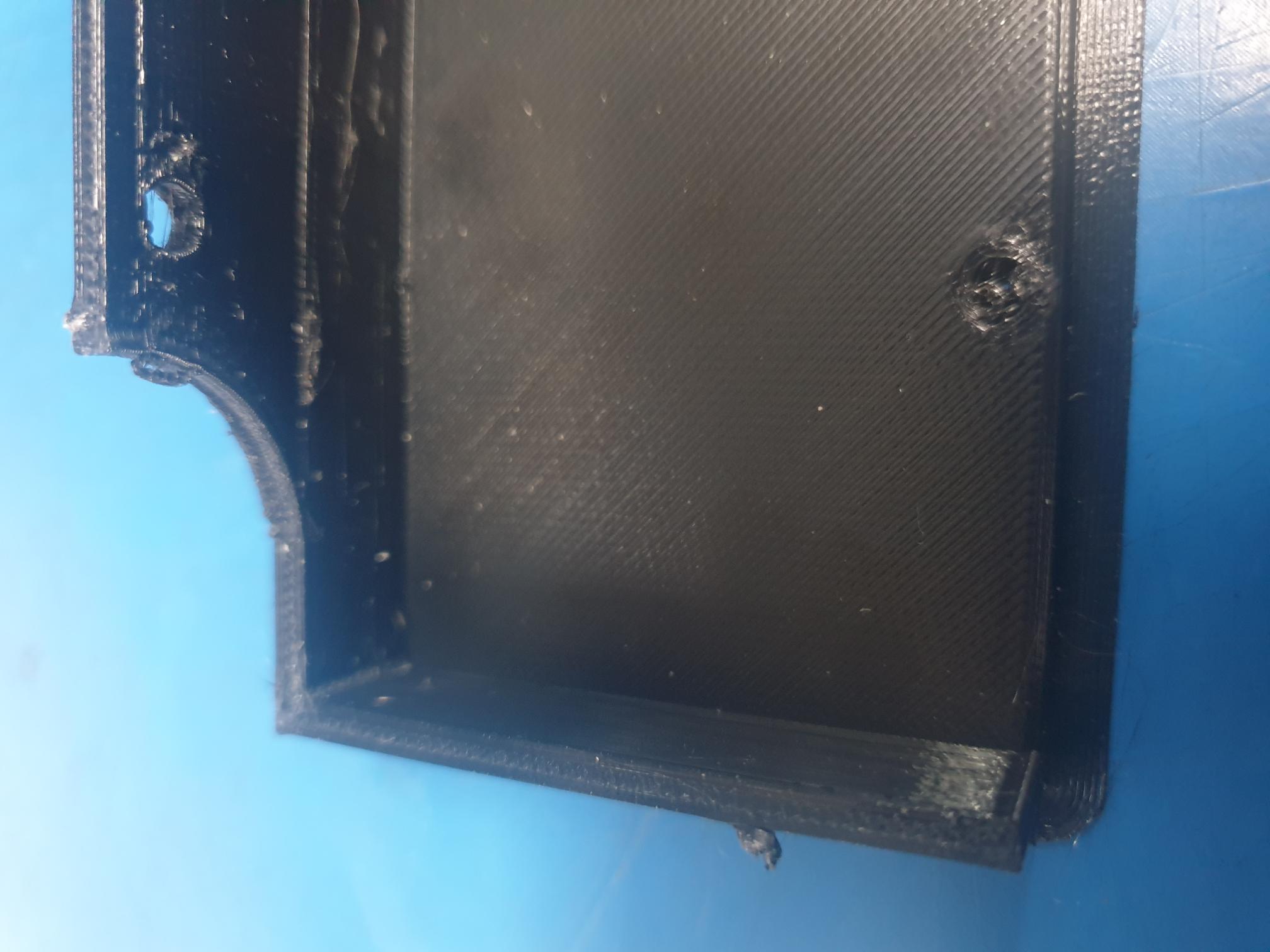

Were i have put the 2 fillets it looks like its getting a bit piled up on the rear end a lot but on the front end only a little.
The 2 holes flat on the bed should be 4mm diameter, but they are almost closed up
Very minor bits of stringing and 2 very small blobs.
Does anyone think i can improve on this, please let me know.

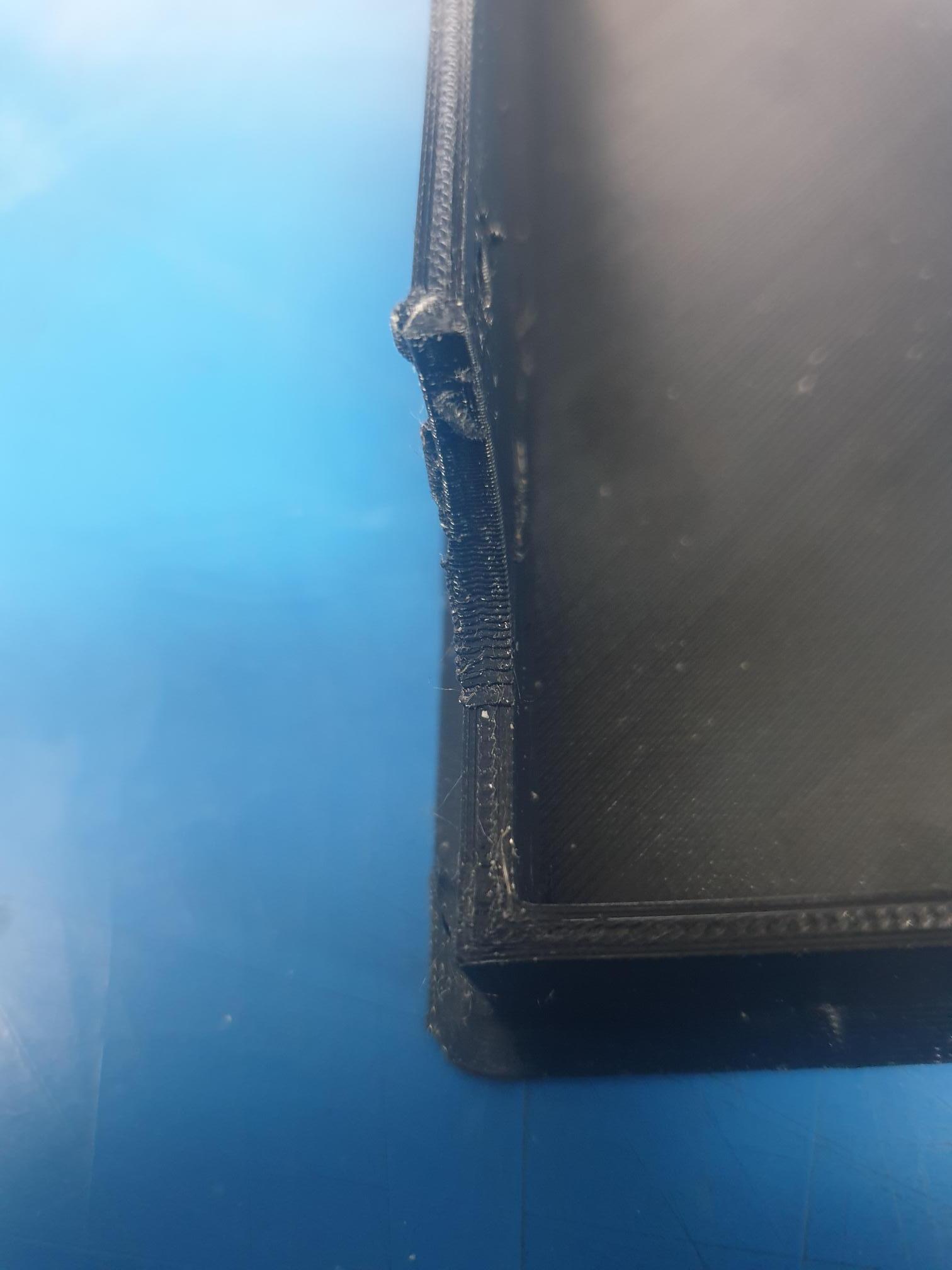

I just tried the test model, and i was getting these huge blobs at the ends of the models, they should be right angle rectangles…
When looking at the slicing colors i can see that it is the seem in that spot so i’m trying a random seem now…
Uploading: 20250417_072040.jpg…
Uploading: 20250417_072049.jpg…
Setting the Seem to random has helped.
