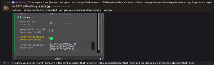

I have similar issue how to understand those values. I dont find any usefully documentation for those topic (parameter-tabs | Creality Wiki).
Here is the default value for “Print Speed Limit to Height”
[[100,150,100,6000,210],
[150,200,80,5500,200],
[200,230,60,5000,195],
[230,250,50,4000,190]]
How I understand from left to right inside each bracket:
  1. min Z altitude in mm (aka layer count multiplied by layer height),
  2. max Z altitude in mm (same as above like 1-2 is a range),
  3. Maybe this the speed limit in mm/s,
  4. Acceleration limit “mm/sec on 2nd square” (in V3 KE max 8000),
  5. Head Temperature limit in Celsius
But I also confused by “Acceleration Limit by Volume” similar as this one:
stated as “kg,mm/s2”
[[0.3,0.6,150,6000,200],
[0.61,0.9,100,5500,195],
[0.91,1.2,80,5000,190],
[1.21,1.5,60,4500,180],
[1.51,2.0,40,4000,170]]

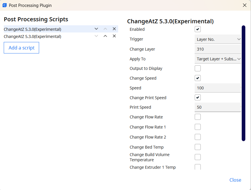

Cura has this option under “Extensions” > Post Processing> Modify G Code and as you can see it’s much more user friendly. The only issue I have with these other slicers is that there is no one click printing option. Slicing it, exporting it, importing it is so 2010s. :face_with_diagonal_mouth:

FYI
but no one seems to have profiles for different types of filaments..
