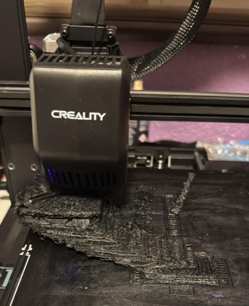

Hello, I had this issue since the beginning for some reason base layers are properly placed after that printer offsets the printing :
V3SE? Mine did that on later versions of Creality Print. What slicer are you running? It was ok on 4.3.8 but anything later I would get this. I cured it by changing the x/y axis stepper motor current to 0.75A from 0.6A, never had a problem since. Was easy for me to change as mine is running on Klipper, not sure how to do it on Marlin.
Yes sir V3SE, using Sharp3d for modeling and Print to 3D on a apple device (ipad)
I did mean which slicer program. Anyway is the printer still on Marlin?
yup Slicer its print to 3d: ‎Print To 3D on the App Store
I don’t know that app, I shall have to leave it to someone that knows that slicer. Have you tried the Apple version of Creality Print?
Did but could not transfer the resulting file to SD card
Update: tried the Crealty slicer but doesn’t print anything
