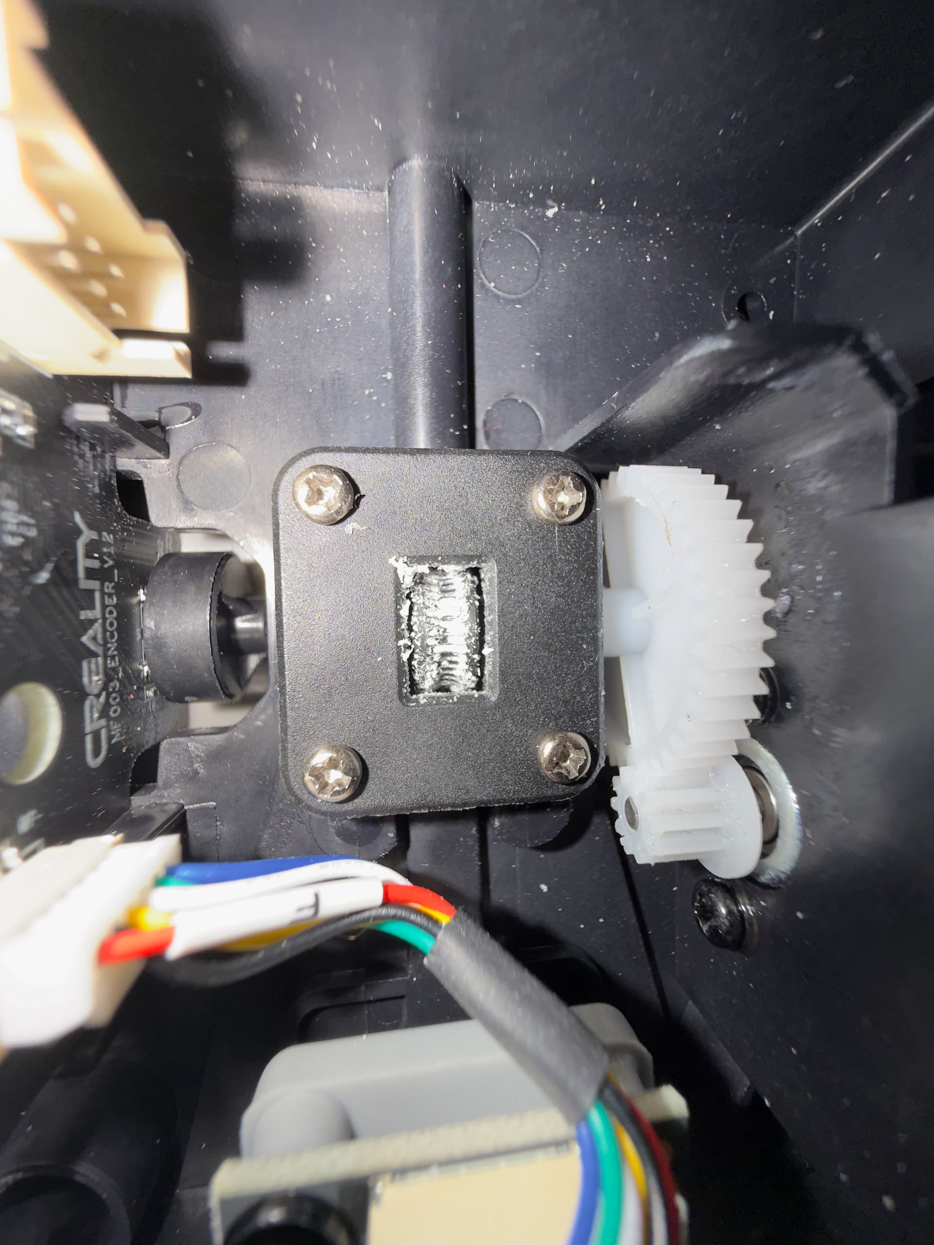

Hi, I‘m having trouble with my CFS. Initially everything worked OK but now I‘m having consistent trouble with my CFS. The CFS regularly gets stuck in combination with the message that the filament might be tangled. In such case the only thing I can do is to switch off the K2 Plus and then to switch it on again, only then I’m able to retract the filament. Having a look afterwards at the retracted filament it always shows the same strange picture of damage (see attached image). The damaged part is not at the beginning of the filament but roughly 2 meters from the beginning. That is more or less exactly the lenghts between the extruder and the 4-way hub at the bottom of the CFS, so I assume there is the source od the problem. The image is showing the position only where I have cut the filament. By the way, so far I‘m using Creality HyperPLA only, nothing else. I already have opened and cleaned the „4-way filament hub“ on the bottom of the CFS several times and it seems that afterwards the CFS starts working again but a bit later the problem starts to happen again. Meanwhile I‘m really desperated and have no clue anymore what to do. And I slowly start to regret having bought that printer… Spending more time for fixing things than being able to print cannot be the right approach, honestly…

I have the same problem with 2 of my CFS units. I tried everything to get them to work but have had no success. I have multiple K2’s also and tried on different printers, doesn’t work on any of them, so definitely the CFS. All my other CFS work flawlessly. The problem seems to be with the CFS not pausing to allow the extruder to start and begin pulling the filament. It keeps pushing and grinds the notch in the filament. You probably hear squeaking noises in the CFS when the filament reaches the extruder. All my other CFS stop pushing when the filament reaches the extruder and then the extruder takes over and pulls the filament, then the CFS feeds more as needed. I have sent an email to support to try to get them replaced.

The ptfe at the extruder twists when the filament arrives, forcing an angle of almost 100° and the filament is then blocked, the CFS motor forces and the cable is filed.
I didn’t get any relevant answer from the support, but I cut the 2 cm of ptfe that was twisting and the problem reappeared only once out of 40 hours of printing (and about thirty filament changes).

I’ve just changed the ptfe connected to the extruder for a ptfe with an inner diameter of 2.5 mm and an outer diameter of 4 mm (a ptfe I use with my MMU3 and also to connect my 2 CFS to the K2).
In testing, I found that the one supplied with the K2 offers more resistance when the filament passes through it.
I’ve just run a print and so far it’s working perfectly, wait and see.
I hope that works for you, I replaced every single piece of ptfe tubing in the cfs and the k2+ with the BBL tubing with the larger, 2.5mm, internal diameter and it has changed nothing, however I still think it was worthwhile as it should have eliminated or at least reduced one possible problem.

This is what happens after only one attempt to use the CFS after previously cleaning everything.
As can be seen the gear in there is stripping the filament. This happens after the retraction causes the filament to get stuck and then on the next attempted feed this happens.
I’m hoping that Creality Support have a permanent solution, we shall see.
For feedback, my 2 CFS have been working correctly since the ptfe change.

Hi everyone! I had the same problem with my 2 CFs – they worked great at first, then suddenly started grinding filament! :tired_face: I saw that early video and tried cutting the spring, but that didn’t help. So I increased the spring tension by adding washers where the spring sits, and now my CFs are printing normally again! :raised_hands: Hope this works for you guys! #3DPrinting filament cfs #ProblemSolved #Fix #Printing
