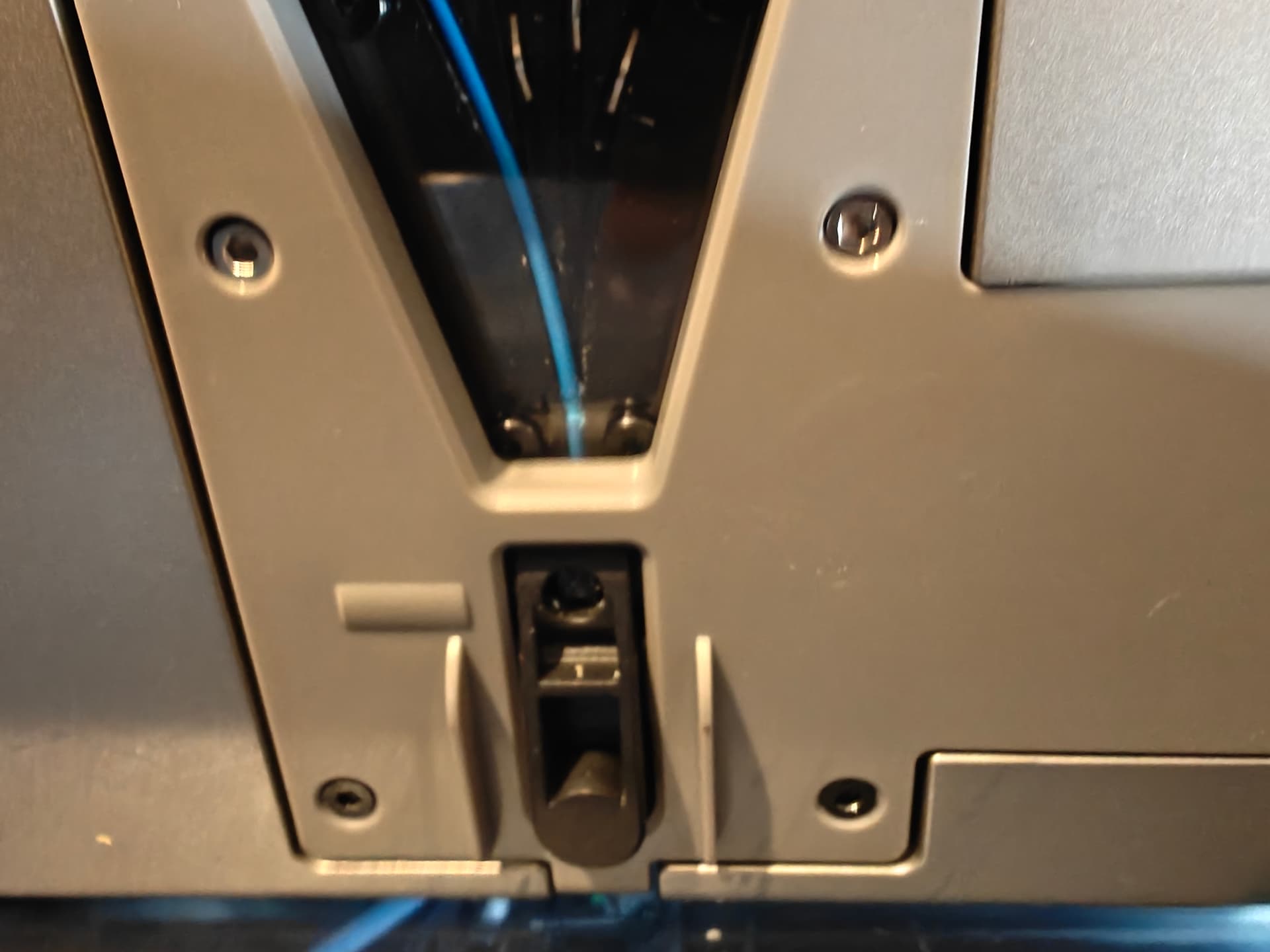

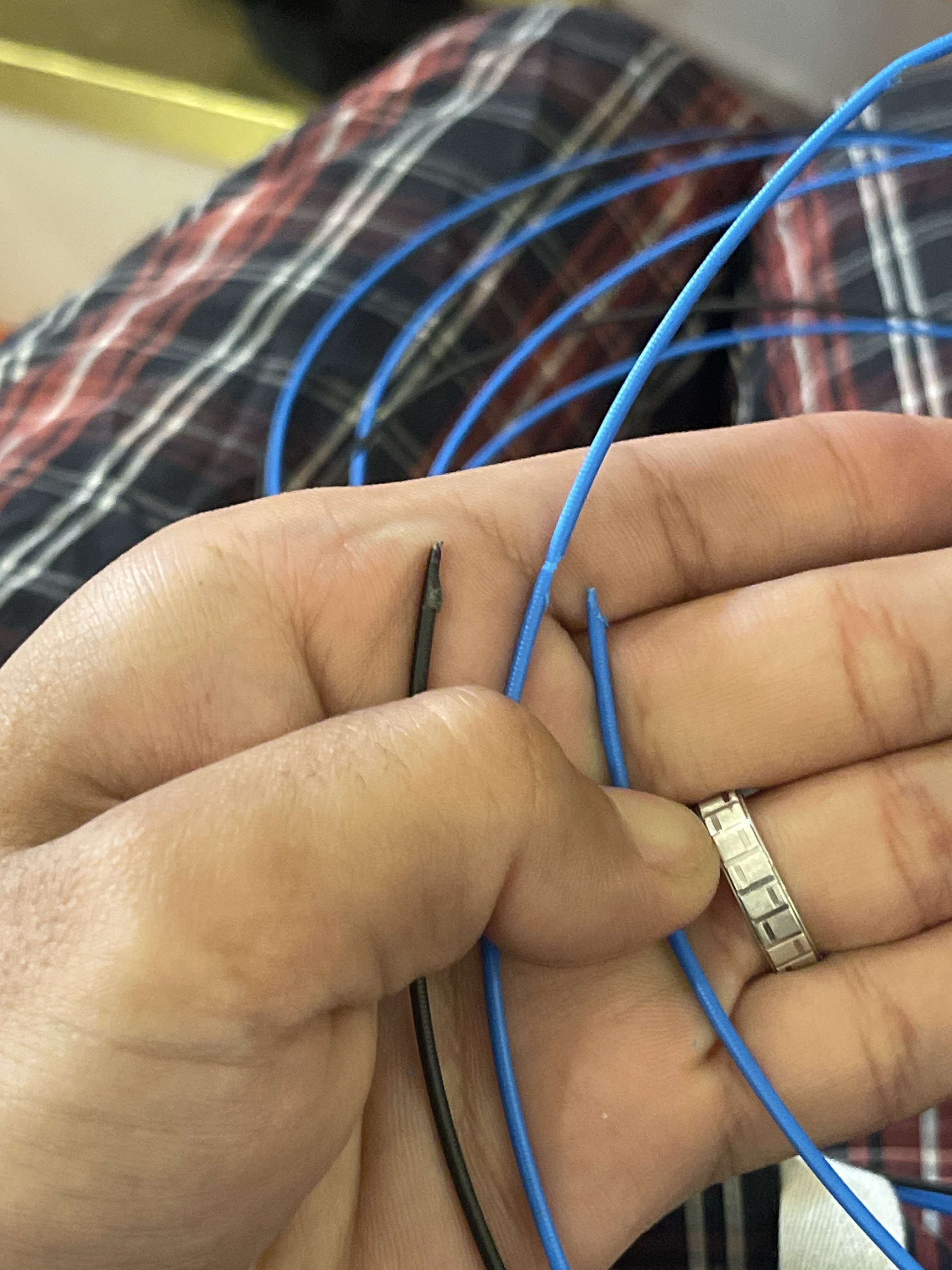

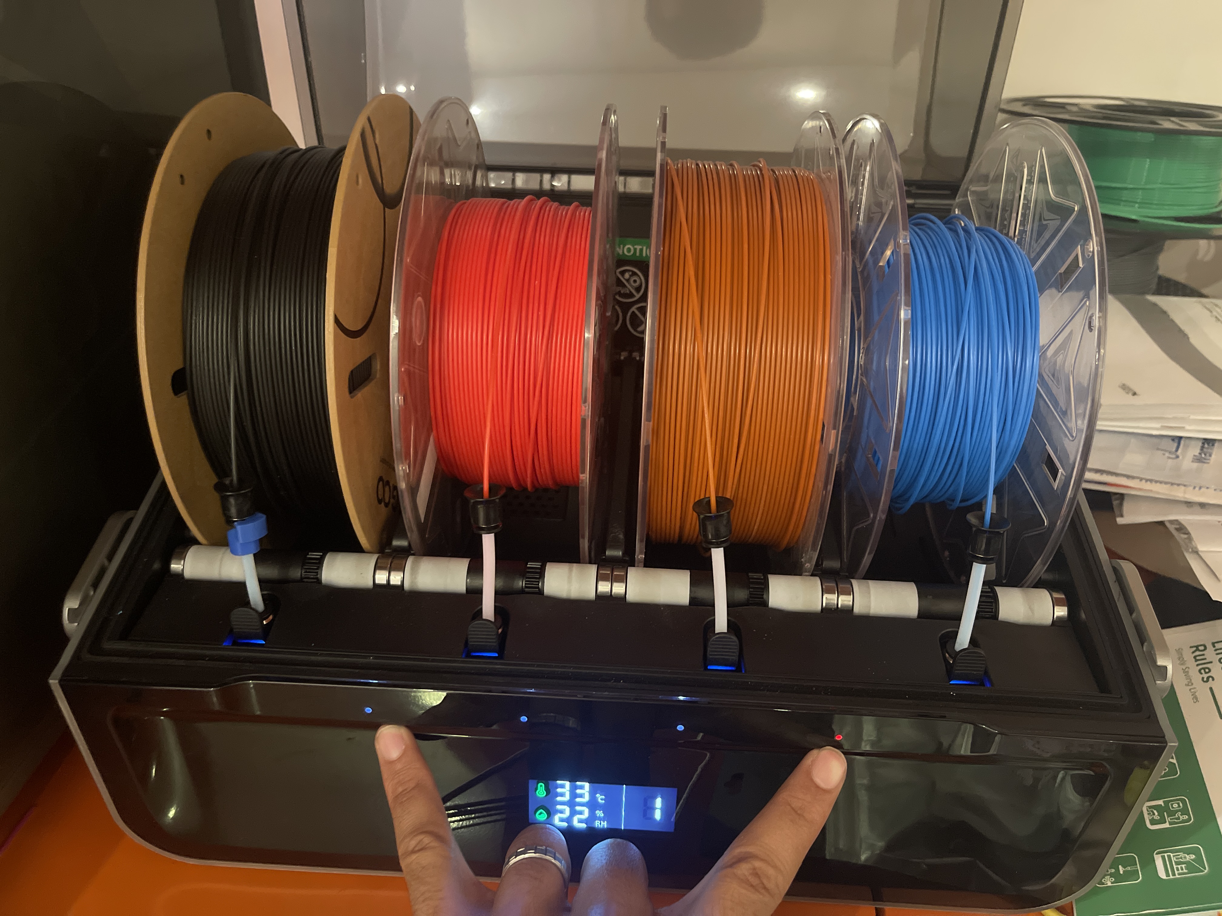

I am having the same issue but it only happens on both end slots 1&4 (A&D) the slots that have a longer distance to travel from the CFS to the hot-end. Also, the filament always stops short of the hot-end by like 2-3mm. My guess is that there is a software glitch from one of the recent updates as I have had my K2 plus since Nov. 2024 had no issues by April or March 2025 CFS issues started see images below
This looks a lot like what I was running into when the filament was constantly jamming, but for me, the jams were an order of magnitude worse for PETG, and rare with PLA. The only changes I made that affected PLA were replacing the extruder’s nozzle/heater/temperature sensor unit, replacing the extruder’s main board, and increasing the z-offset to 0.1mm. I don’t know which of these things fixed the problem, but there was evidence that the nozzle was running significantly colder than it was supposed to run, so my money is on the new nozzle.

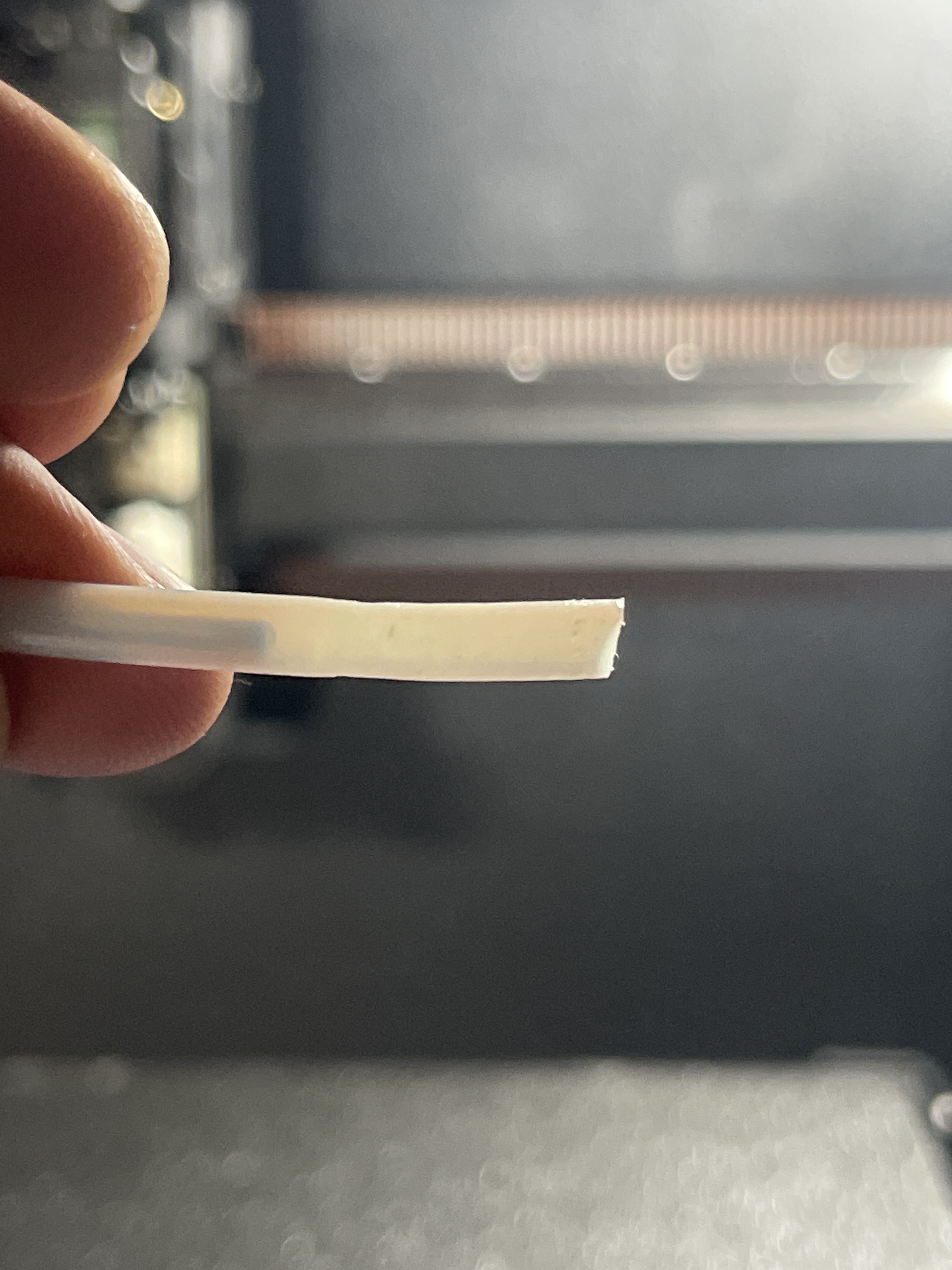

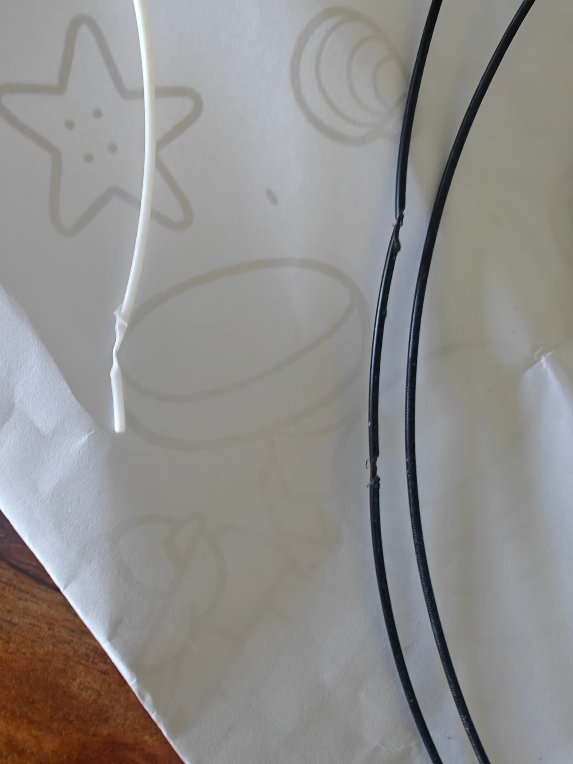

The filament issue you are seeing is probably caused because it cannot fully engage with the extruder and it’s sensors, causing the CFS motor in the “5-way Hub” underneath to spin and eat away at your filament. The damaged filament then causes issues with subsequent feed and retractions. I have had and solved this issue too.
The key is to make sure your filament gets to the extruder reliably. To do this, you need to reduce as much friction as you can between the CFS and the extruder and to make sure there is enough tension to push the filament past any challenges it may encounter in its path to the extruder. I did this by replacing the PTFE tubes with high quality PFA with a 2,5mm inner diameter and I increased the compression spring tension in the CFS “5-way Hub”. I printed some 1.5mm thick spacers and placed them in the holding where the spring interfaces with the tension lever. I would not cut your spring as others have suggested because it is not really addressing the issue (it only reduces the tension and amount of your filament that is being eaten up). The tighter tension gives your filament more of a probability of reaching the header without slipping.

The machine logic does not pass that sensor state to the CFS. Instead it uses the sensor on the CFS push motor to know when the filament is halted by the extruder and then stops the CFS push motor. If the motor gear is slipping on the filament it never gets the signal to stop itself. This is the purpose of the magnetic sensor on the CFS push motor.
I took apart the gears on the bottom CFS push motor, cleaned out all the filament dust thoroughly and then used some washers where the spring goes to add more “grab” so that the motor is stopped when the filament is stopped by the extruder. My problem disappeared completely after this.

It was driving me crazy because I would watch the filament go all the way to the extruder and turn on the filament sensor light, but the CFS would never stop pushing until it wore the exact mark into the filament that your picture shows. I thought that the logic should stop the filament as soon as it hit that sensor in the extruder. I finally realized that this is not the way the machine works.
That was pretty much my conclusion too. I spent a whole afternoon looking at the CFS parts and diagnosing the issue. Only difference is I printed a 1.5mm spacer to use instead of using a washer to increase the tension, but results were the same. My CFS array is working well now.
