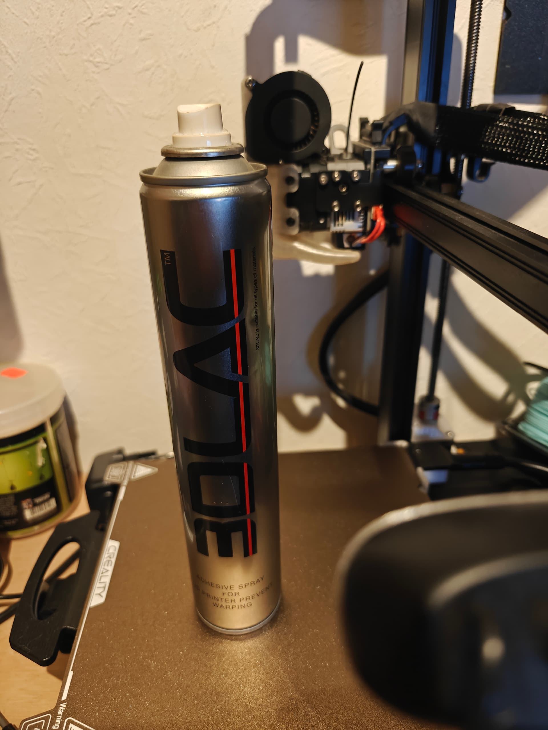

You should find it at Amazon. A couple of things I would reiterate from others here or add are the cleanliness of the bed plate.
- If you haven’t got one, get yourself a spray bottle of pure Isopropanol (Isopropyl Alcohol). It is invaluable for cleaning and degreasing things like the bed plate.
- I never go near a glue stick, I find them horribly uneven.
- I use a spray can of 3DLAC and apply a thin layer after clean and degreased plate.
- I never remove a print and then print again straight away. I apply a very slight spray to the area of the last print and then print.
- When I have print 3,4 or more prints, I will clean the bed and respray it. 3DLAC is easily removed with water. I run it under hot water, then scrub it with a small brush (nail brush) and a few drops of dish washing liquid. Rinse it well in hot water and wipe it with paper towel. It dries quickly, then wipe it paper and isopropanol. When it’s dry spray a light coat of 3DLAC and you’re ready to print again.

NOT rubbing alcohol, it is 70% isopropyl and “other” stuff, its the “other” stuff that can screw up bed adhesion. Get the purest isopropyl possible.
Anything over 96% is perfect. Rubbing alcohol can contain perfumes or antiseptics, neither of which are good for bed adhesion.
Thanks for the correction. My poor knowledge of Americans showing through!.
He use the stuff in the picture you can spray you plate with wd40 and then 3DLAC most of the time your print still stick.
Just basing it on what us Brits call rubbing alcohol
3DLac, do they do a PP version? Trying to get some Magigoo Pro PP for printing PP, Amazon don’t have it, packing tape is an alternative but doesn’t last.
Think the call it 3dlac plus im not 100% sure
Never heard the term rubbing alcohol used here in my life, but we do seem to import more and more Americanisms all the time.
I don’t know of a specific version for PP, I have yet to do battle with Polypropylene.
