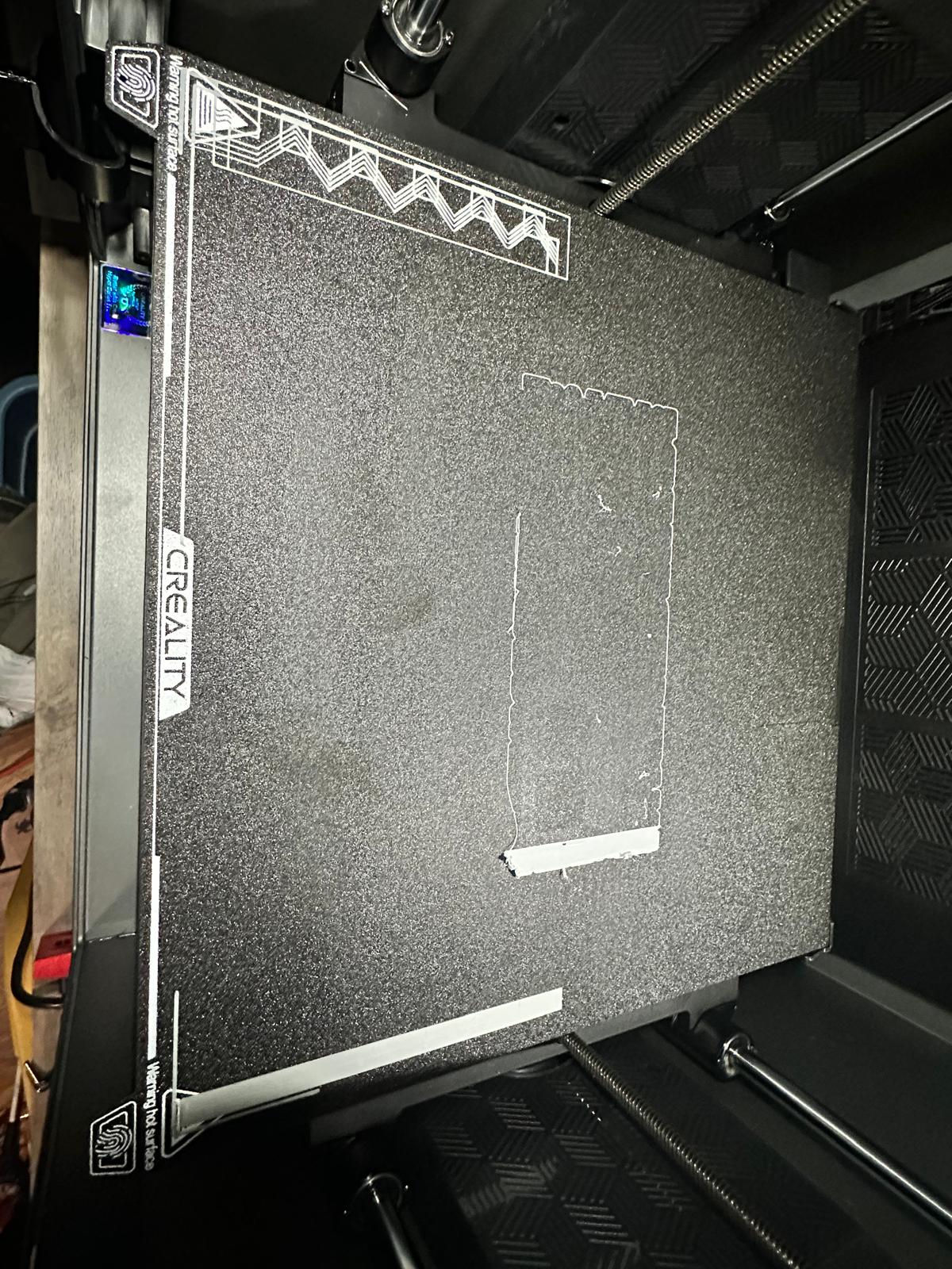

So sick of this printer - now the nozzle is scraping the build plate
So many issues, in such a short amount of time. I’ve had this printer for a couple of months and I’m not really even able to use it. I printed something that seemed to complete and without issue - so I ran it back and clicked “Send print” to see if I could print another consistently. Boy was that a stupid move. The nozzle was scraping so hard I could hear the heartbreaking grind from 10 feet away. The first image is the successful print, the other two are when I tried printing it again. The slight lines on the build plate are from the nozzle scraping it. I’m lost and ready to check if I can return this and get a bambu or build something with a friend who puts them together all of the time. This is just disgusting.

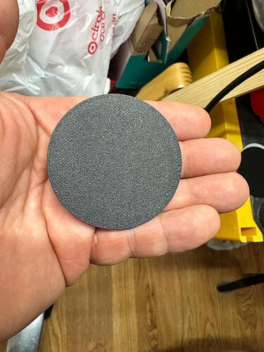

This is the latest attempt with calibration ticked within CrealityPrint:
As you can see, there are even holes and spots where it didn’t extrude. :confused:

Some observations reading though this topic:
  • Your print bed is really dirty. This creates these ‘holes’. NEVER print on a dirty PEI bed, even touching the bed with fingers is already leaving oils which prevent some filaments to stick to the bed at all.
  • You mentioned that you changed your nozzle. If you do that you most probably set an Z-offset for prints because the new nozzle is seldom exactly in the same distance with the sensor. I had same, and had to add 0.015mm at beginning with new nozzle. Now after printing again for ~200h with new nozzle the required Z-offset was already reduced to 0.005mm.
  • You do not need to run full calibration (PA and flow rate), just the bed leveling and define a profile for you filament like described here
  • If you need different Z-Offsets for different print beds or filaments you may use a macro like described here.
  • Check your extruder if it is wobbling or has loose screws.
  • Check your build plate, especially the part in the middle at the back which is used by the printer to test the nozzle touching to print bed and cleaning the nozzle and calculation required offset to distance sensor. If you bended this part down the the printer will use a wrong nozzle distance and you prints are not correct anymore!
Luckily all problems I had I could be resolve with above checks/corrections and my print head had never scratched (or even touched) the bed.
I even have not used glue sticks or so even printing 300mm long ABS/ASA parts.
Firstly I can’t begin to express how grateful I am that you took the time and care to write all of that out and share your knowledge. Everyone here is about the only reason I’m still giving this a shot after countless attempts resulting in disappointment. Something I found while searching around, is that apparently Creality sets the z offset to 0 via gcode before every print.
https://www.youtube.com/watch?v=sMVAJIM2RMQ is the video that shed some light on that. Now, a friend of mine super well-versed in printer calibration had guided me through my z-offset and we couldn’t figure out why it would just “randomly” start digging in and prints not be as good as they were during calibration. This would explain it. In my printer.cfg the offset is set to 0, regardless of whether or not I hit ‘save and restart’ or the little diskette icon for ‘save’. Regardless of what’s done, that offset never gets stored in the printer config anywhere and is set to 0. So basically, the reason we had even calibrated the z offset was similar issues to what I’ve been describing. The fact it never resolved it really, this would make sense. I’m about to give this a try, as I’m physically limited (handicapped a bit) and can’t stand long at my printer but I’m going to keep at it. The frustration is only heightened by the fact I literally go through quite a bit of pain every time I have to go take out failed prints and try to re-calibrate or do anything. Just stating a fact, so that it’s not appearing as if I’m whining without putting forth every damned effort I possibly can here. Thanks a lot again, I’m going to post results.
I wonder what would happen if you change the z-offset to 0.2 in printer.cfg and start macro, it should raise it off the bed, just as a test, you could dial it in manually I suppose, not ideal.
I actually put a feeler gauge on the bed and directed the z-axis down to 0.03 and it was basically touching the bed. That being said, I used a feeler that was 0.08 and adjusted until it was just touching both the nozzle and bed, then got the value of the axis there and set that in the start_print macro directly. It seems it might have been a bit high based on the test disc I printed being very separated and also pulled off of the bed during the print to the point I had to abort. I imagine it needs to be lowered down some more. Is my method of zeroing the z-axis not ideal? I figured using 0.08mm would be pretty close to as good of a zero without rubbing the build plate.
On all the printers I have I would adjust using the touchscreen and it would save it from there. i think the feeler gauge/paper method is a good start though. On my Enders I don’t autocalibrate once I have the z-offset sorted.
Thanks again for everyone’s feedback. I’m never one to be one-sided, or just complain and not post the positive. Hopefully something in my journey helps anyone else out. That being said - it turns out the offset being reset to 0 before every print, definitely had a major hand in screwing everything up forward hence. I calibrated my offset to the best of my ability and set it in gcode_macro.cfg where this line exists:
SET_GCODE_OFFSET Z=0
and set my offset there. The results from there, even during calibration are worlds apart from earlier. I can actually read the values on the flowrate tiles now once they’re printed instead of having to try to figure them out by way of matching their position to the print preview. I’m still struggling to get some things down pat, but I’m still here and still trying.

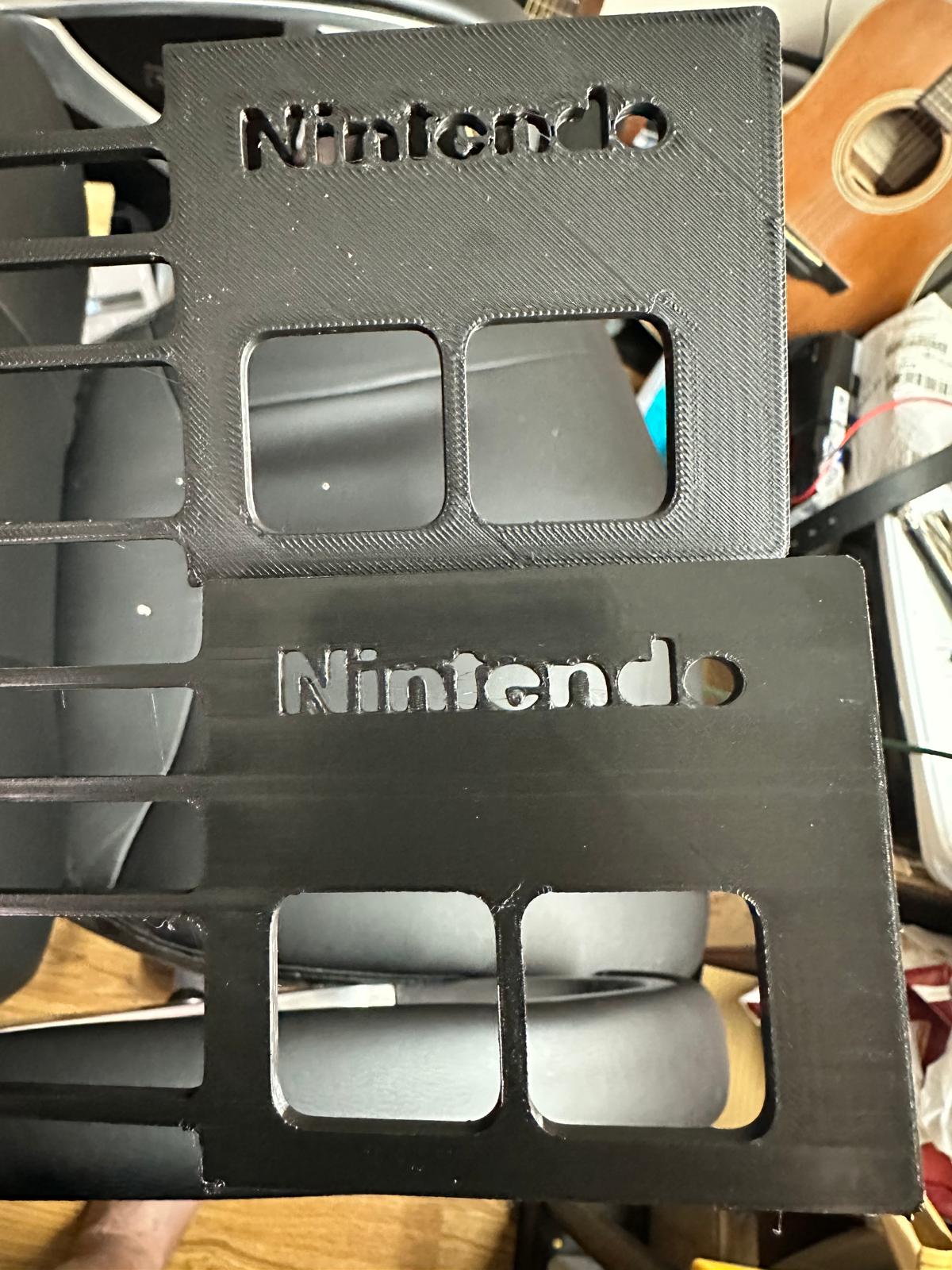

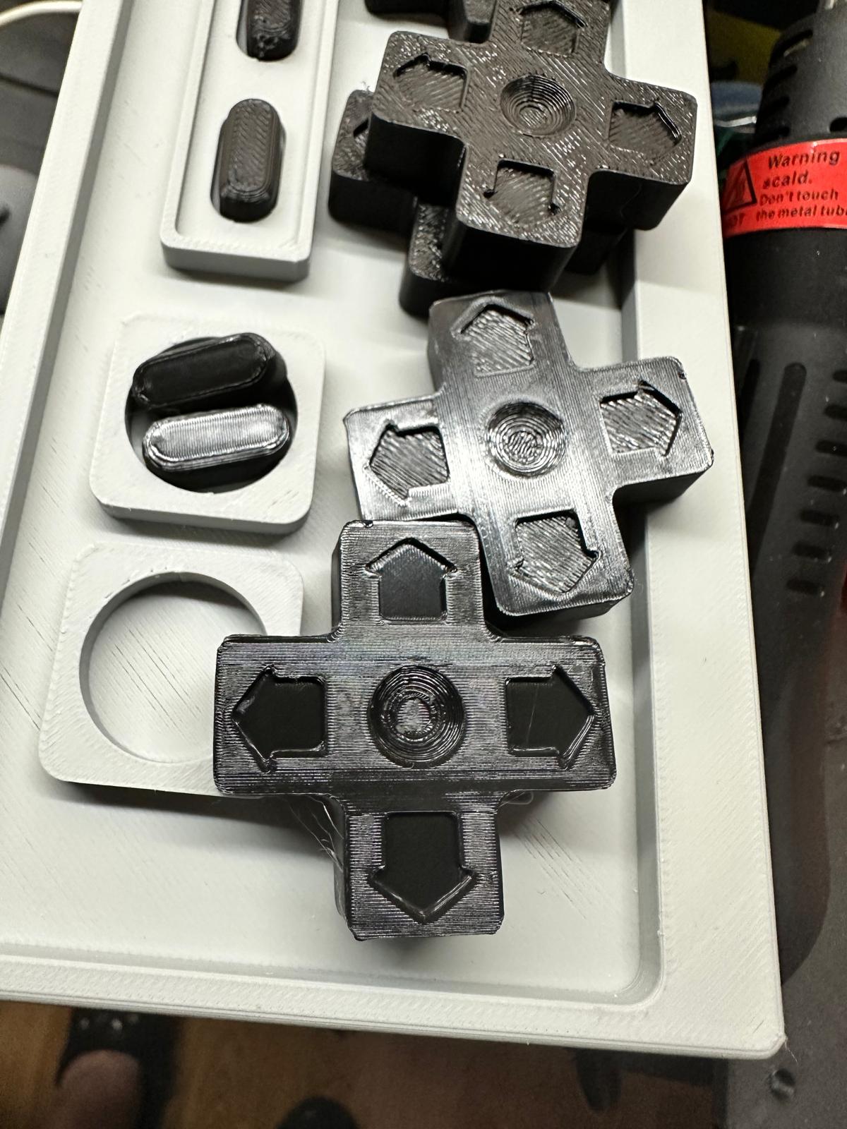

Here are some buttons I printed out for a model, that the progression from top to bottom is displayed and me getting a bit excited/bold and testing ironing out once I was able to get prints that didn’t rip off of the bed or were complete trash:
Here’s a faceplate that I re-printed a couple of times after not even being able to print it at all, that I tested ironing out on as well:

It looks like your wall width might be a little low, and the overlap % might need a slight bump. Not by much though—too much overlap, and you risk that “whip and valley” effect (where the nozzle overcompensates and creates little ridges/dips). It can also lead to filament buildup on the nozzle head, especially with PETG.
Try bumping overlap slightly (+2-5% max) - you should see tighter seam connections without unwanted surface artifacts. You can use the discs mentioned by @frankjoke, or print 0.2mm high squares to dial it in efficiently without wasting too much time or filament.

the result:
Is the bit of crud around the top face edges expected/nothing can be done printing-wise about it without post-processing? Or is there something else needing tweaking to get that toned up better?
