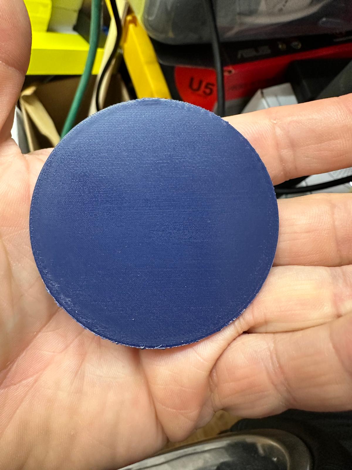

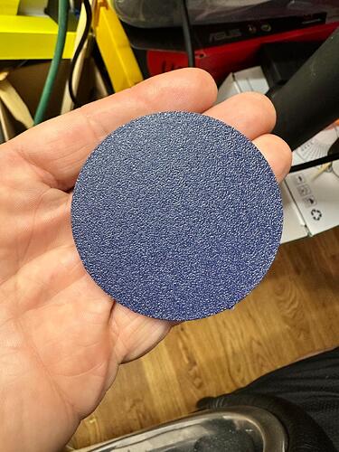

I have the same problem. Start a print. First calibration ect ect. The first layer is like sandpaper. A complete fail.
Manual z height to .345mm up and the print is ok.
A benchy from the printer default does print ok. No need for a z height adjustment.
But what caused this?
