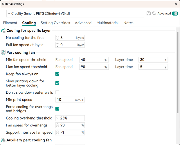

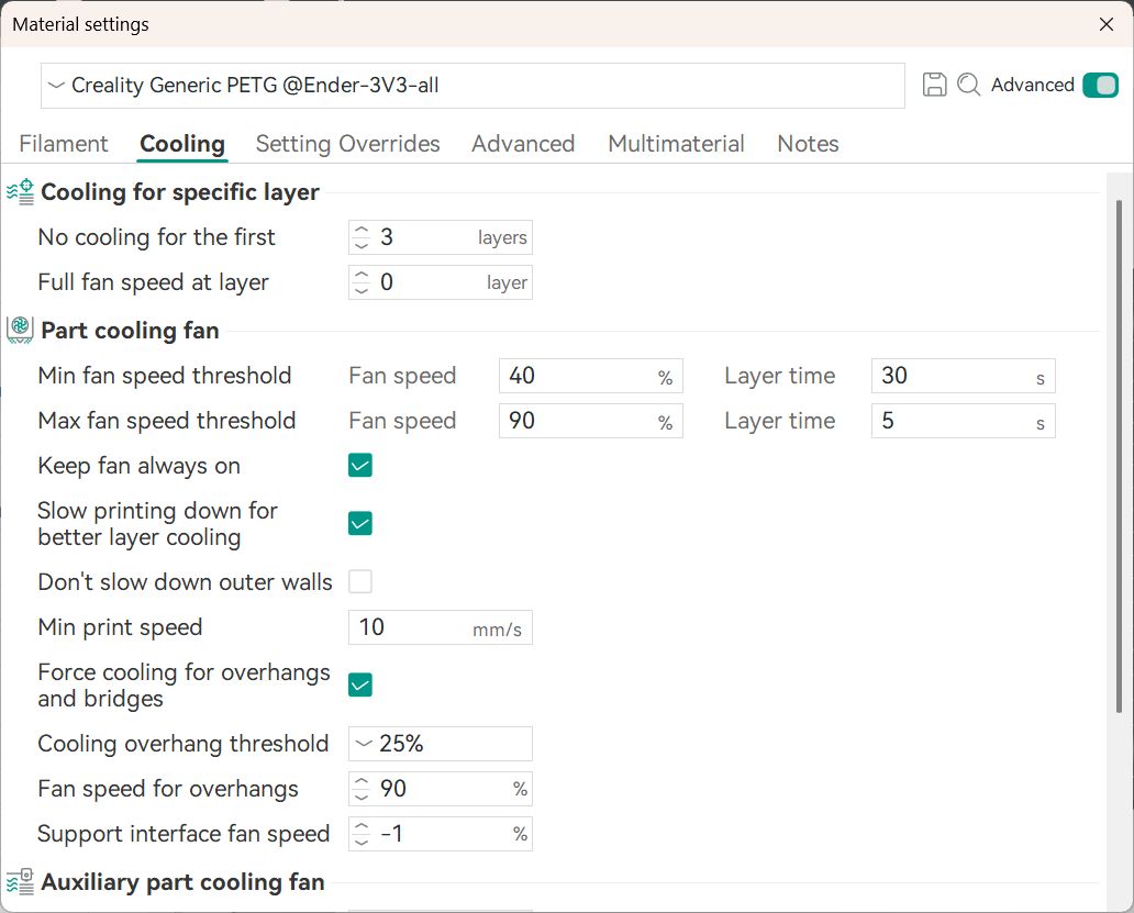

It has to dried properly and do a temperature calibration, I print PETG alot. I tend to use Sunlu filament and certainly not as hot as 270. I use the Orca settings of 250°C and 70°C bed. With cooling as per attached:-

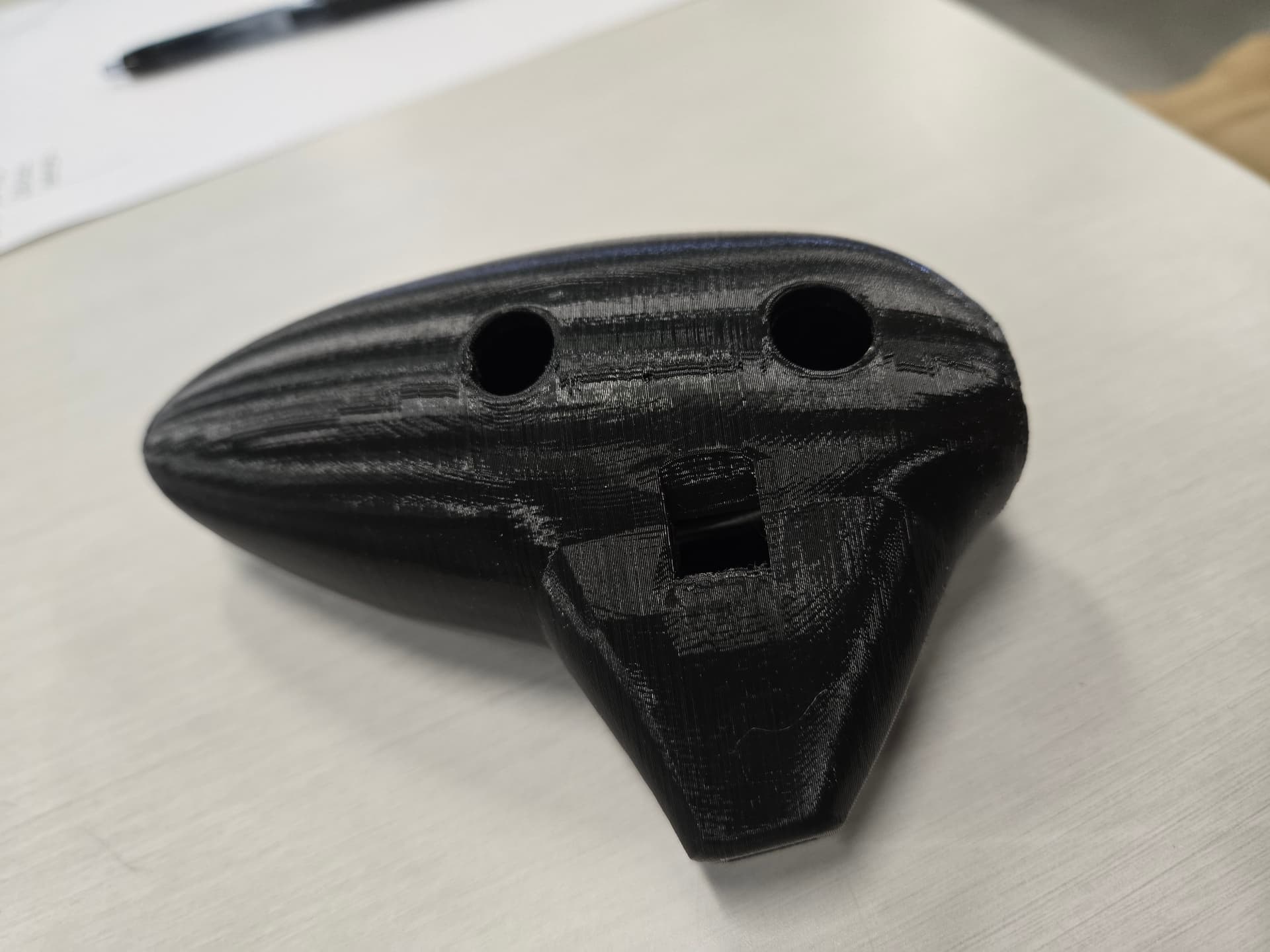

Made a print of an ocarina yesterday to try and learn how to play some Zelda music, lol. It had some issues, but not sure what to attribute them too. It seems when I print things that stand up kinda tall, there’s a weird line that gets produced on the side facing away from the part.

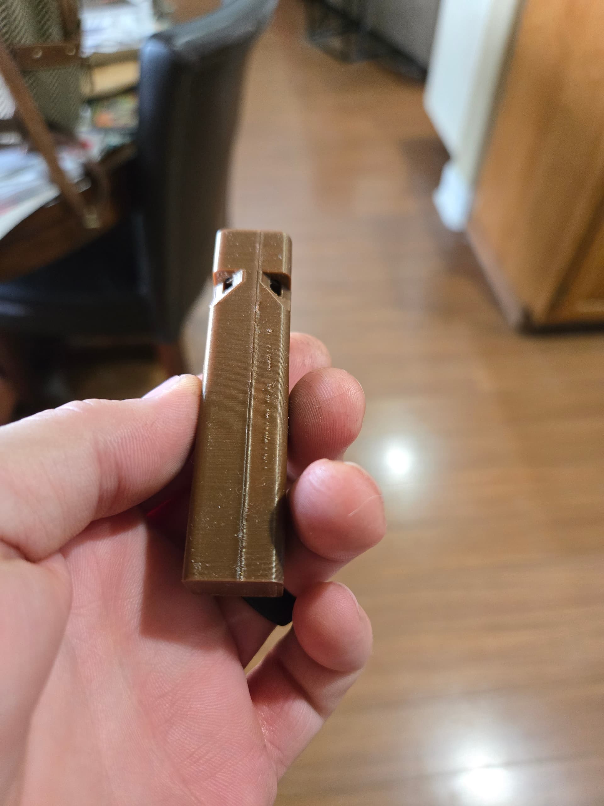

I printed some train whitles and it did the same thing on all of them.
That tall line you’re seeing is your Z-seam. You can adjust or hide it in your slicer settings, some slicers make this easier than others. I spotted it on your Ocarina too (awesome print, by the way! :notes:).
There are a few ways to minimize or control it: setting the seam to ‘scarf,’ ‘sharpest corner,’ ‘back,’ or manually adjusting its placement. In most slicers, you’ll see it as a white line or dot at each layer in preview mode.
