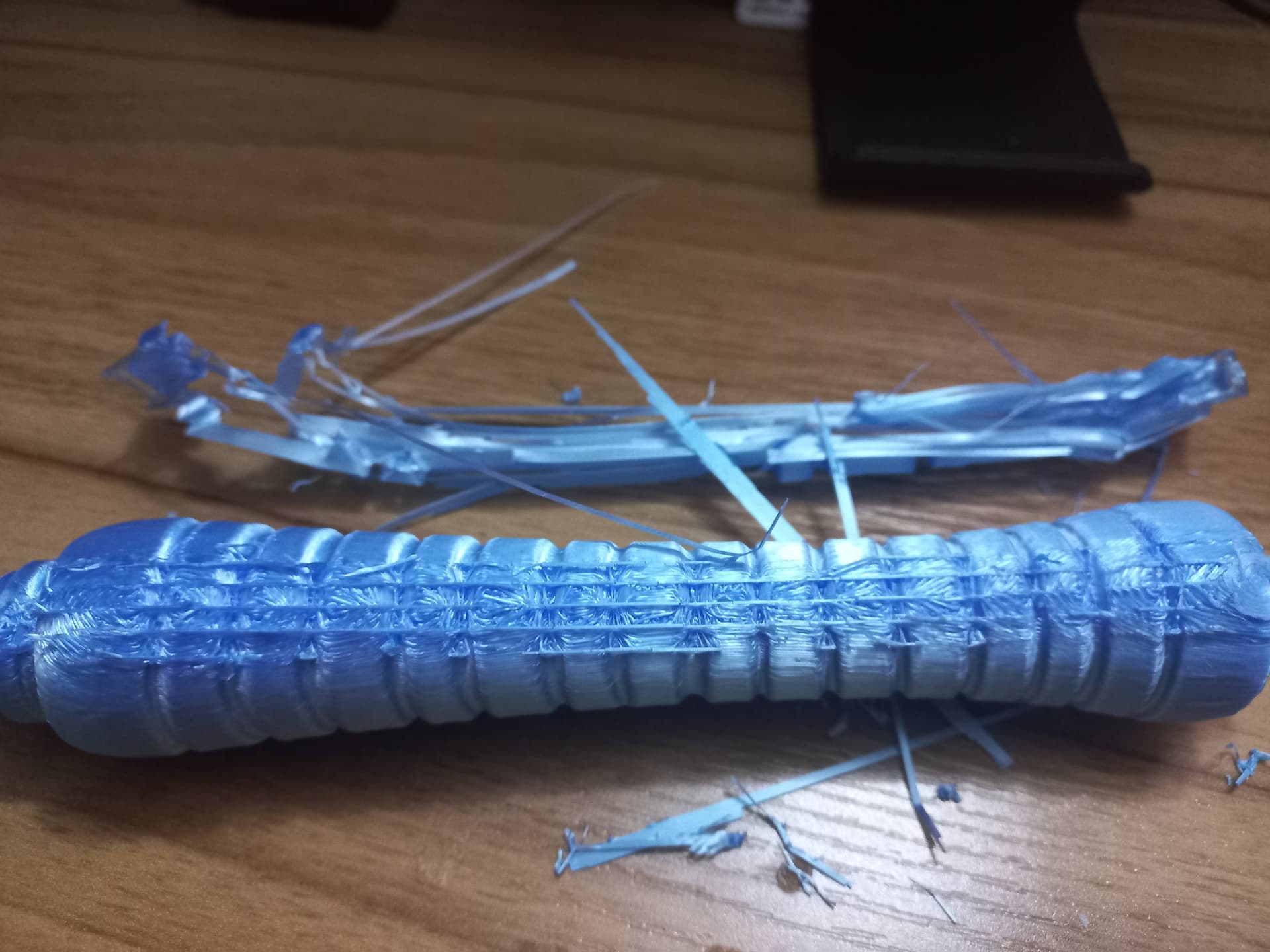

I’m wondering which setting are you guys using for your support Interface. I was using tree supports but it are very weak when the print is above 10cm and it fall down also tree supports makes the print time to be more than using normal supports for 20 or 30mins more.
My normal supports with 10% of density can be detached easily but not the interface part, which also make the quality of the print uglier. You can check the image below :backhand_index_pointing_down:t2:
To adjust the density of the supports you can adjust the Support Density option in the Creality Print settings for supports, you can also adjust the Support Roof Thickness and also the Support Roof Density to try and find the best settings that work for your print. Tree supports generally will take longer to print than normal support structure due to the way its printed.
