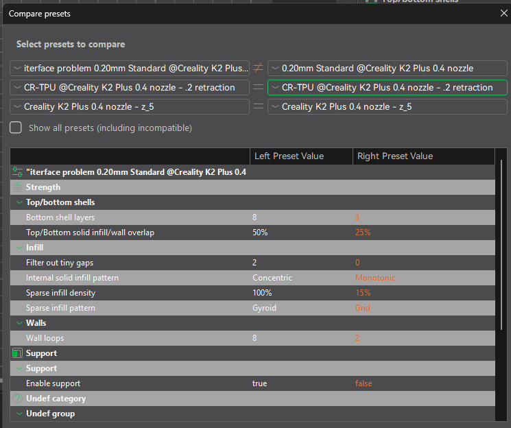

I am having intermittent problems with the top Interface layer sticking to the model (i.e. top interface layer is getting embedded in the bottom of the model layer it is interfacing to)
The problem is somewhat intermittent (more often than not), but repeatable. I’ve compared the presets and they all match (this is for “normal”" supports).
I’m not sure what to adjust for this. Does anyone have a suggestion?

what stands out if infill overlap.. did you choose that on purpose ?
I never even print with the CR defaults of 30, I drop that down to 15 max
try lowering this back to 10-15 and see if the problem goes away..
what filament are you using ? I find 15% work well with PLA & PLA+/PETG/ABS & TPU
haha, just noticed my preset is 25, must drop that back down to 15.. :frowning:
Thanks for the help. I mostly print in PLA. Yes, I did increase infill overlap on purpose. I was trying to increase the strength of PLA print rather than go to a stronger filament. Ironically, that setting is a left-over that i forgot about. I need to take it out anyway. I got much better strength results with more walls. I’m not sure how it snuck into my other pre-sets. I’ll throttle it back and let you know how it goes.

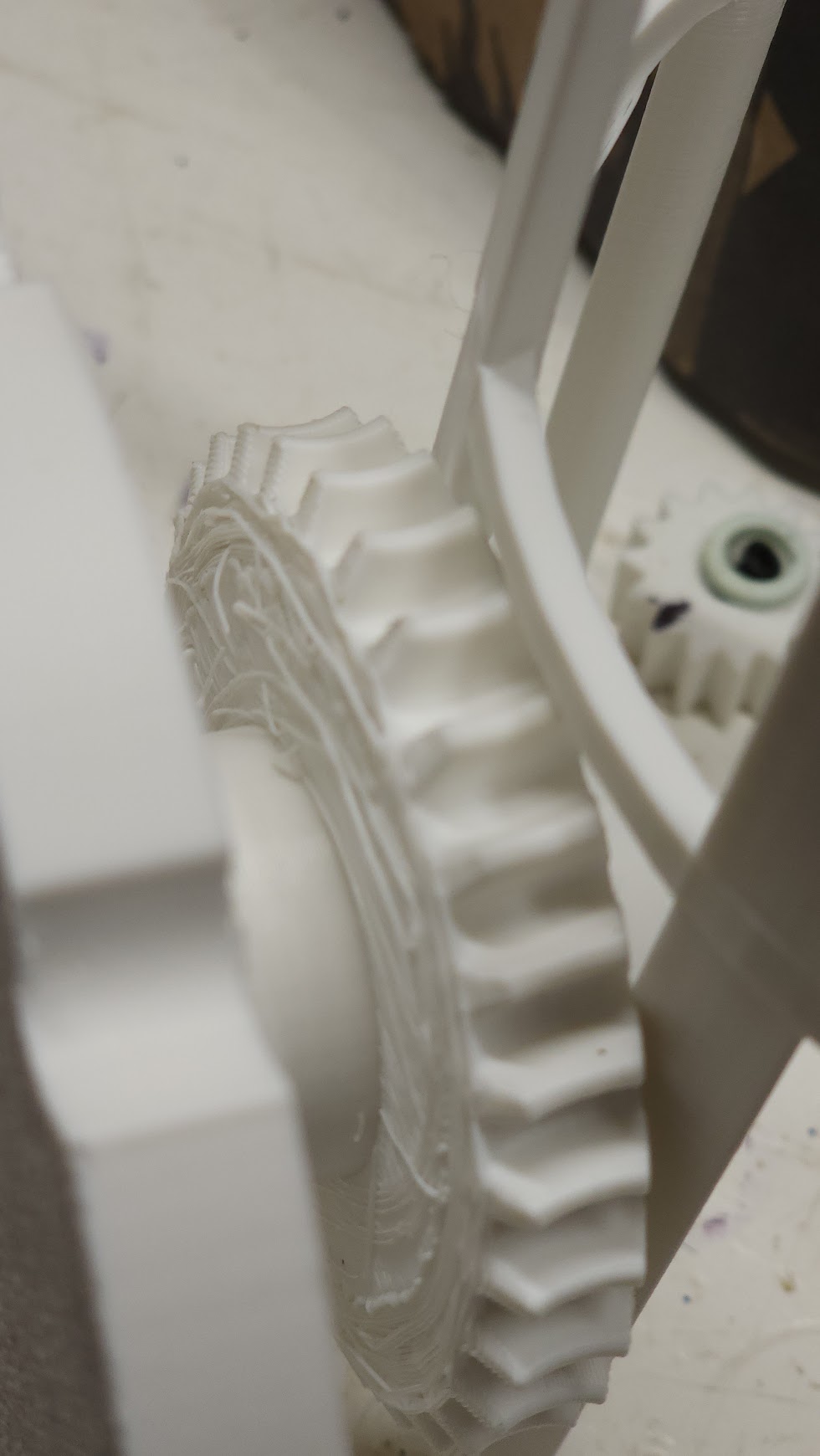

I got a good picture of the phenomena. I’m posting it just to be sure we are all working on the same problem. The rough/loose finish on the bottom of this gear happens on a lot of flat undersurfaces’. When this was printed, the messy side of the gear was on the bottom, but suspended above the print plate by the bearing holder.
it isn’t just one model, seems pretty common on the underside of flat surfaces. Just happened yesterday on a simple box. I remain perplexed.

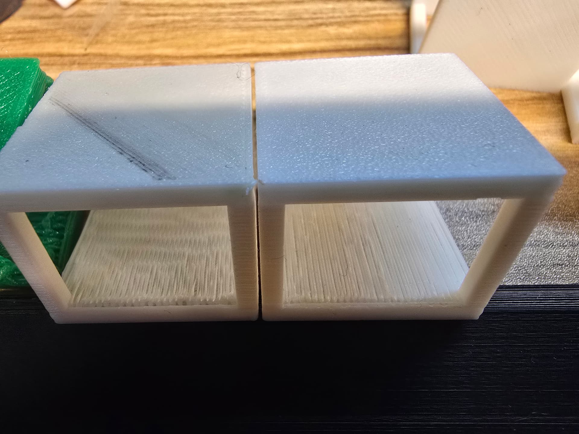

@Chris.S_NZ I made a little cube to test with. This first test was all default settings (unless my defaults got messed up). I uploaded the project for your comparison.
support test_defaults_standard support.3mf (22.0 KB)

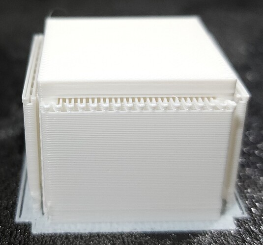

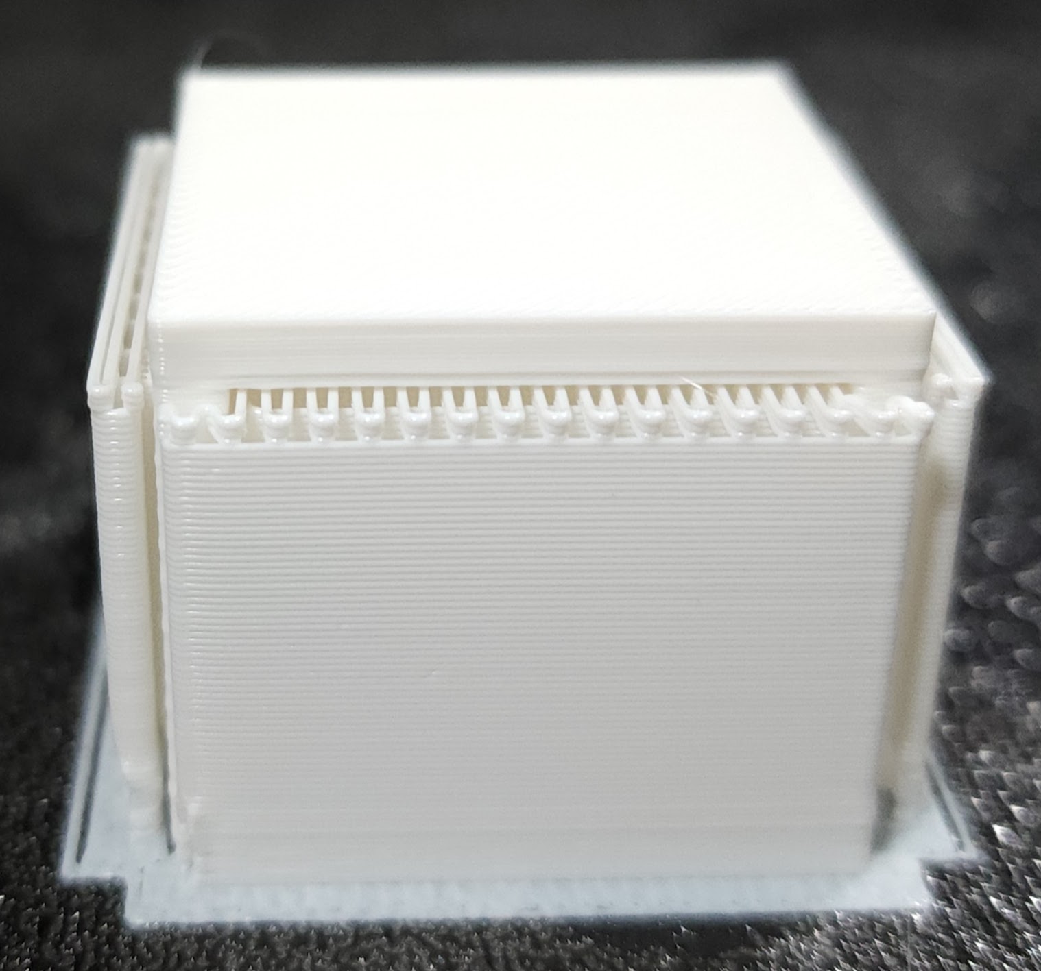

Here’s the picture with the supports in place.

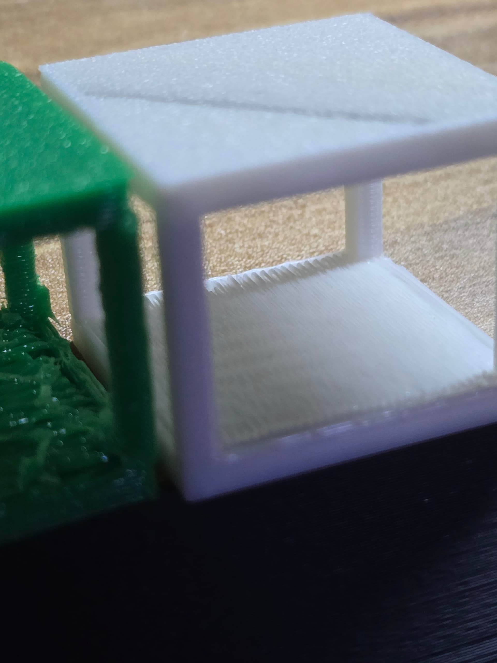

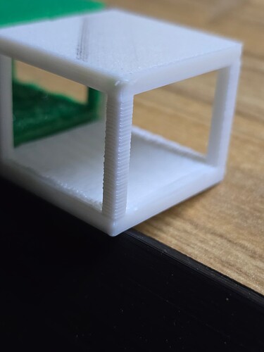

Here is a picture that shows the problem well. Note, off to the left, you can see that things are not lining up correctly.

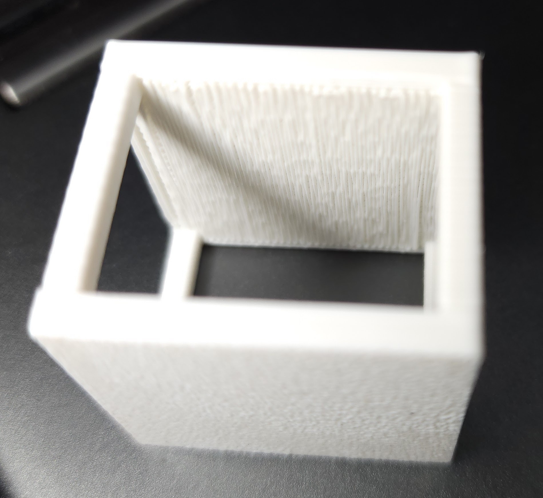

Flipped upside down, here is another shot of that edge that seems so off.

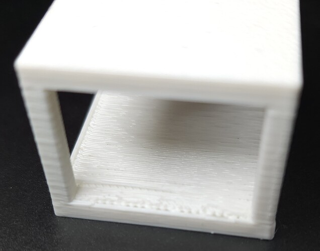

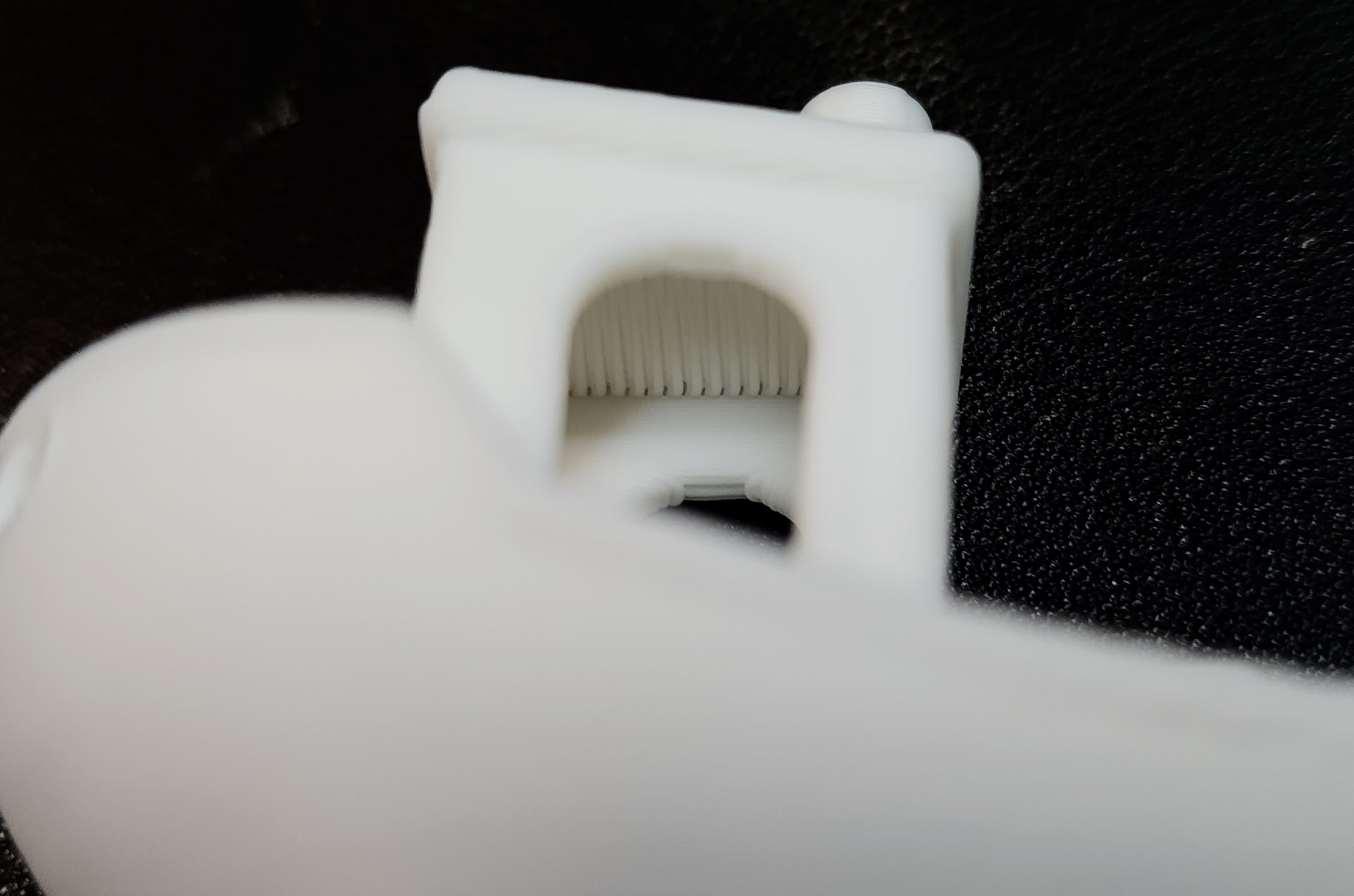

Then as I was cleaning up, I noticed it happened on the original test Benchy that the K2 prints as a start-up test.

Cheers, will have a look and compare settings and do some test prints to compare results, that first image the bottom left looks quite bad, I normally only get walls splodging that much with very wet filament.
Or input shaping/extruder z motor calibration is very far off… Does either a VFA or a small solid square calibration test print Ok, are you getting dimensional accuracy ?

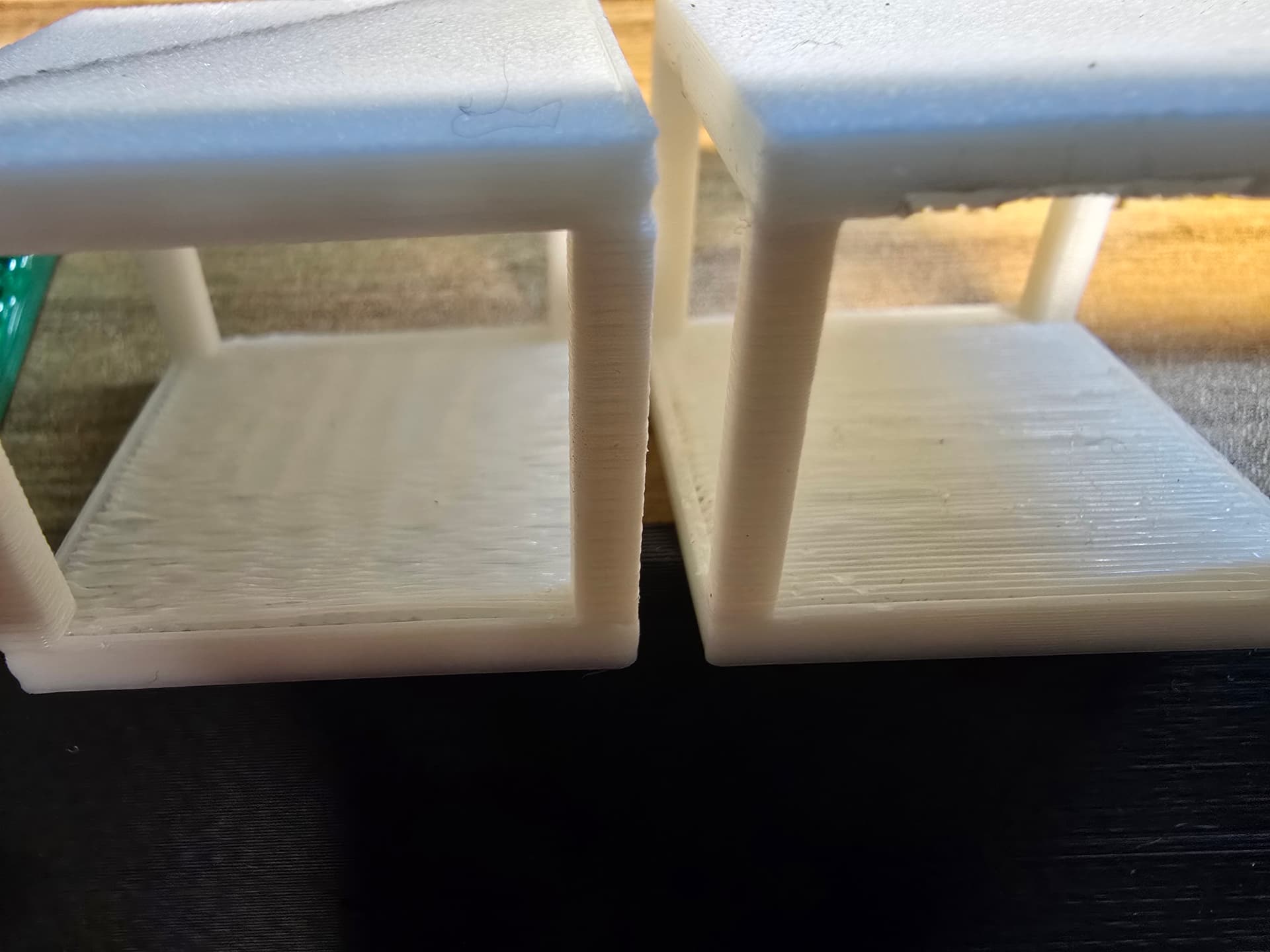

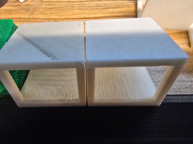

your project, my printer, only change I made to settings, is I disabled "remove small overhangs - 5mm) as I’d never have that if trying for underneath “good” surfaces, no other changes. to print settings, just what my PLA white setting/0.4 nozzle setup is:
And she’s off :smile:
Edit, a coffee later..and remember this is cheap ender PLA..

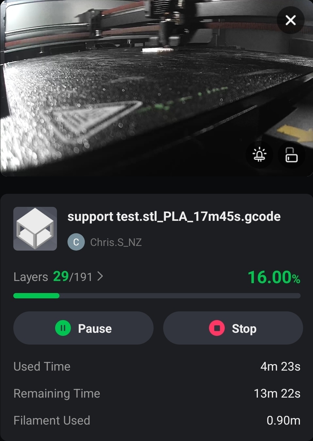

printing via side spool, calibration enabled, as I’m not sure how old this ender pla is, and now its used the first layer off the spool, let the machine find what PA & flow ratio’s to use..
will take a bit longer with all the changes & calibration..
will edit in about 30 minutes with results

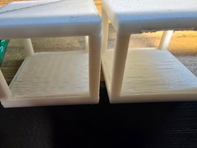

results, I’d not both with 3 interface layers again on such a small object, too hard - fiddly to remove, just defaults for that..
left was project settings, right changed settings.
probably change layer heights to improve quality would be next step.. use either variable layer height or reduce the tpo z distance &/or spacing until it was tight or too difficult to remove, there is also the default support type snug to try…
