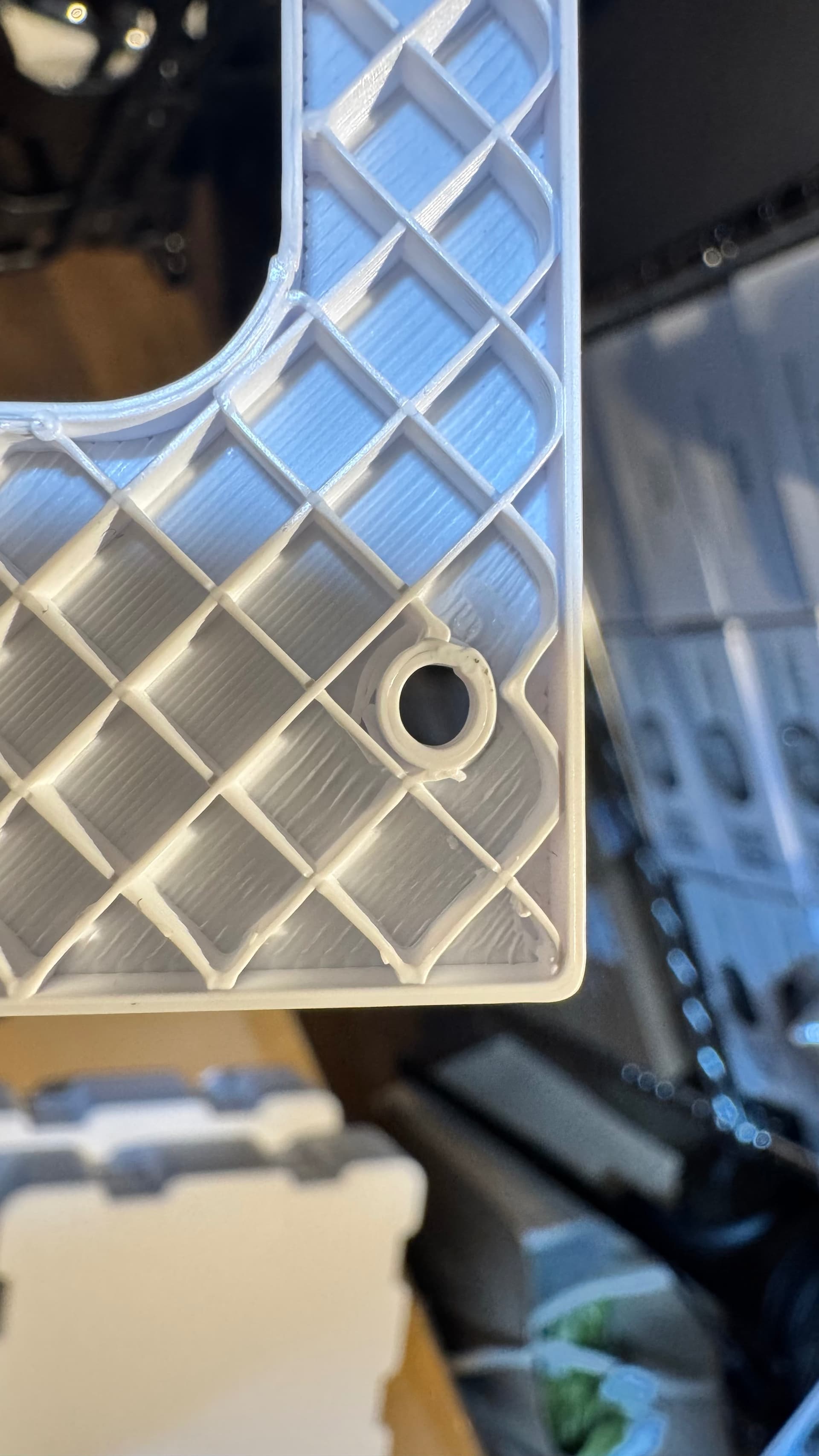

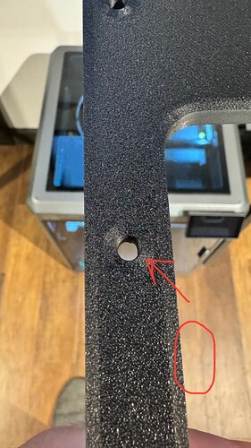

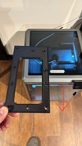

I am experiencing the following issue with the K2Plus.
If anyone knows how to fix this, I would really appreciate your advice.
Please refer to the attached photos.
The hole shape is stretched downward, becoming an ellipse (towards the openable window side).
In the STL file, it is a perfect circle.
Does anyone know how to adjust this?

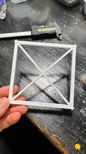

did you print a XY test?
YACS.stl (315,1 KB)
Here you can measure how exact the printer is, but this is normally not such a big difference that you see it. Anyhow, print is and measure AC, BD, AD where AC & BD should be nearly the same.

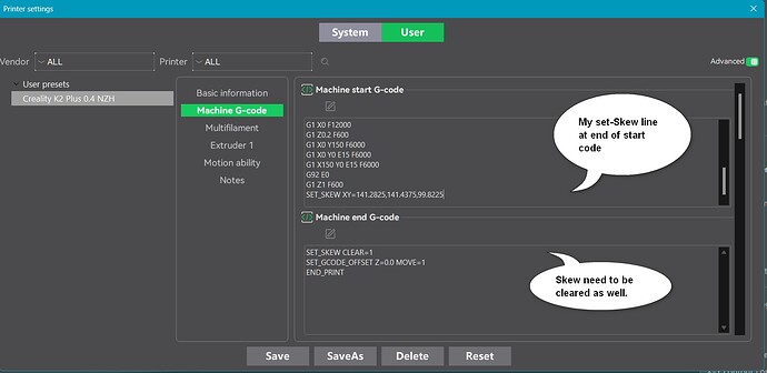

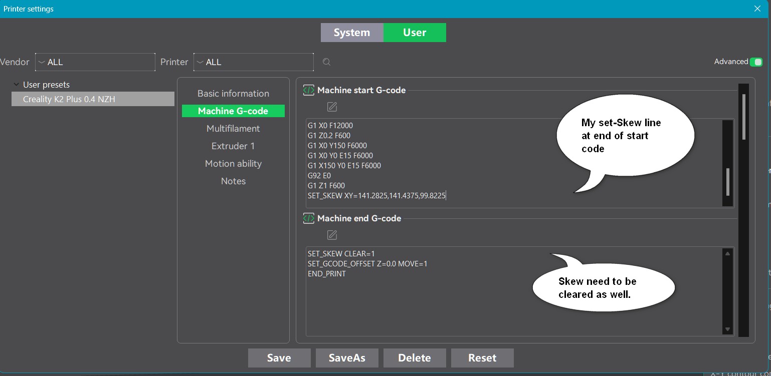

You can then include in a user print settings a corection in the start G-Code section by adding a line:
SET_SKEW XY=AC,BD,AD
# my own line is: SET_SKEW XY=141.055,141.4425,99.8325
In end print G-Code you should add also
SET_SKEW CLEAR=1
like shown here in my example:
When you do manual belt adjustments you normally need to rerun the test and adjust values.

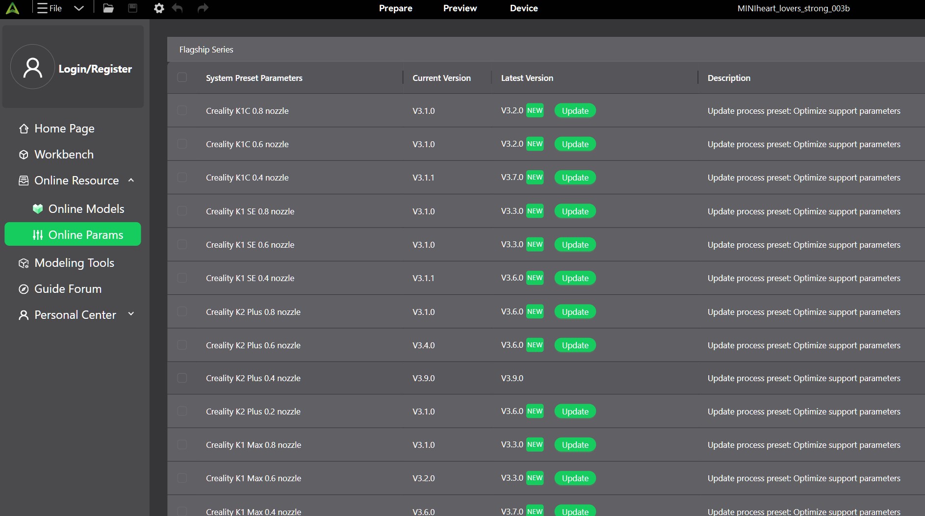

If the differenc3e between the two axes are > 5% I would
  1. Check if printer has latest FW (1.1.2.10)
  2. Reset printer to factory
  3. Rerun all calibration tests

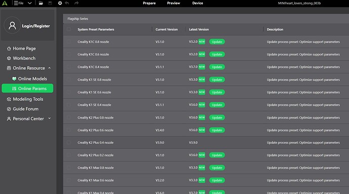

  4. Check if you have newest profiles installed on CP6

I made the file you attached and measured it.
Everywhere, there was no misalignment and the dimensions were the same.
However, the circle is not a perfect circle, but an ellipse…

On you part is the rest of the part with right dimensions and only the holes are oval?
Where did you get the part you print from? Was it an .stl and you use default print setting? Can you upload 3mf (it would include the setting) ?

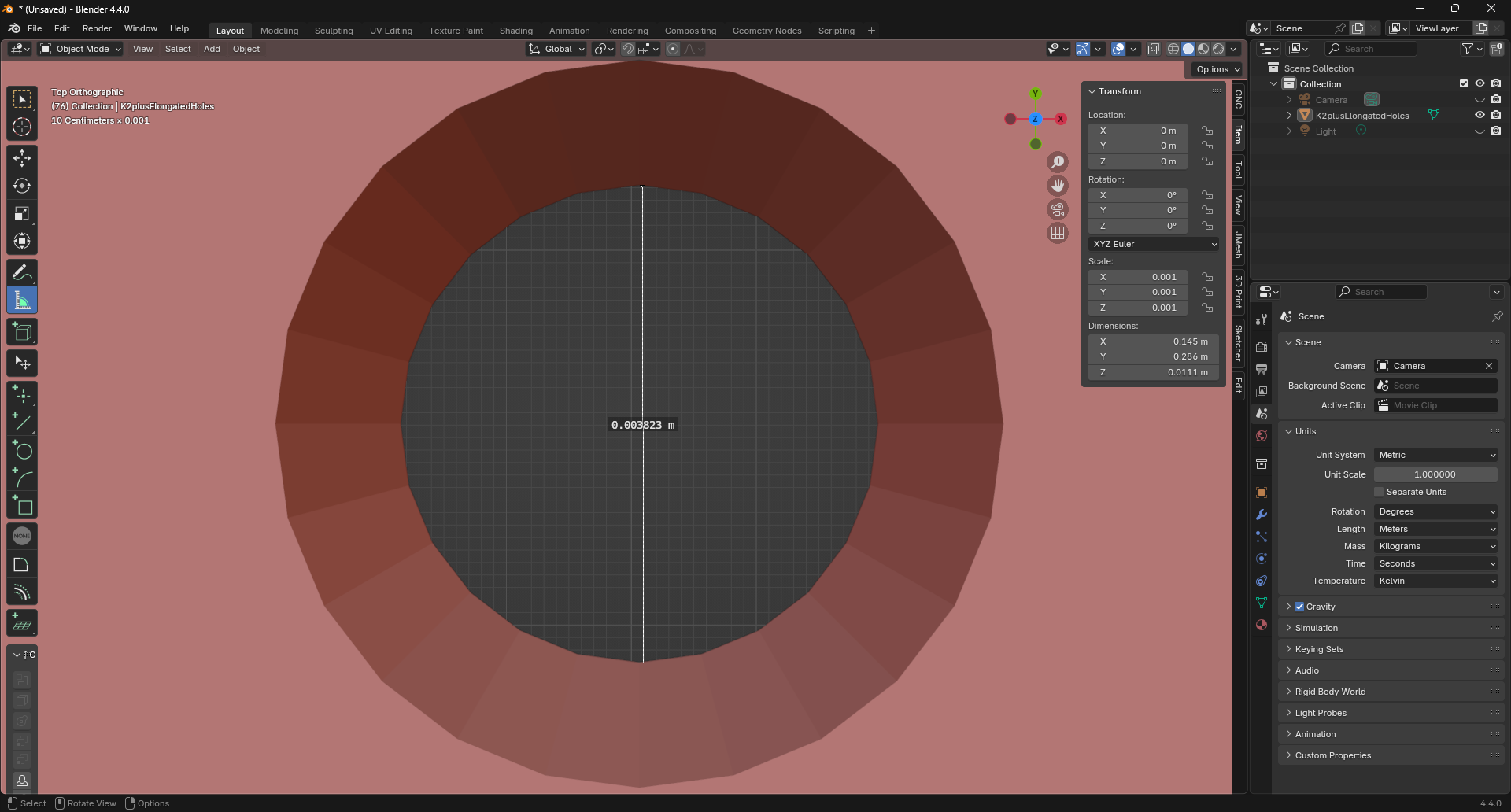

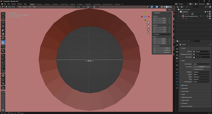

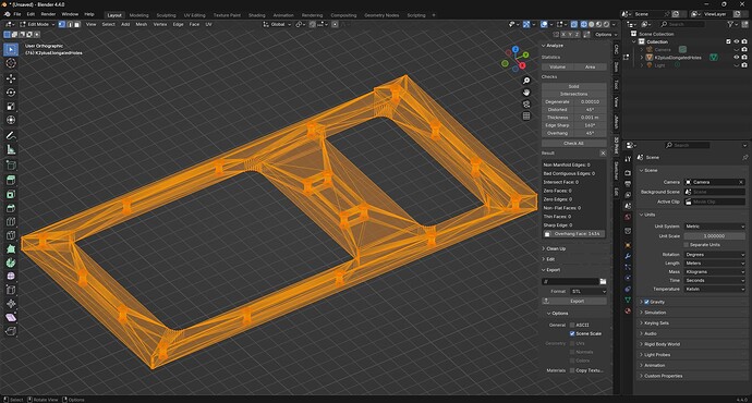

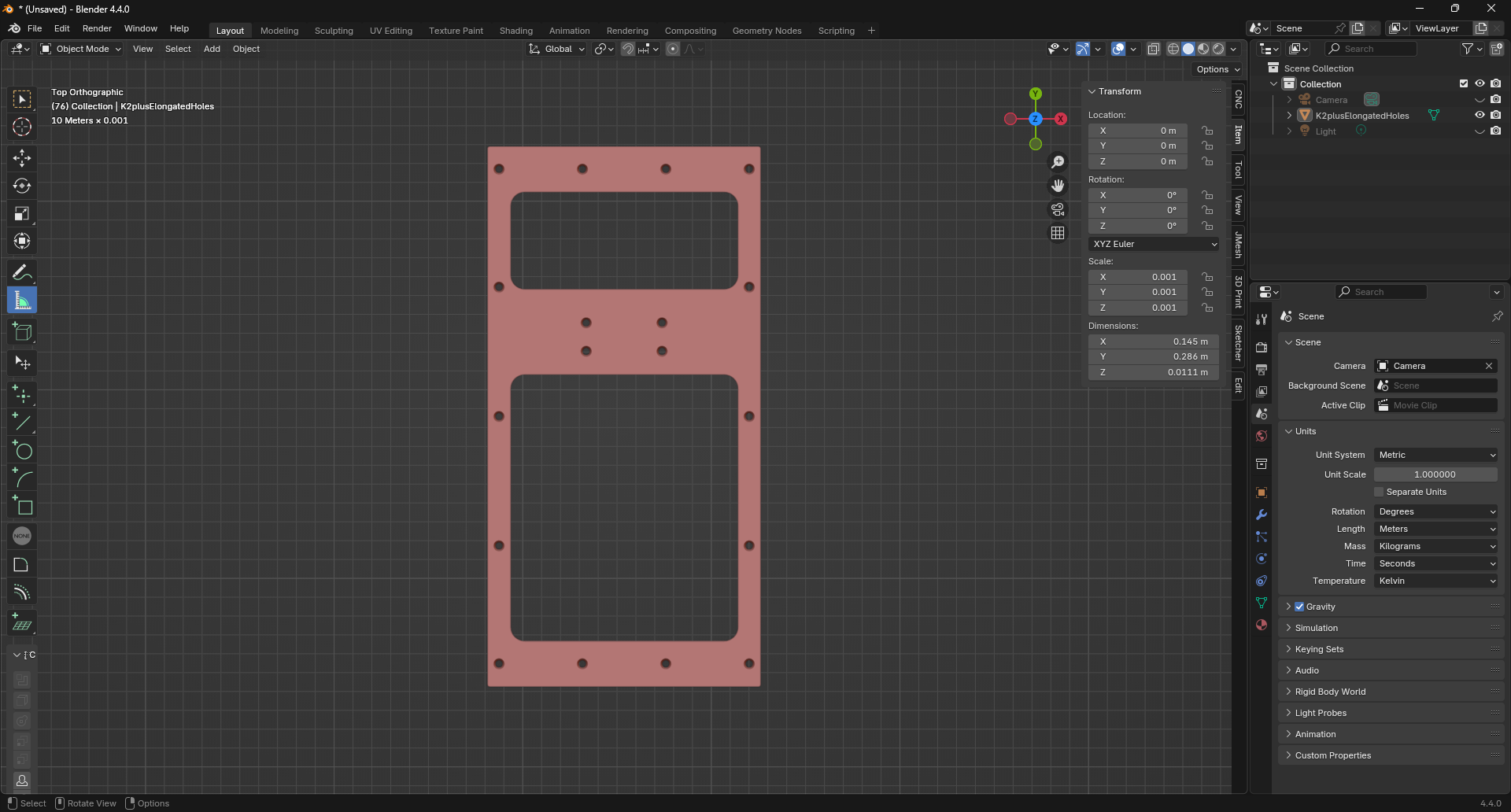

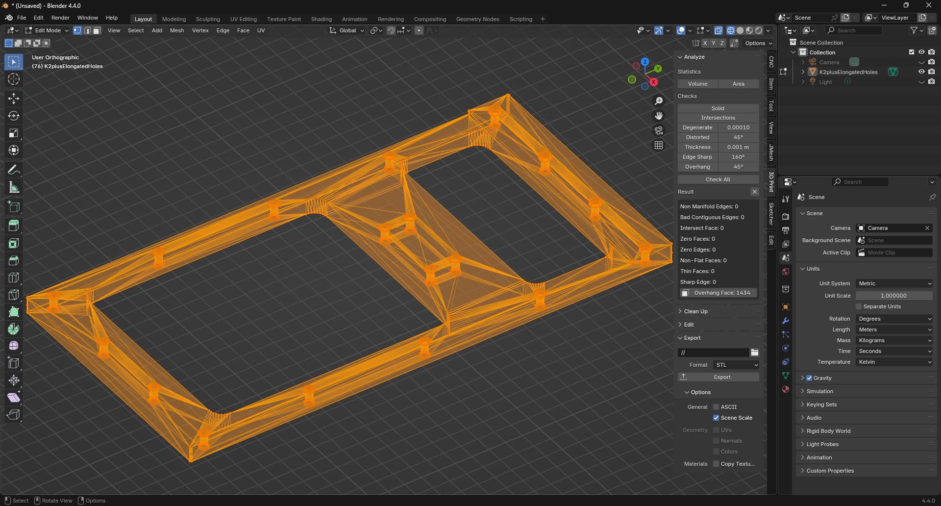

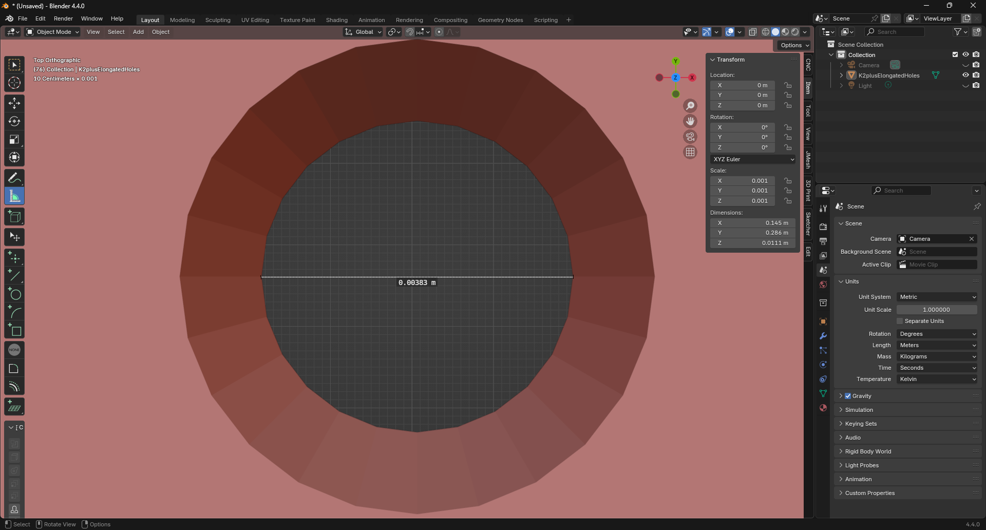

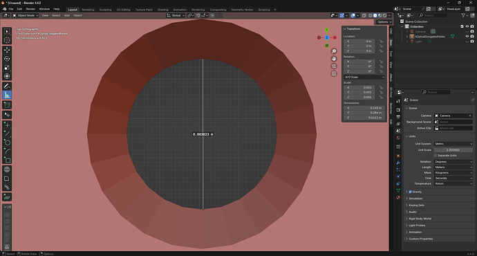

Hi, Blender seems to show the .stl file as correct. It is perfect - not a single geometry error. Here are some photos:
Yes, as @rdtsc mentioned the STL is good and the holes are true circles.

Yesterday, I tried different print speeds. At the default speed of 100%, the perfect circle turned into an oval, but when I set the speed mode to 50%, the print did not turn into an oval.
In bambulad’s x1c, even at 100% speed
it never became elliptical, but in k2plus it does.
Is it a problem with the machine?
White is printed in 100% mode and
black is printed in 50% mode.
The same file was used for the output.
Ok, which filament do you use? You used Generic PLA profile and standard print profile to slice (as I can see in 3mf) and it seems that printer/filament max flow is to fast for this filament.
I would choose ‘high quality’ print settings in slicer and create filament profile for the filaments you use because the filament print setting are not OK for both filaments as I see from picture.
You may use this thread to see how you can get better settings for you filament.
