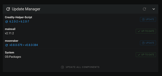

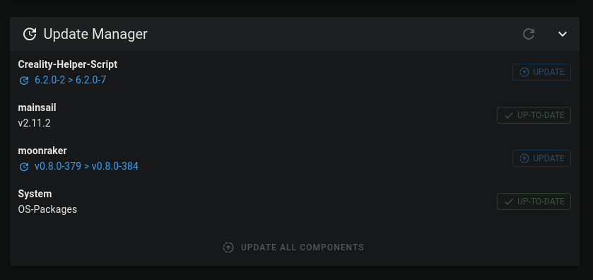

I used annex script and couldn’t get mainsail and moonraker updates to work. Uninstalled and then I used Guilouz helper script and it just works, updates to.
I added my reply for others in case they have the same problem.
Can you update your mainsail and moonraker?
