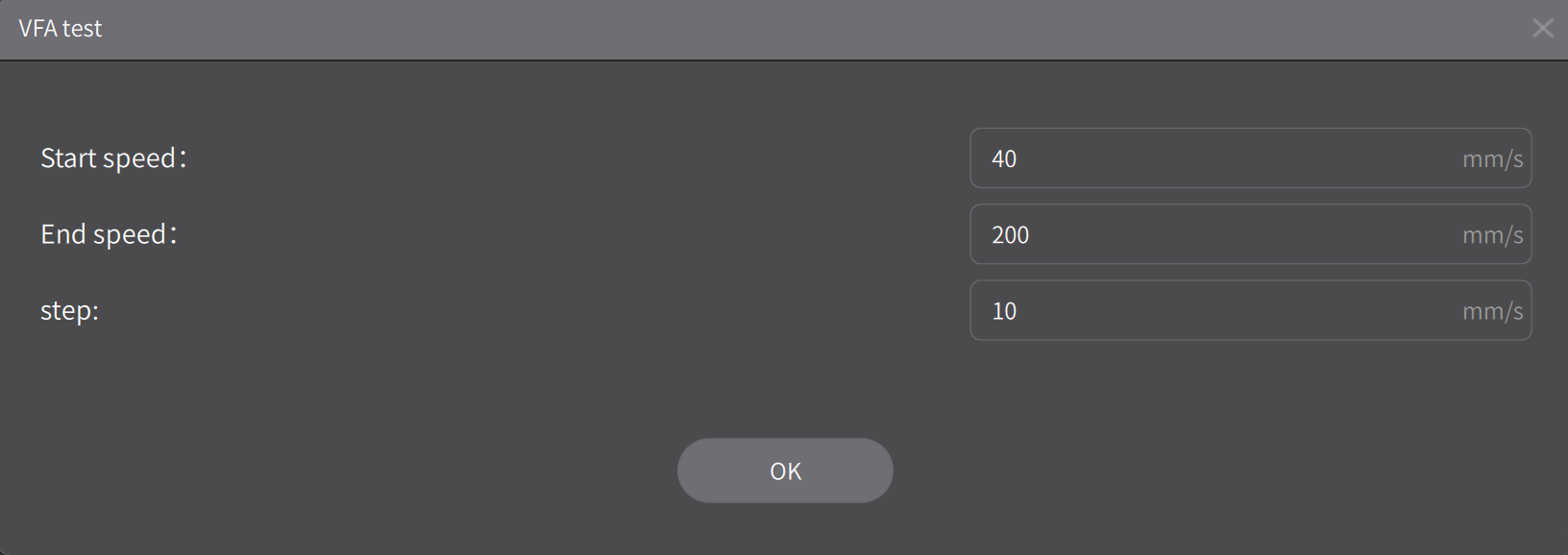

I did the VFA calibration test but i don’t know where to change the value in the settings ?
In the tutorial page, it says “refer to the calibration process of pressure advance and maximum volume flow” but it doesnt say where the setting is.

Yes i know where to find the pressure advance and the maximum volume flow, but i dont know what VFA means. In the tutorial, it says “VFA (Vibration)”, but i can’t find any settings with VFA or vibration in the name.
In the VFA calibration tab, the start, end and step is in mm/s so i’m guessing i will have to change a setting that is in mm/s but i dont know which one.
Had to do a bit of digging VFA is vertical fine artifacts it is to do with printing speed. Something from an Orca blog that might help. Not sure you can do an awful lot apart from trial and error, assuming that you have a standard V3 SE, you can’t do vibration compensation on that you’d need a sonic pad or similar for that.
