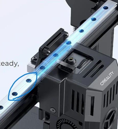

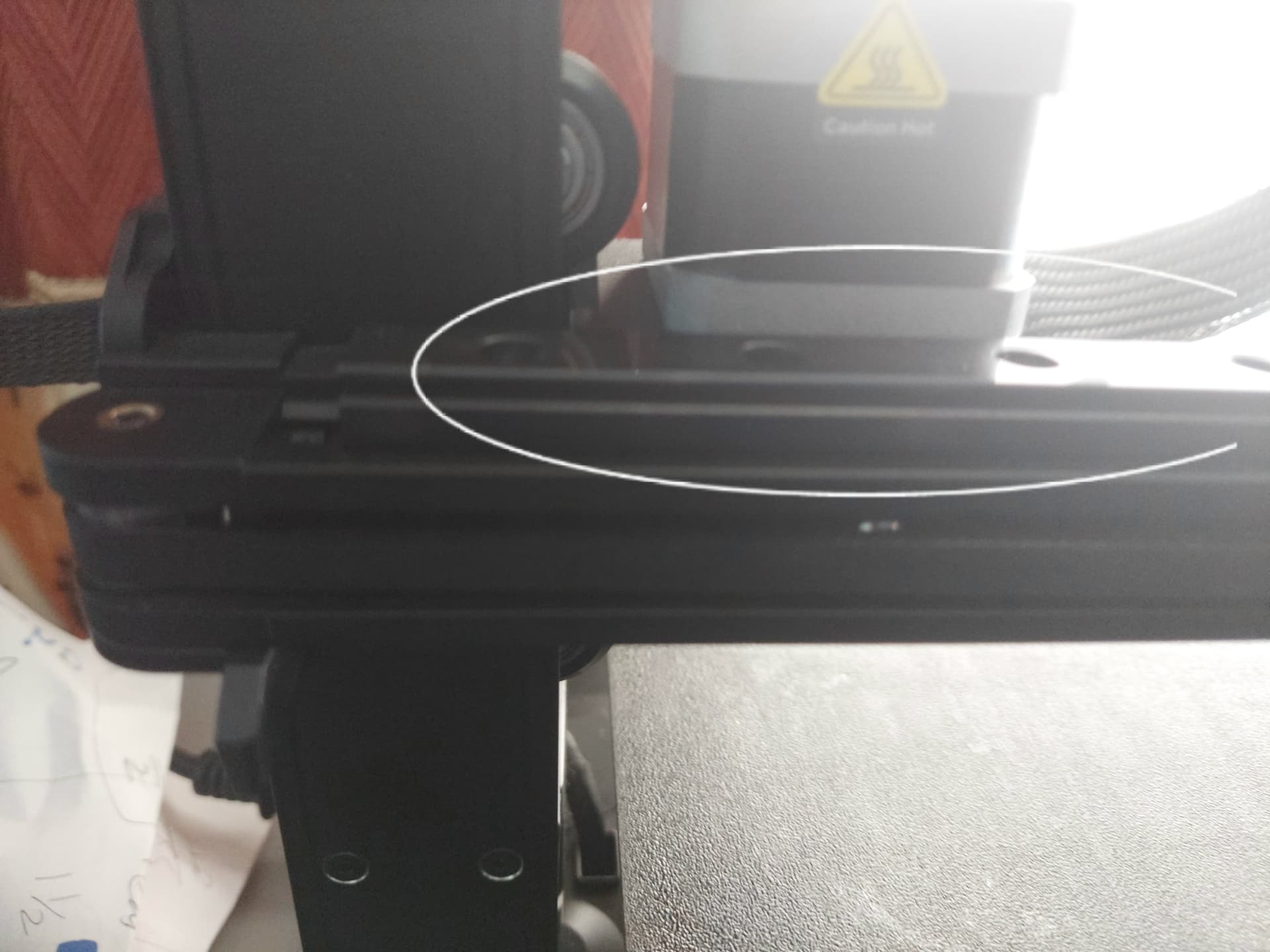

  2. By the groove, do you mean the small circular nail holes at the top, the small rectangular hole to the left side, the actual GROOVE on the rail, or something else? [see the images below to see what I’m referring to]

The groove referred to is the one shown in your 3rd picture.
The black pieces are probably parts of the belt that have rubbed off.
