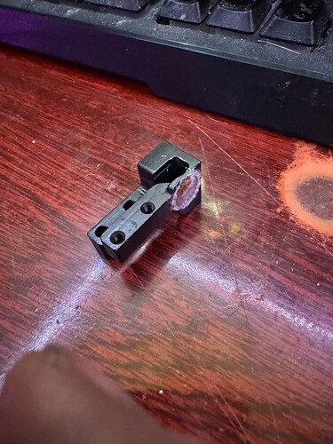

What is the part that plugs in here? I can only find one mention of it searching. Diagram shows is a height alignment sensor. I can not find this part searching for it. The wires broke off. I am considering trying to solder them back on but I would just feel better buying a while new piece
That is the load cell/ strain gauge.
It does the automatic zoffset measurement my pressing the nozzle against the bed. It then reads the load, same as a kitchen weight scale, to determine when it touches.

This part is called the piezoelectric ceramic bu Creality and they have just recently sent me a new one because of issues with my printer
This is ridiculous. I managed to solder the wires and it worked for a bit but now the piece snapped in half after the nozzle dragged on the bed. This piece is also the mount for the hot-end so now my printer is a paper weight. I have emailed CS support, messaged on facebook, whatsapp and called their customer support number (no answer). I am not getting any response out of this company. I have seen so many others with this same defect during my research, how do they not sell this part in the parts mall, more-so when they actually made a video on how to replace it. I will never buy one of their products again and if I could return this one I would.

it looks like in the picture you are still using the original “bracket”. mine is completely snapped in half at the thinnest part so i cant mount the hot-end at all. maybe i am seeing things wrong. right now I have some high temp JB weld and am trying to fix the piece enough to do what you are suggesting with the manual z offset setting.
To make sure the printer does not do an automatic zoffset while the load cell itself or it’s wires is missing, comment out the [prtouch_v2] and [z_compensate] sections in printer.cfg.
Then you can make the temporary bracket a solid piece.

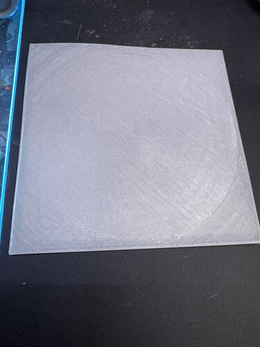

Well I got the bracket fixed. It’s not breaking again. Lol. I got mainsail installed and edited my printer.cfg. Manually set the z-offset and I got a good basic print. Now to try something more complicated.

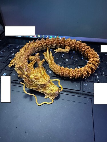

I would say its working pretty well now, no thanks to @CREALITY . Just printed this the other night. came out great
Thanks for the help and advise @henrivdr
