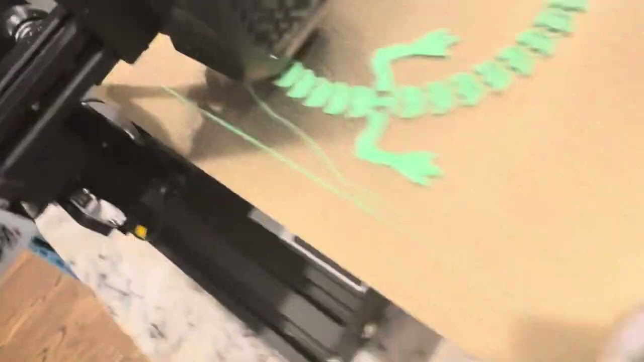

Finally got around to trying a Creality filament, but no success. Same basic outcome - after about an hour, filament stops feeding through the pipes. Waking up this morning it is completely severed in the extruder. I think maybe a dual gear extruder would be smart? This is very frustrating, heck of a lot of work and trials without a single successful print to show for it for months now.

Just looked back into it again today and discovered that the extruder gear was not firmly attached to the vertical pole, with those tiny screws that hold it tight. So it was spinning, but the gear was not turning. How long had that been the case? Seems unlikely that it was ever the case until last night when it failed, since it’s not as if that would ever not be a problem. So I fixed it, much tighter, and ran it again. So far so good, an hour into a run, it still is working like a charm. We will see how long that holds…

Another fail I’m afraid. Same basic amount of output beforehand. Video of my setup below: Thanks for your attention.
Looks like it has chewed up in the extruder, maybe the gears are too tight and chewing through the filament? Smaller retraction distance might help too.
What throws me off is why does it always seem to work fine for 60-90-120 minutes before chewing up the filament. But i’m willing to loosen. How do I do that? I don’t see any obvious screw that seems like it would be the smoking gun. Can you point me to a youtube video showing it, or some good picture steps? Thanks!

Thanks - that video gave me some good background info but the part about the Ender3 extruder was very quick - seemed to say that removing the tension adjuster screw to reduce the tension furthest was the best outcome he had. I can try it!
Edit: So actually, removing the screw that they describe will only increase the tension, not reduce it.
Made a couple of easier things with the tension increased. Now trying my white whale, the articulated dragon, which I made successfully once, the first time, but never since. Turned down the speed to 75%. Fingers crossed. Leaving town, won’t know the result until Monday.
Sounds like your hotend is failing. Check the temp with an infrared temp tool. Mine is doing the same thing.
