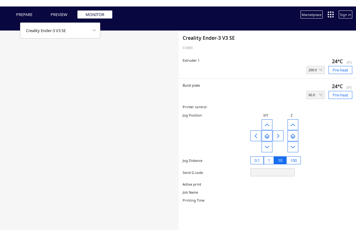

I am trying to connect my Ender 3 V3 se to my PC.
but- windows doesn’t recognize it. Where do I get a driver?

This works for me in Cura:
CH341_driver

I would recommend ensuring your slicer is up to date and you could also try using the CH341 driver that has serial support which you may find works for the V3 SE to PC connection.
CH341SER
Creality Ender 3 v3 SE do NOT work with Creality Print slicer by USB but Creality Ender 3 v3 SE DO certainly work with Ultimaker Cura!

I can confirm that after installing CH341 Driver, Ultimate Cura started seeing my printer, magic.
Thats what i did:
  1. Plugged Type-C - USB from printer to my pc usb port
  2. Installed CH341 Driver just by pressing button there in the window
  3. Checked in Creality Print and Cura
    PS: Creality Print still doesnt see my printer, but Cure does xD
    Now i can controll my printer with my pc, finally!
